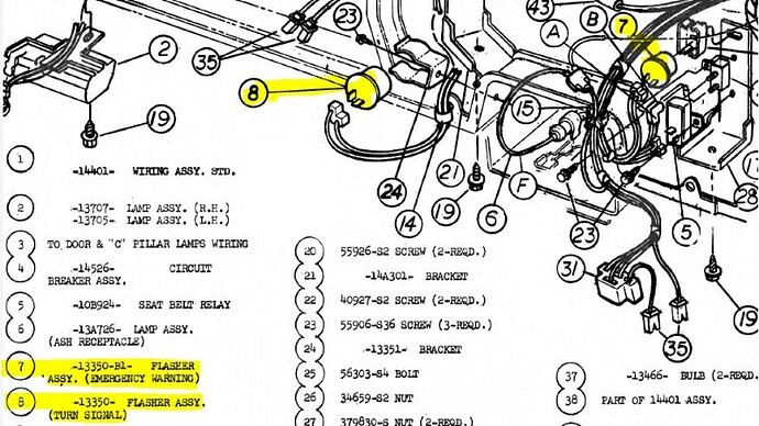

The Emergency Flasher Relay is located on the driver’s side of the radio:
The Turn Signal Flasher Relay is located on the passenger side of the radio:

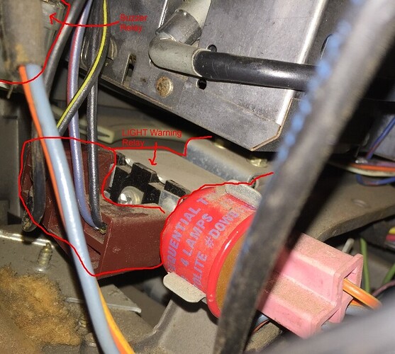

Here is a pic of the Turn Signal Flasher in place (red flasher can). You can access it behind the glove box.
I don’t have a picture of the Emergency Flasher in place, but if you crawl under the dash upside down and look up, you should see it in there (see schematic pic in my previous post).
Excellent photos and descriptions, Mike B.
Thanks very much Mike. This is very helpful. I’m replacing the turn signal flasher. I suppose the best thing to do is remove the glove box. Thanks again.
