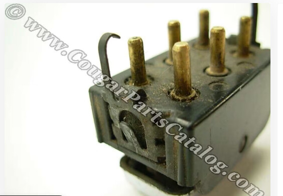

There are two small spring clips top and bottom of the switch that have to be pried open to release the harness plug. Be careful - they are fragile. Doesn’t take much force to release them, but they are hard to see and get to with the door panel on.
Speaker has a separate plug inside the door.
I couldn’t find an image of the larger plug harness / connector used in the master control for power windows, WITH the little clips that secure the plug connectors to the bank of power window switches / bezel, but here’s an image of a single switch with that clip.

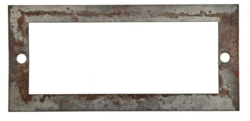

Don’t forget that this bracket:
will also have to be removed, in order to separate the bezel ( + switches, connectors and clips ) from the back of the door panel itself. This will make it a lot easier to pull the wiring a bit further through the square hole in the door panel, to carefully ‘retract’ the tangs of the clip ends and remove the connectors from the bank of switches.
