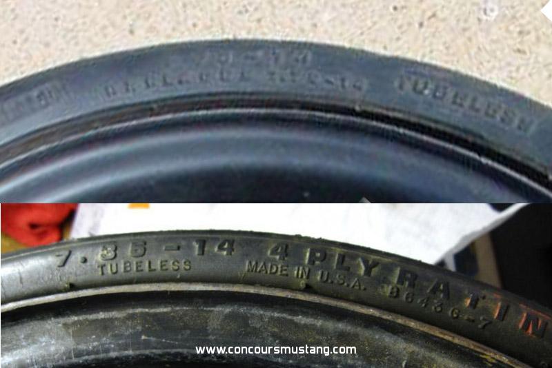

OK thank you for the information, It looks to me like it is likely a 1969. There is a marking on the wheel under the blue oval that says 9ML,the M is larger than the 9 and the L. The tire itself says F78-14 and REPLACES 7.75-14. My bottle says TIRE INFLATOR 7.35-14 and has a C9WA-19F514-A.

A F78-14 was used 70 and later I think, if original it would be a 7.35-14.

Two pictures of the size lettering from the sidewall. The top is what you have - the bottom what an early one would have
Sorry for the poss resolution of the first but was what I had handy
