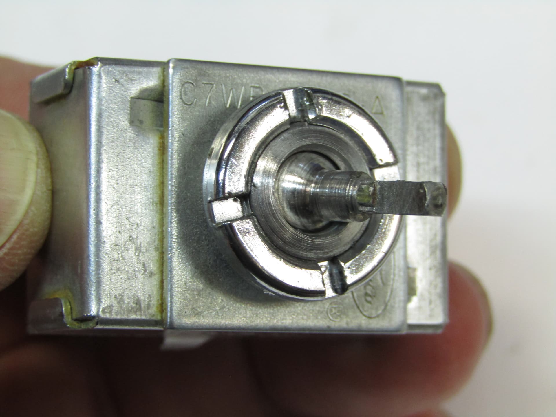

How to rebuild the A/C-heater fan switch
Due to the huge increase in prices for repop parts I thought this will help save a few $ for someone!

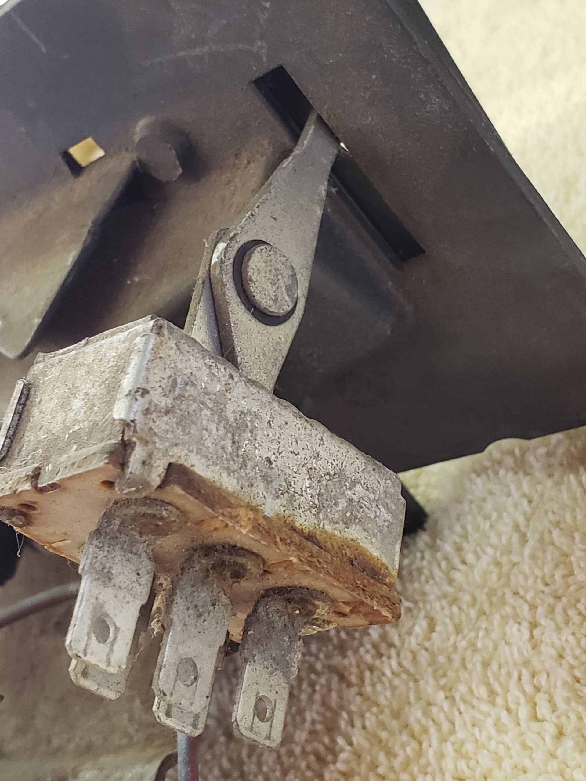

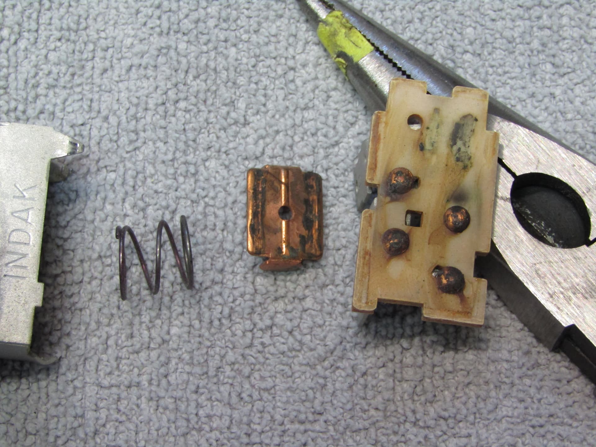

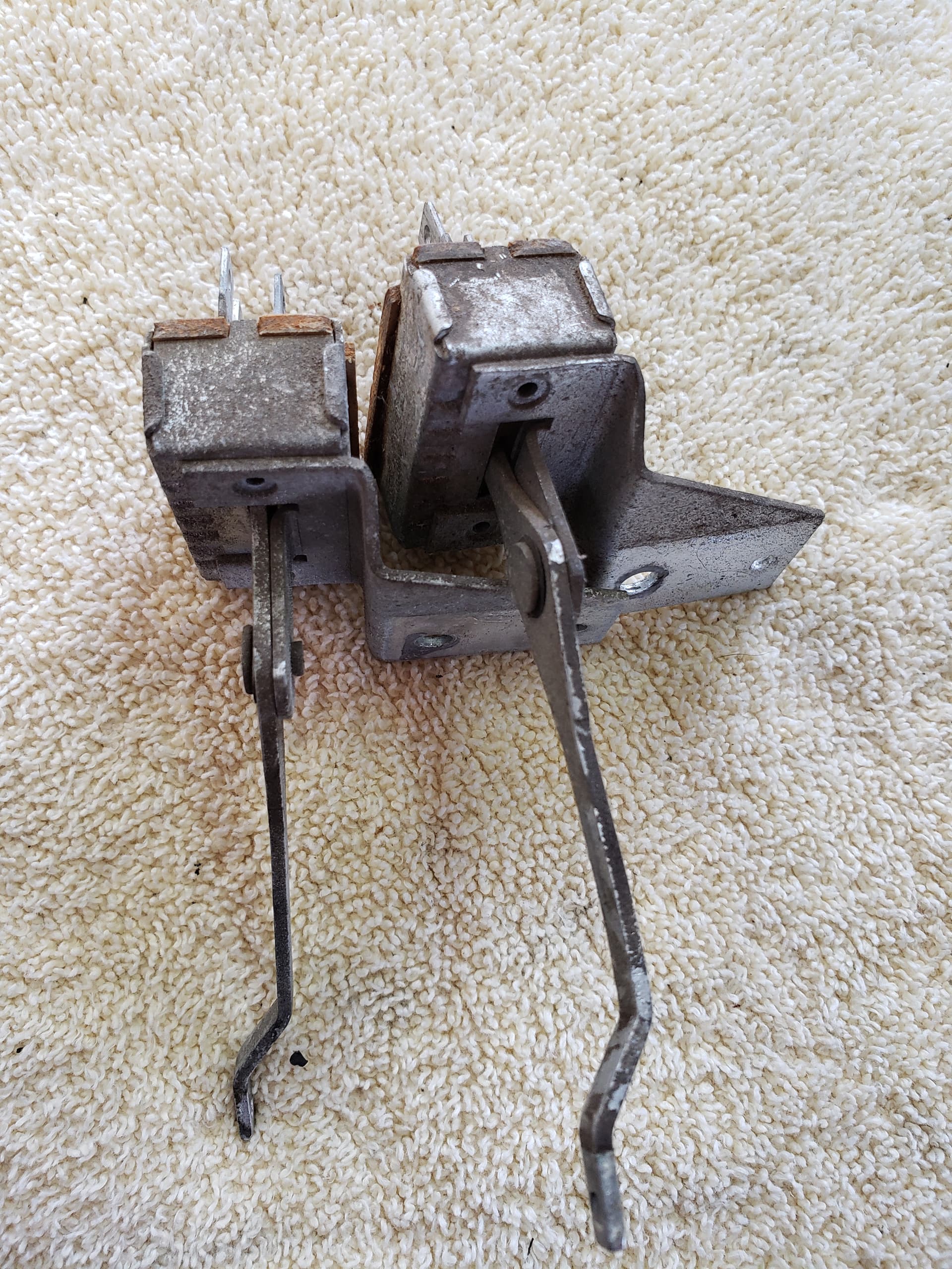

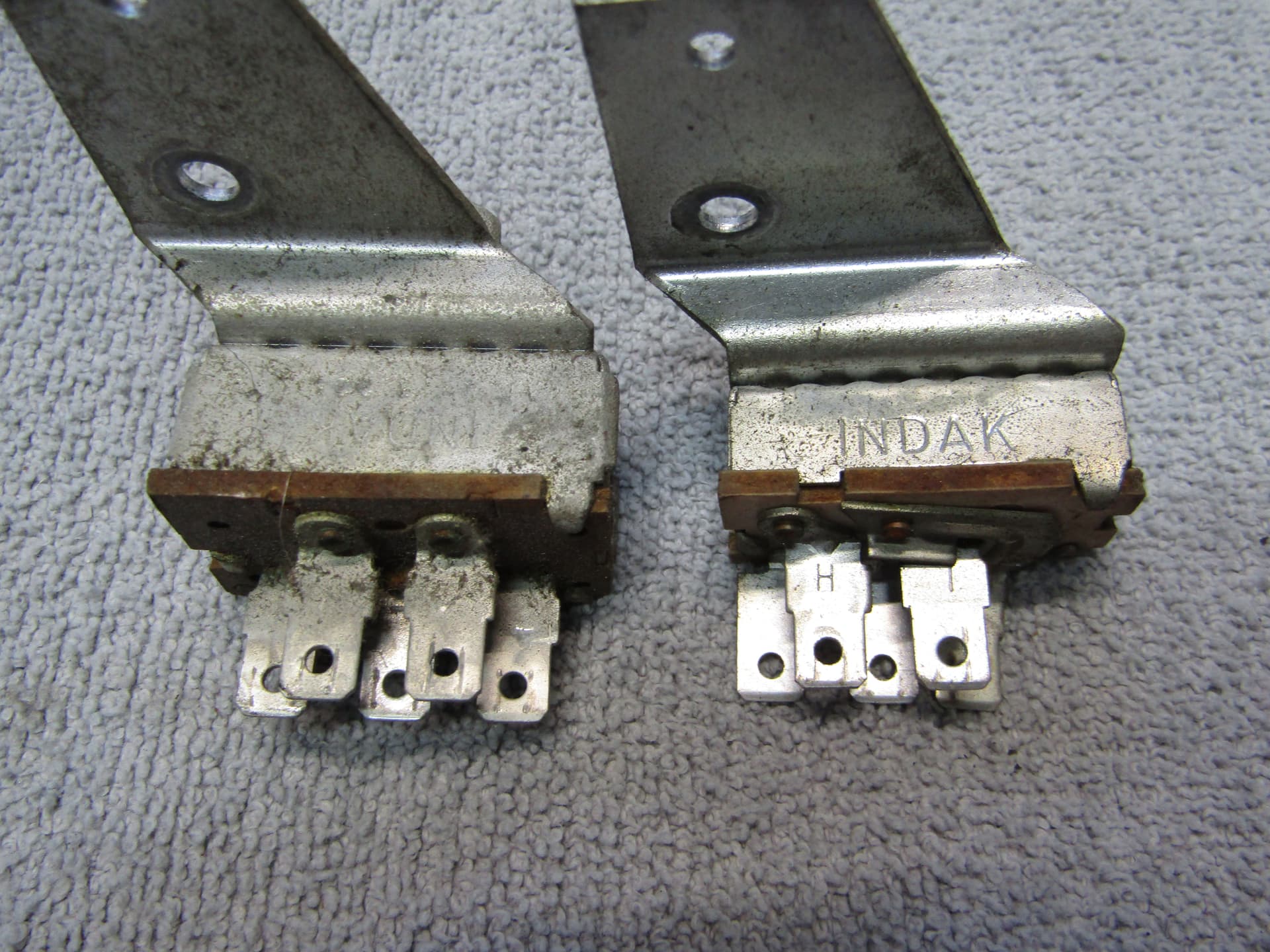

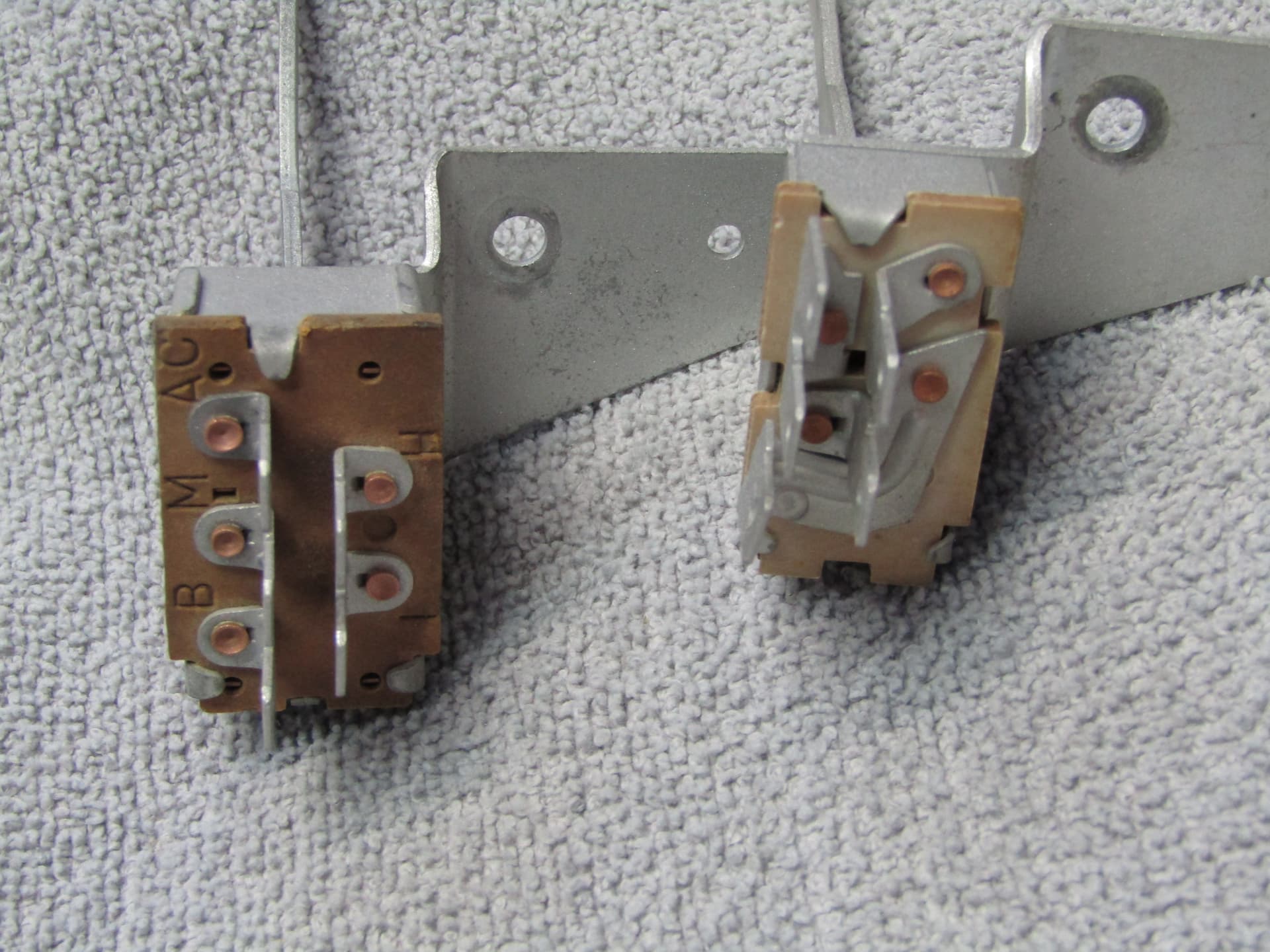

A/C (left) & Heater only (non A/C) Right

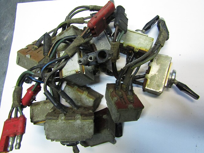

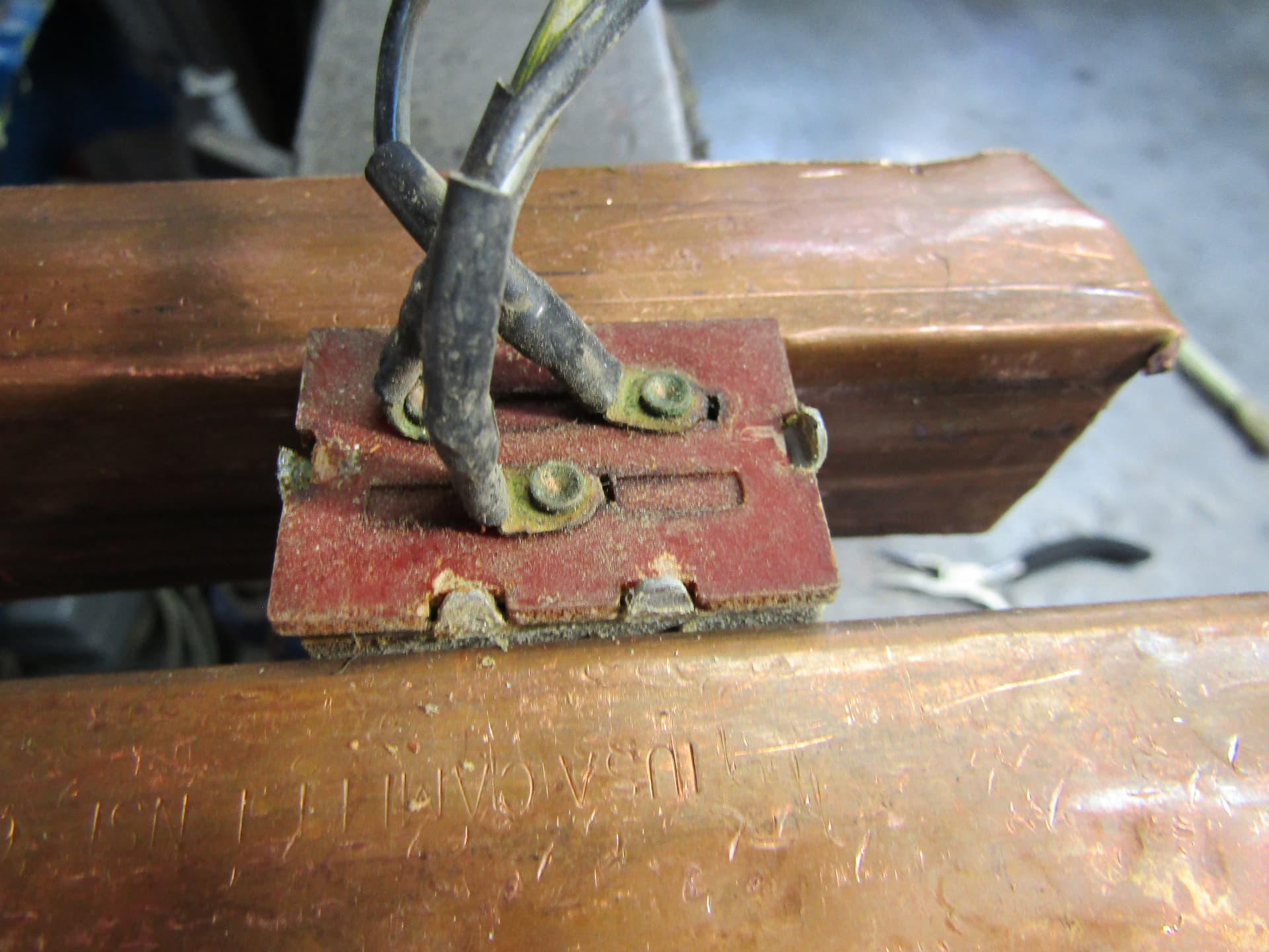

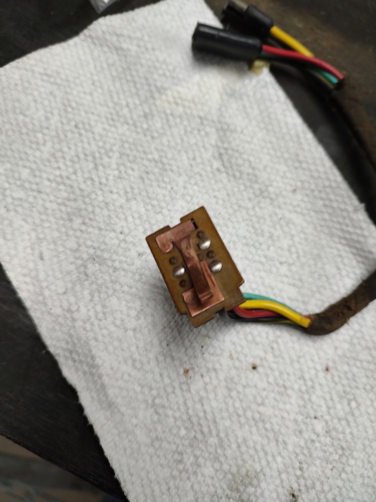

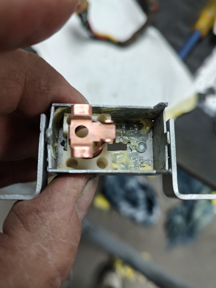

Here’s 2 from A/C units. I blast them with low press glass bead (Ballotini). You can see some in the pics.

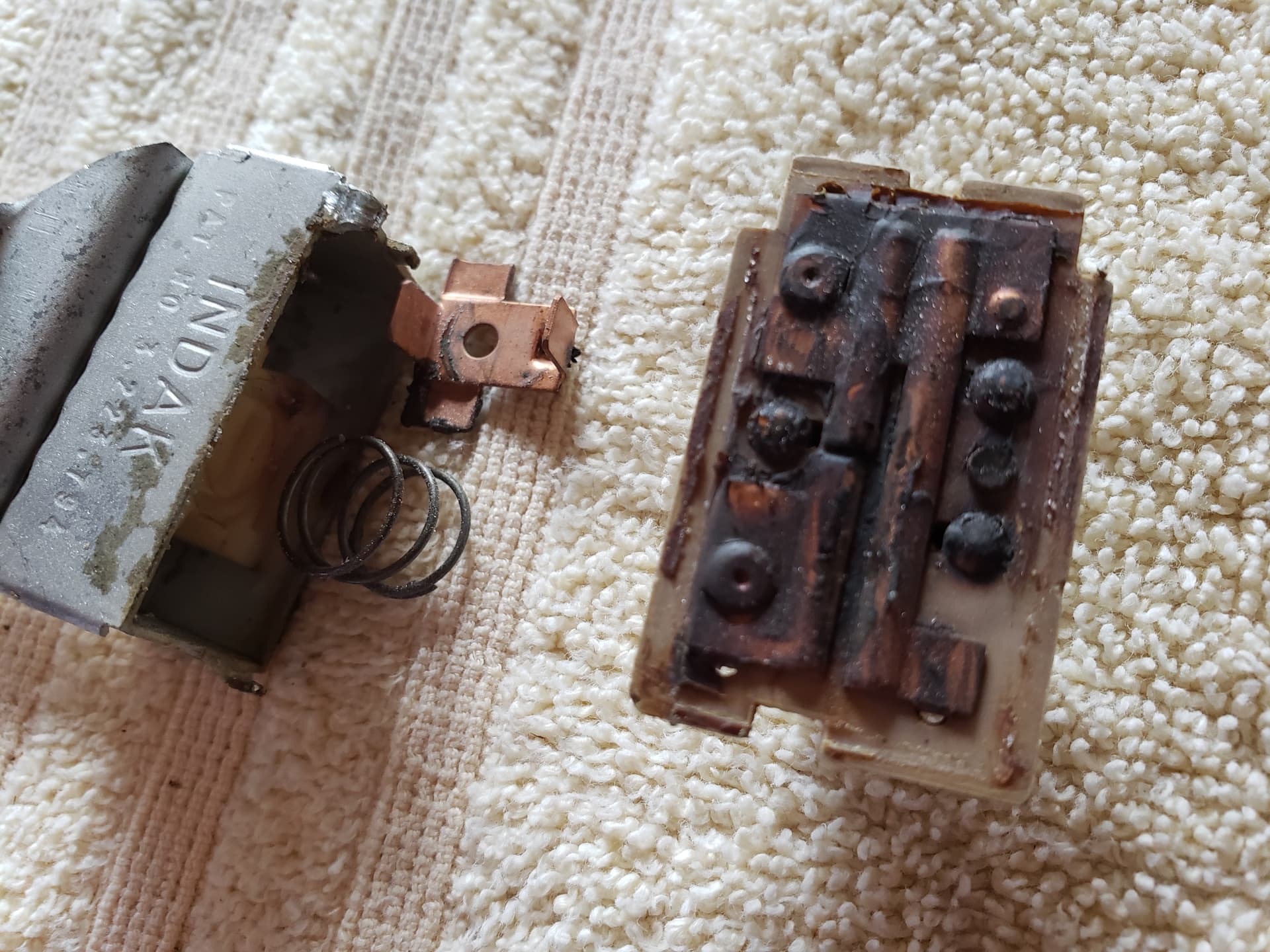

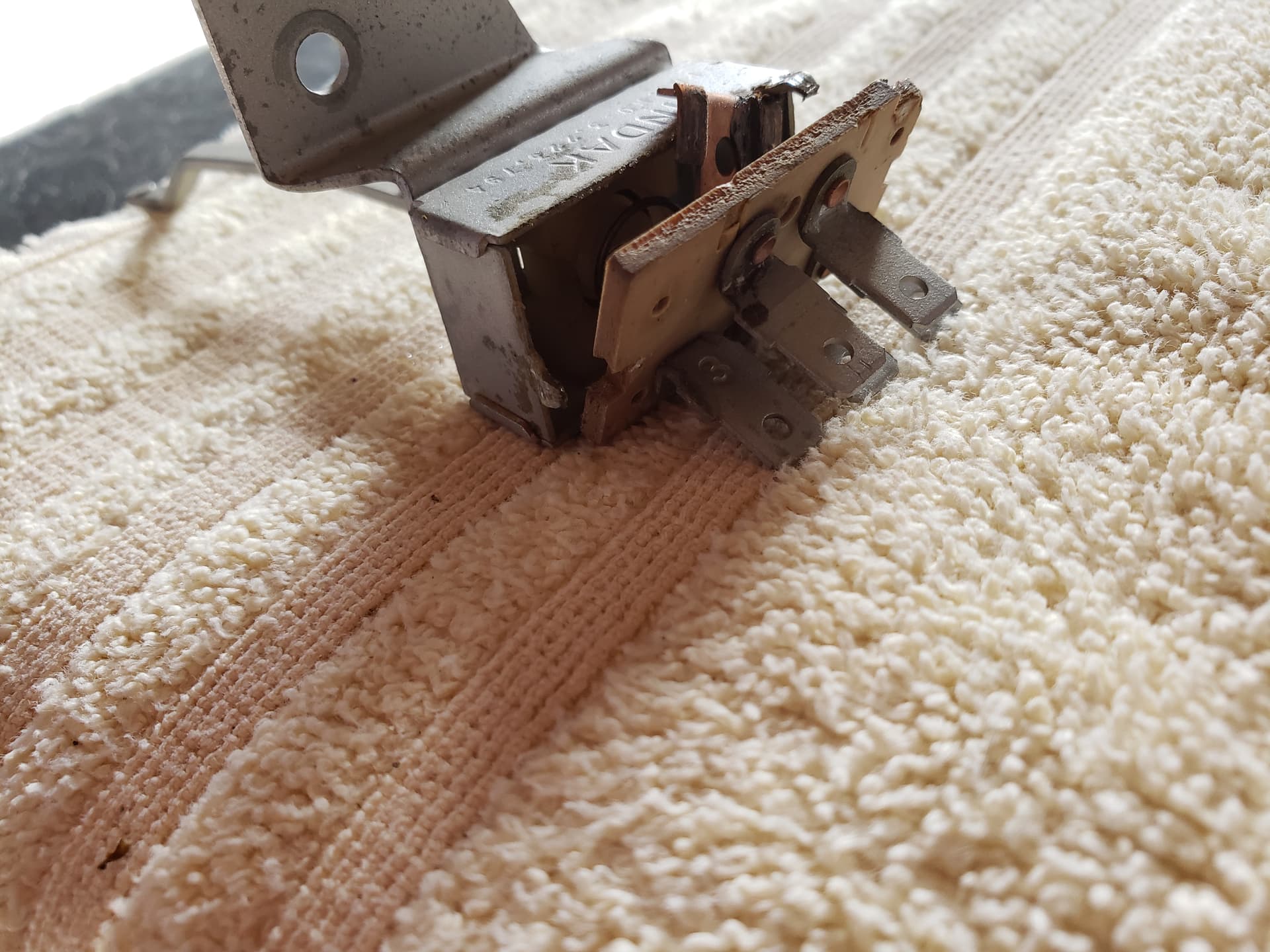

Heater- Non A/C

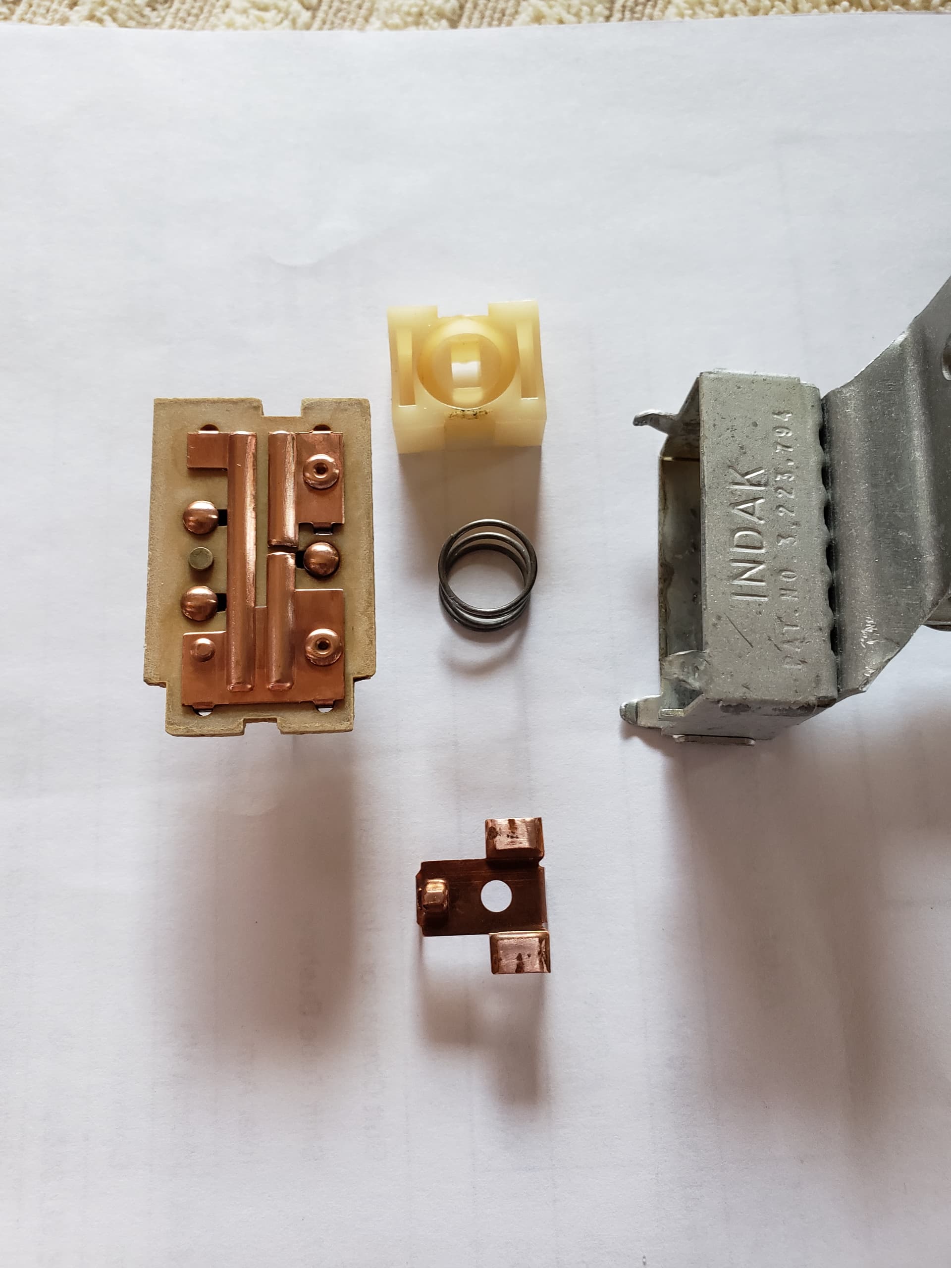

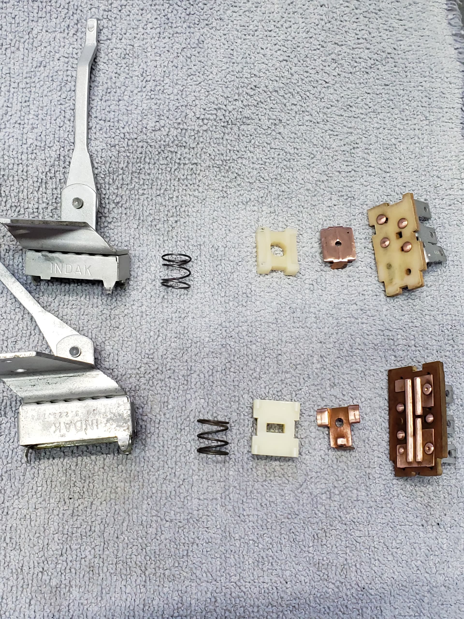

Clean all parts. I used spray brake cleaner. Then fine steel wool on the copper/brass parts. Lubed them up ( I used Dielectric grease, but others can work) & reassembled. Just saved over $50, Other dash switches can be done the same way. Drop of oil on the arm pivot pin too.

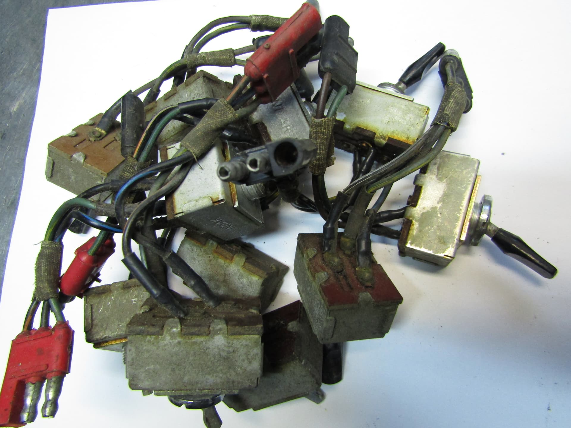

Did mine last month along with my toggles. Time well spent.
Yep, have them in line
I hate to tell you that you just sowed the seeds for the next failure. Use bronze wool instead. It doesn’t embed steel into the soft copper/brass which will form an intermetallic corrosion.
