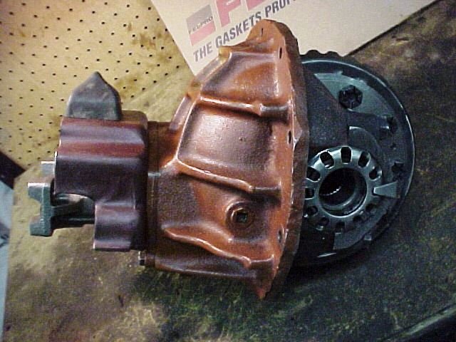

So how many have been cutting down differentials? Here’s a picture of a differential - how would that work exactly?
I was refereing to cutting an inch off the outer ends of the axle tubes .
You are correct Royce. The differential does not get cut down, the axle housing does. Bluestuff just used the wrong terminology when he said differential.
