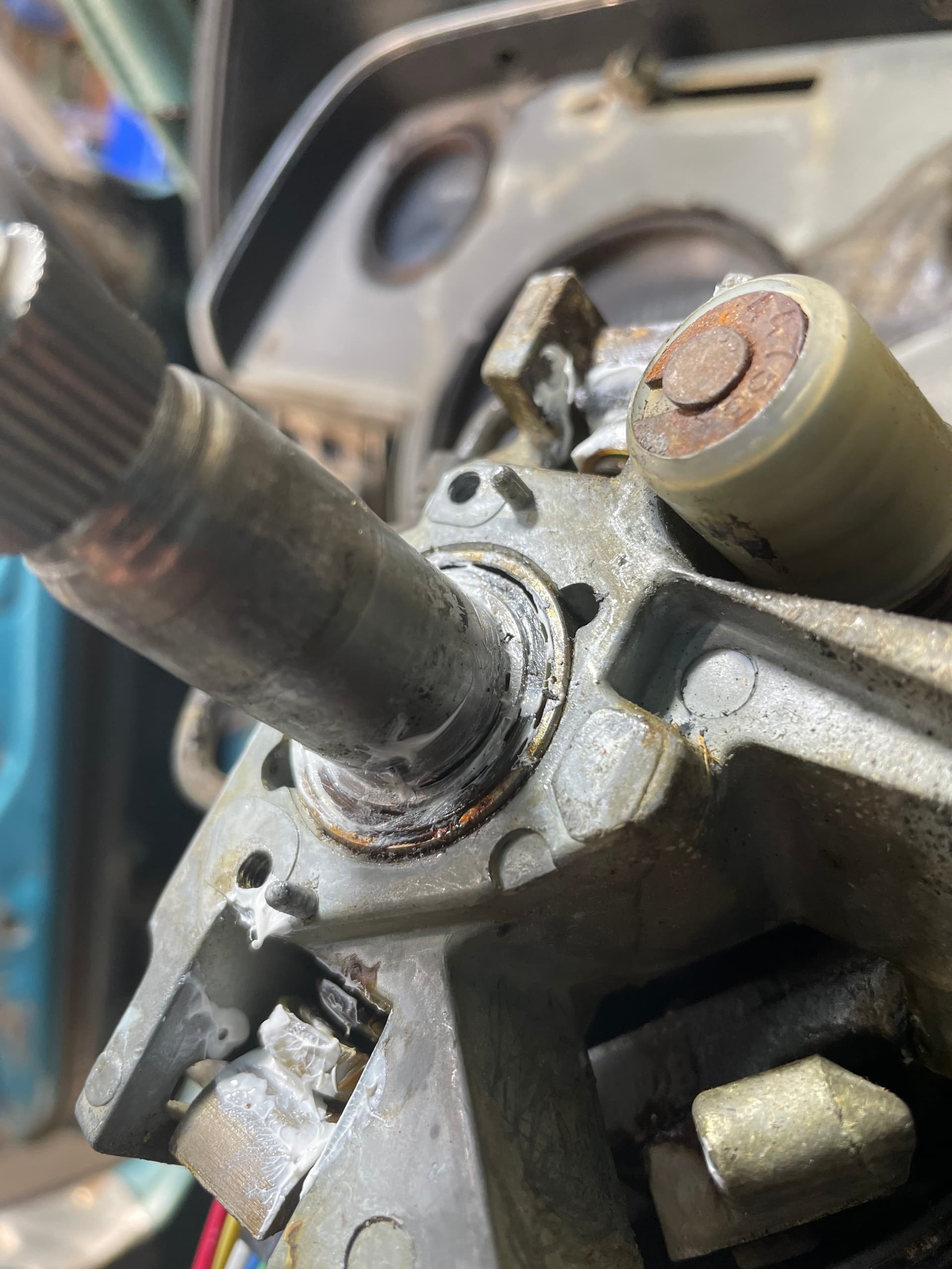

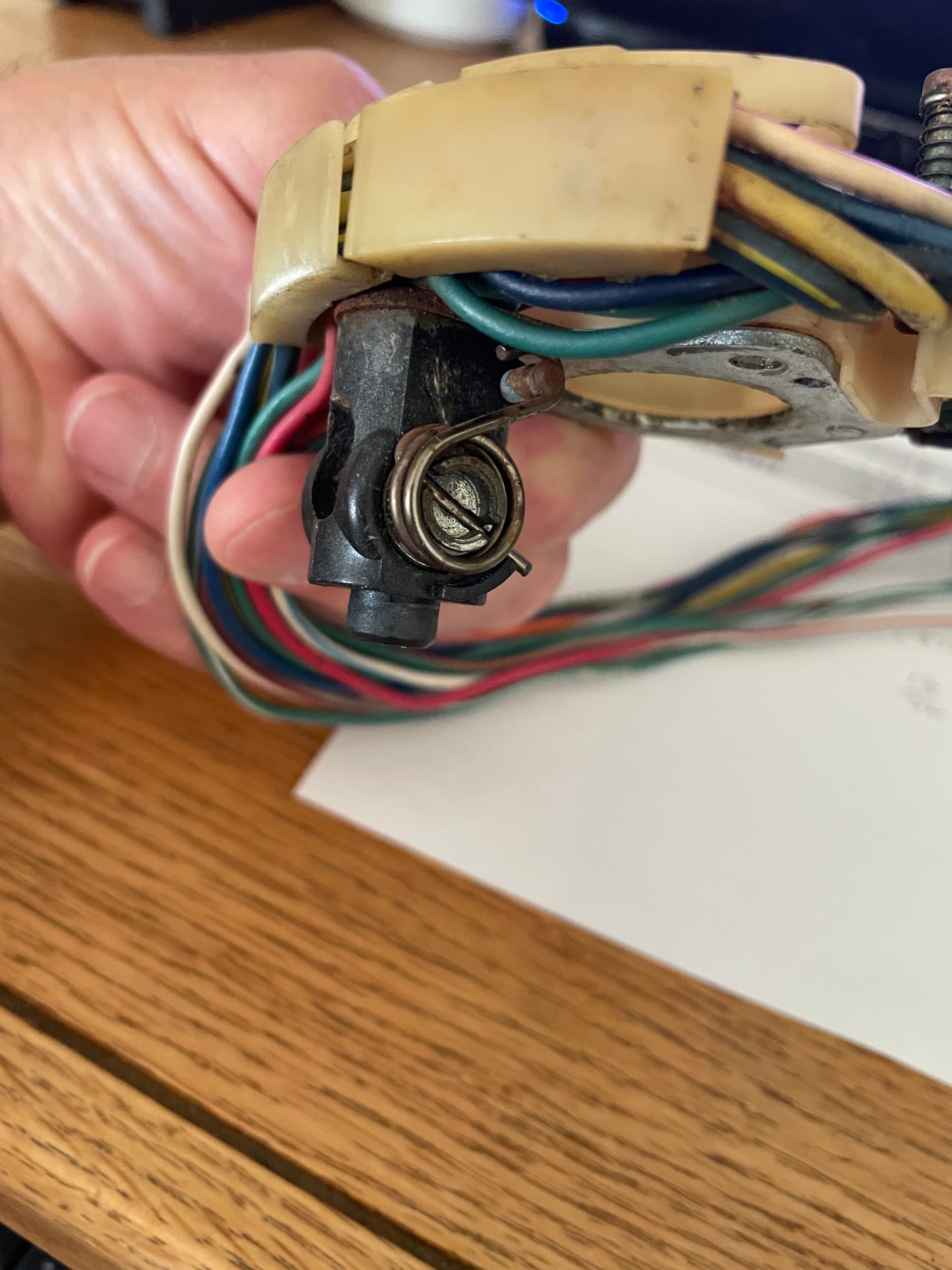

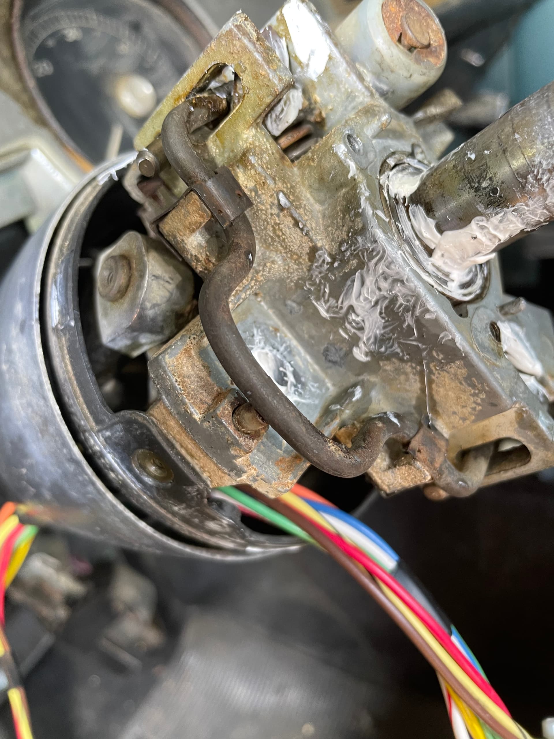

So I’m replacing the turn signal switch, on a project that has not been on the road in almost 30 years. I ordered a fixed column switch, and of course it doesn’t fit due to the guide pins on the upper knuckle.
So I’m scratching my head. But there were other clues. I had to lower the bracket that holds the Vacuum release valve, and tilt way actuator, so I could disconnect the molded switch connector. I had also noticed what turned out to be the column tilt cover plate.
Still it wasn’t making any sense as I didn’t know what I was looking at. My Marti report did not indicate a tilt wheel.

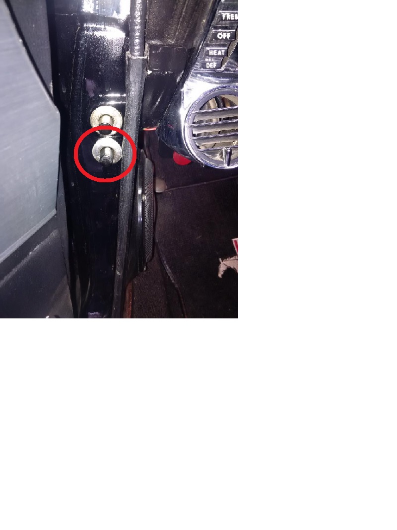

Would my Tilt Wheel, also be Tilt-Away?
If the straight column was switched out for a tilt, it was a tilt away. Is there a second button in the driver’s side door jamb?
I’ll have to check, but I believe there is a second button.
This is what you’re looking for :
