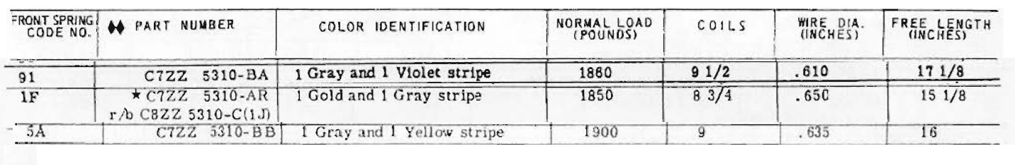

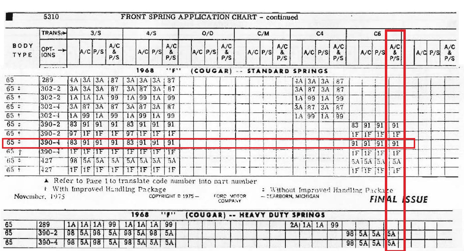

I could not identify any of the original markings as they were either way too rust stained or just not much left to begin with. Since I don’t have the build sheet, my next option is the MPC. Since the car has 390-4, C6, AC & P/S, this would be spring code 91. Unless there is something special I missed on what the Hertz-G’s came with:
It’s funny that the MPC doesn’t list the 428.
My Marti report doesn’t mention anything that leads me to believe my car has “Improved Handling”, but when I measure the springs they are 18-3/4 coils, 0.640” dia & 5-3/4 tall, so not code 91 in the MPC. They are closest to being code 1F as far as # of coils, but they are tall enough to be 5A.

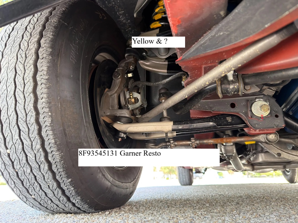

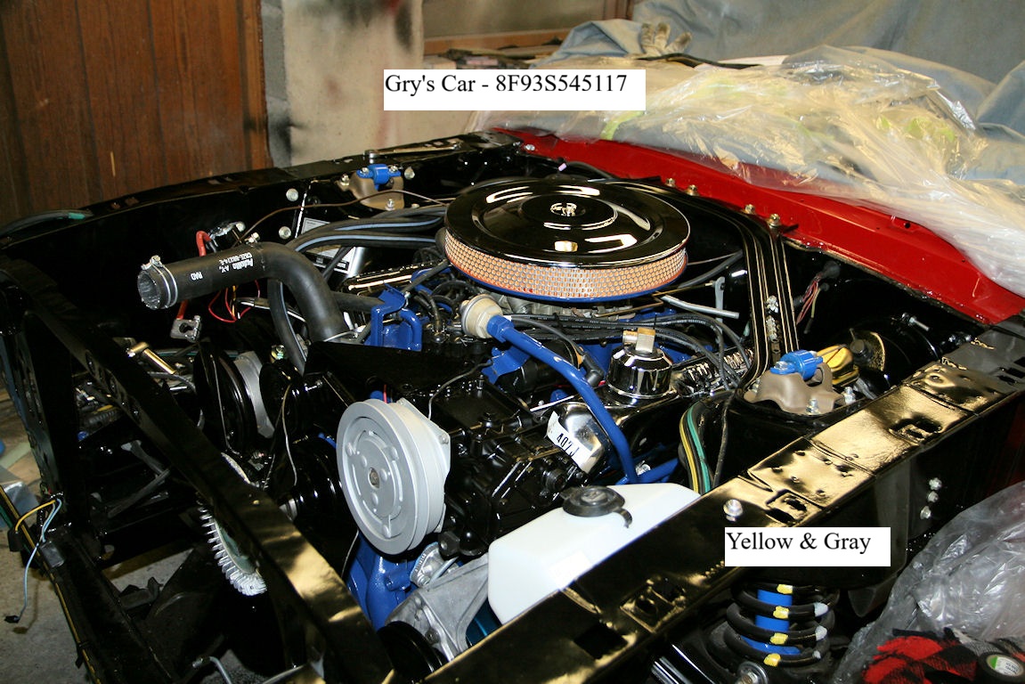

Buuut, I have two examples of Hertz-G car that lead me to believe that my car came with Heavy Duty Suspension, because they have Yellow & Gray markings.

It’s funny that people are choosing Yellow & Gray for their Hert-z G’s. I have 3 examples of that. Doesn’t mean they are correct though.
Perhaps some are looking at a faded or lightly applied gold and thinking that it was originally yellow.
The gold is very close to a yellow so it is easy to misunderstand.

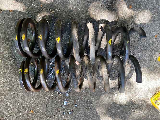

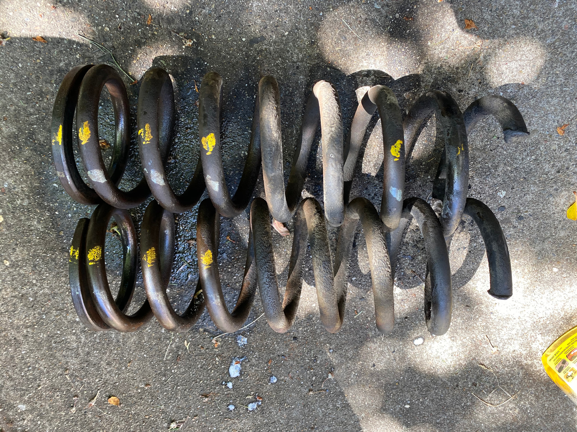

Here is what the gray/gold colors looked like on the original springs from my 68 GT. I replaced them because they had been cut down.
