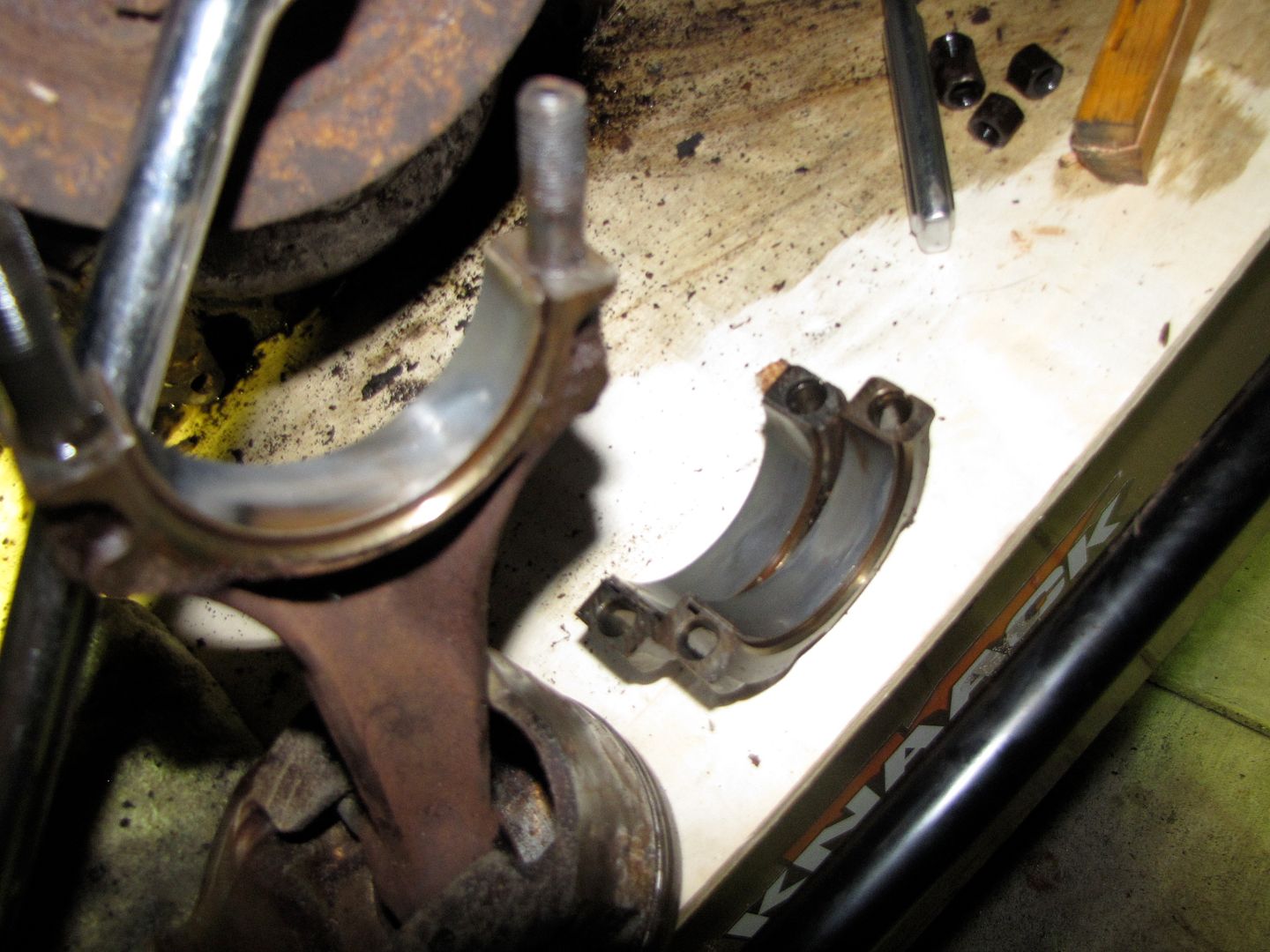

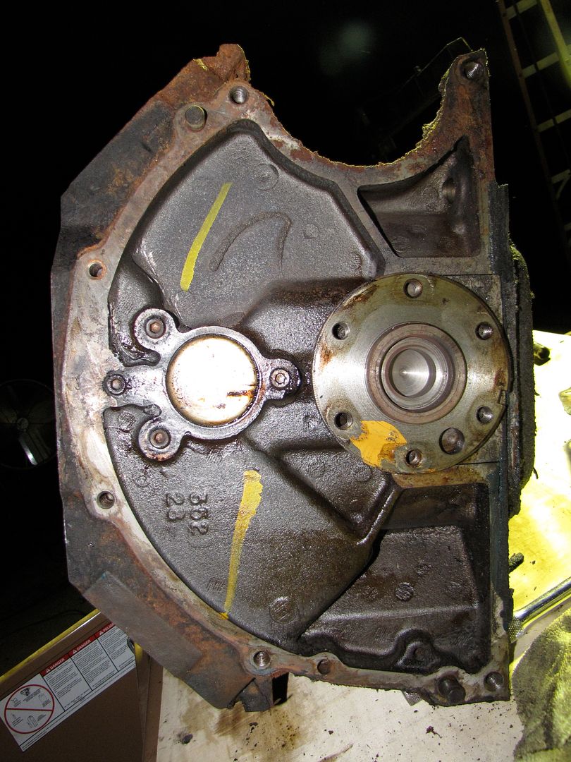

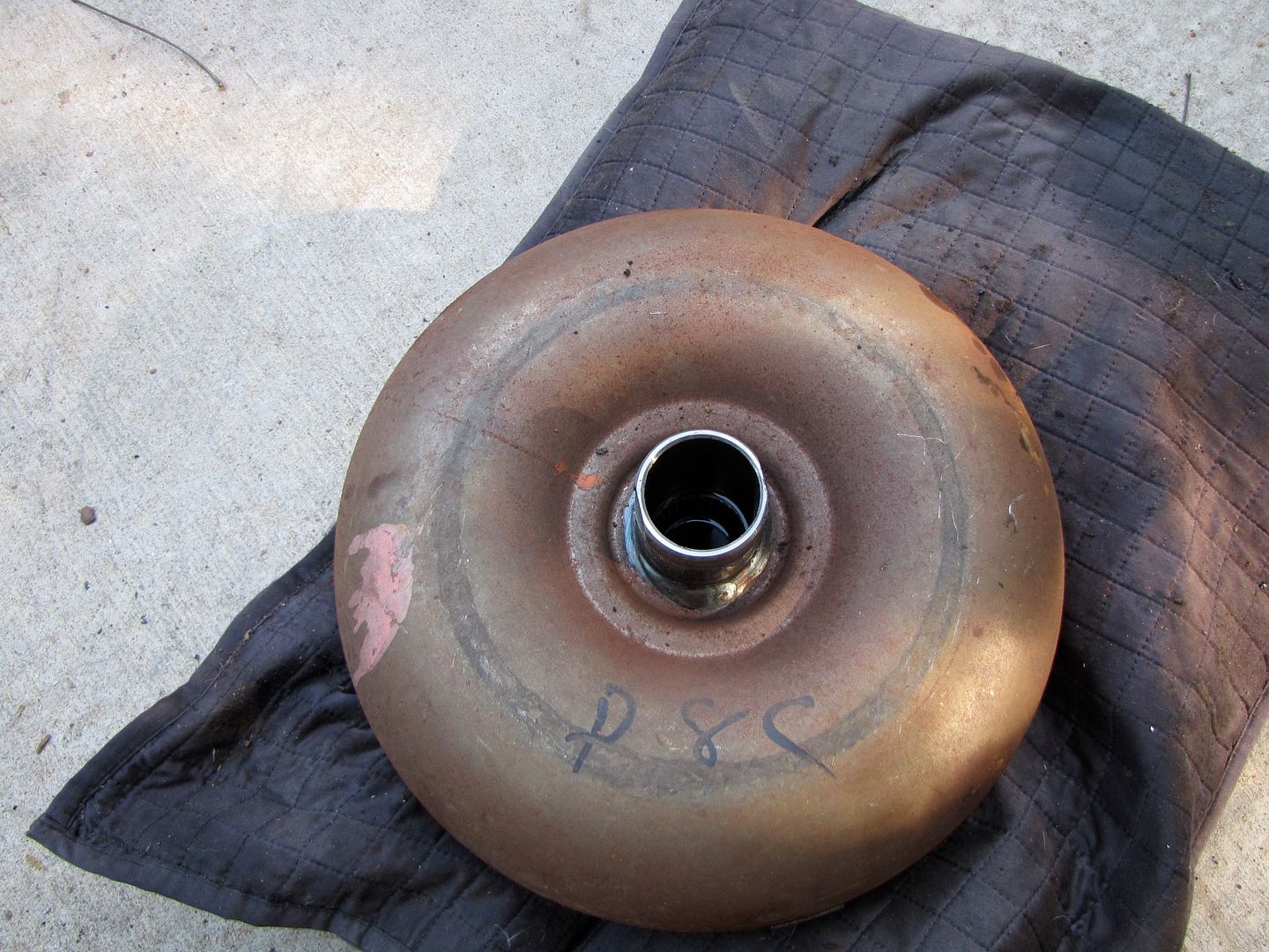

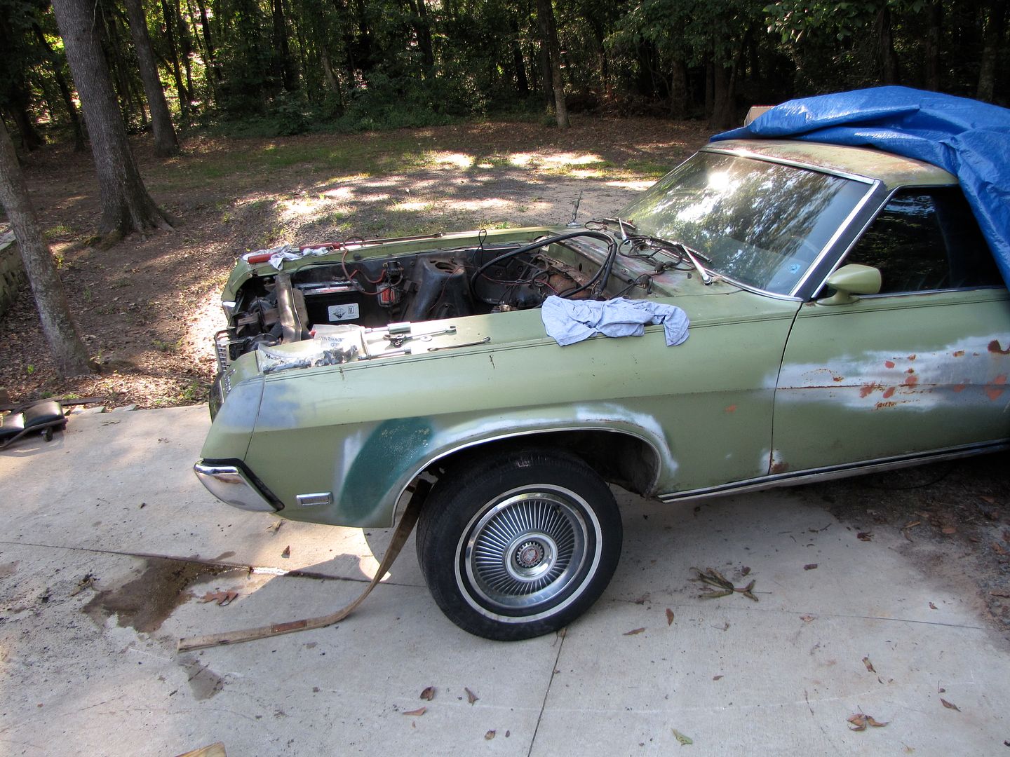

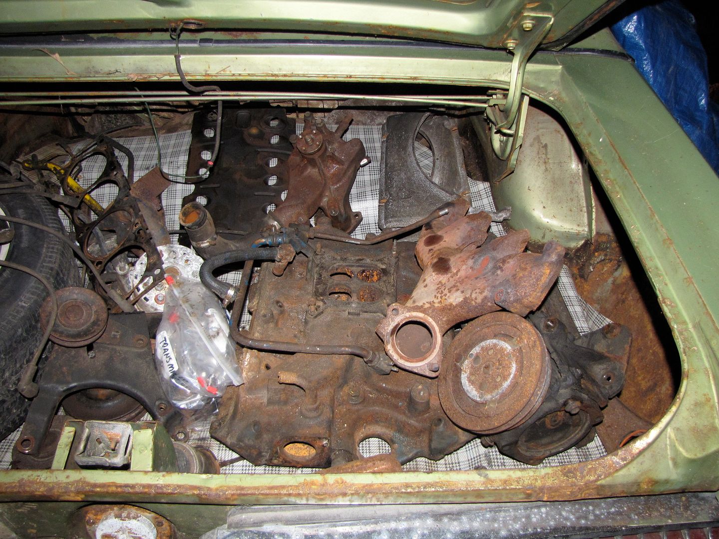

Currently I have removed the engine and am in the process of disassembly. As I thought the engine is standard bore with no lip and very little wear on the rod bearings. Part numbers on the head gaskets and paint marks on the block and crank etc.

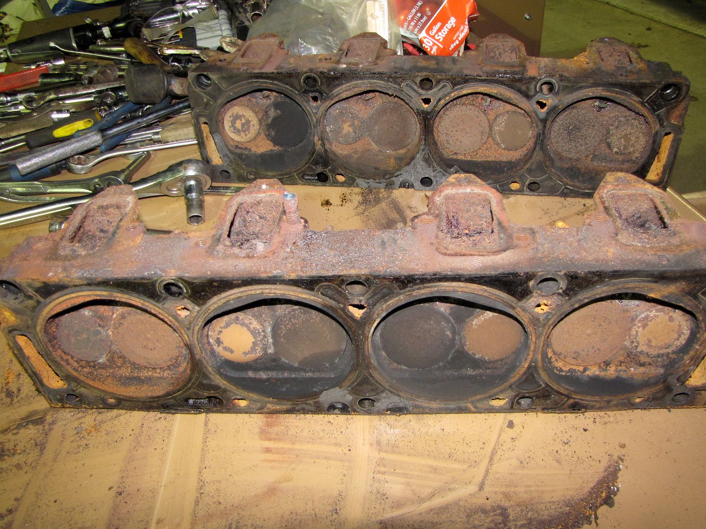

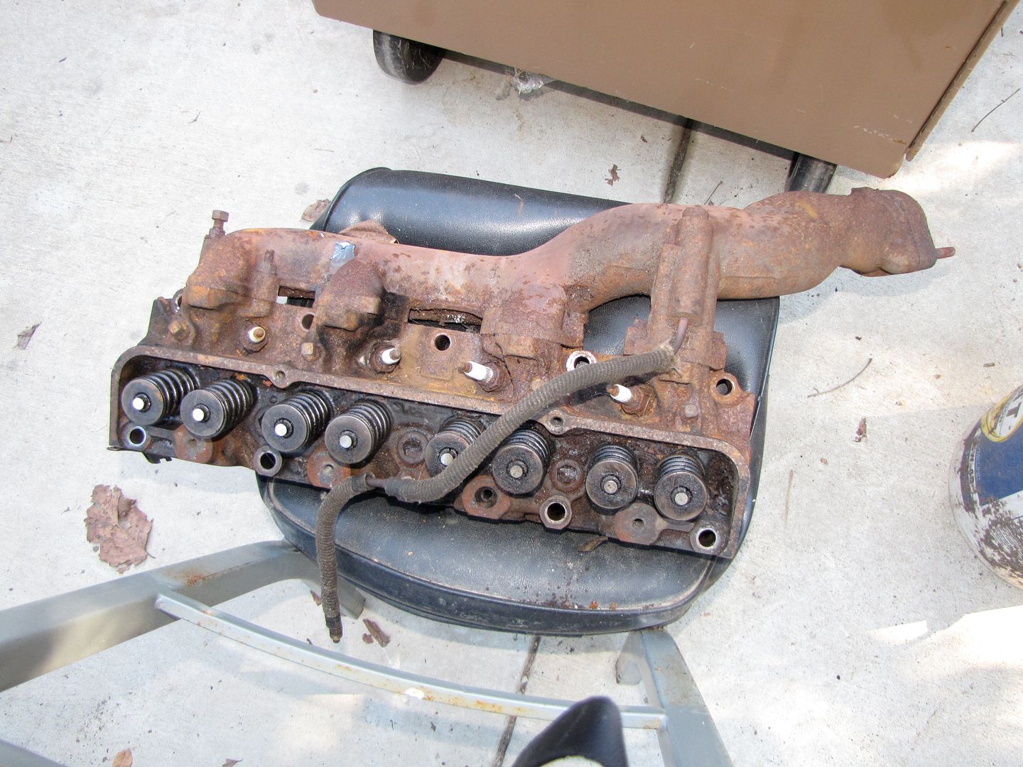

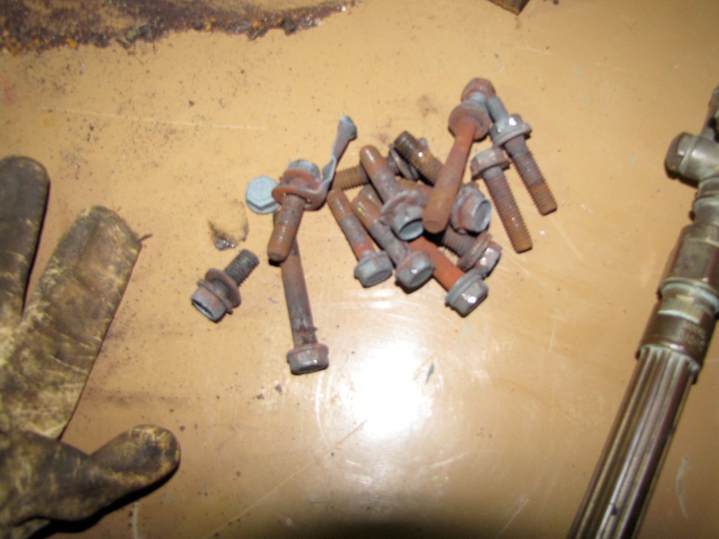

I managed to get the passenger head off with the manifold attached. I had a lot more trouble with the drivers side and ended up pulling the engine which needed to be done anyway. The exhaust bolts were frozen and needed heat to break them loose.

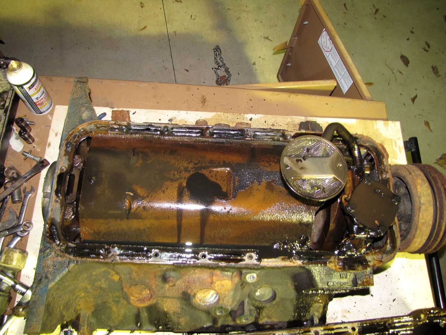

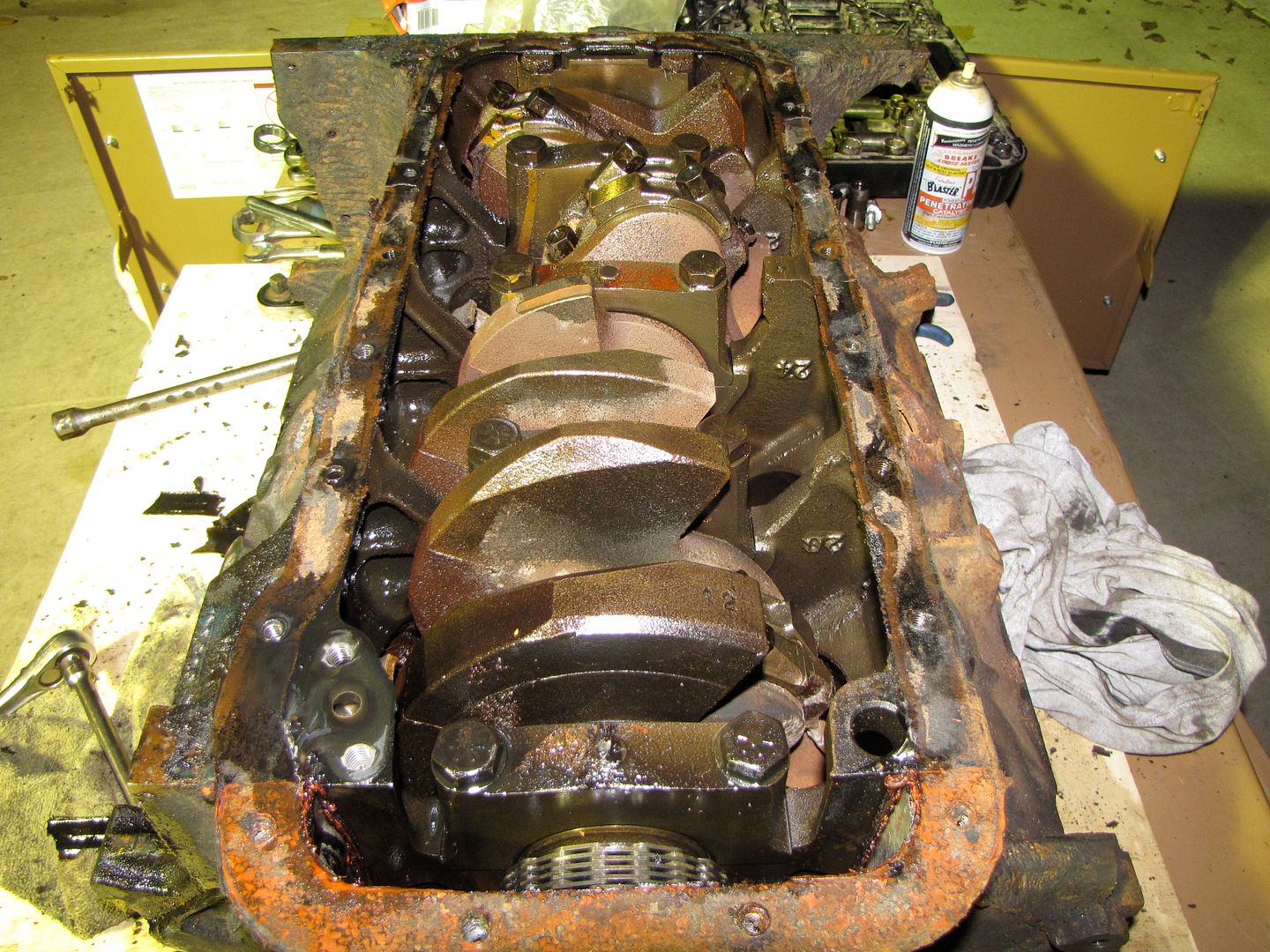

There is no visible damage to the engine anywhere with the exception of some rust in the cylinders and various other places. The timing chain was replaced but I don’t think they ever got it to fire up. Looks like the crank turned about a half turn and everthing froze at that point. There was clean oil in the engine and dirty oil in the filter.
I found most of the plastic teeth from the original timing gear in the oil pan.

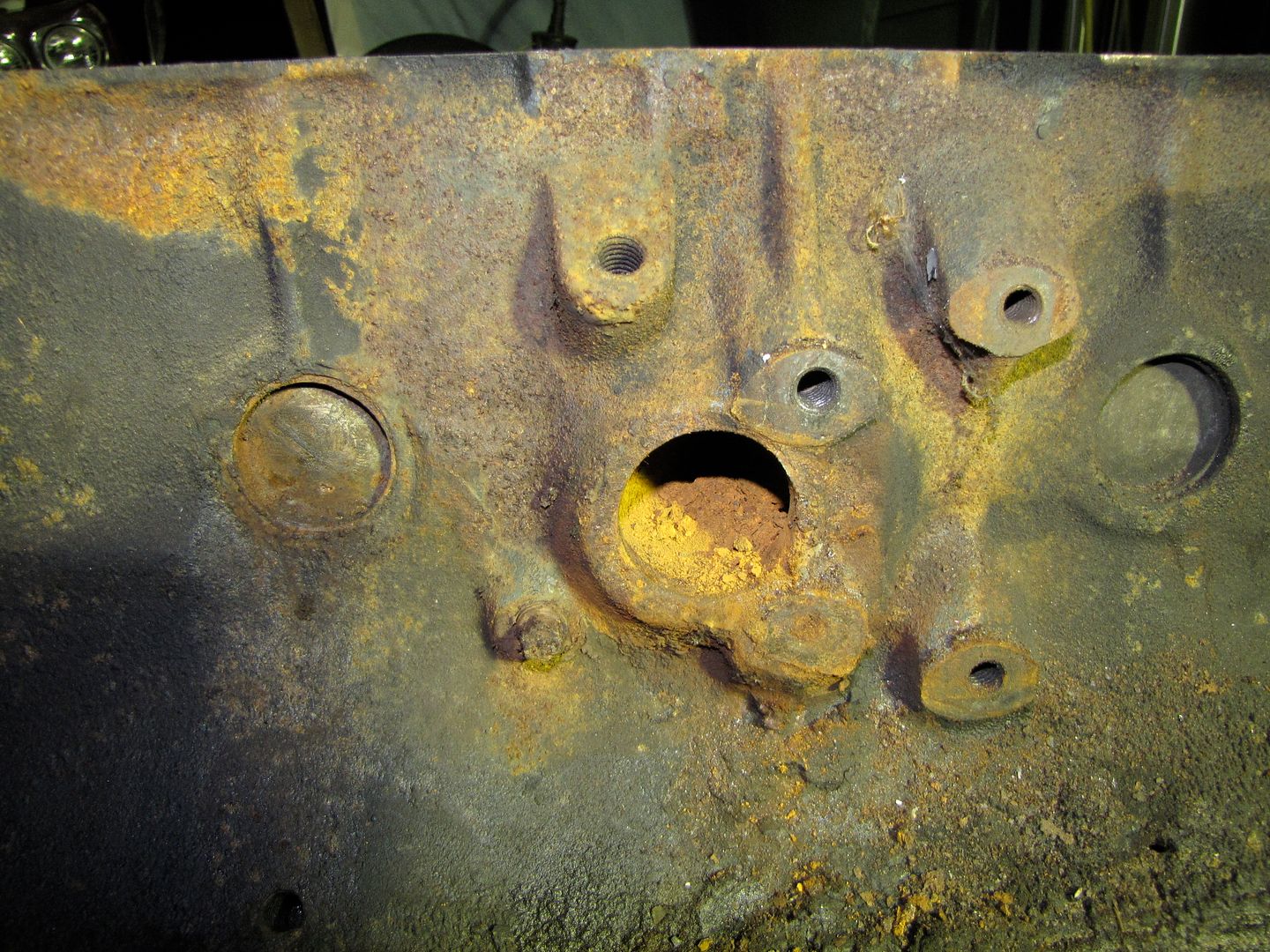

I found one freeze plug out and two others that are pushed outward in the middle due to ice! Not good but no visible damage. I am taking the engine to Keith Crafts shop when I get the last 5 pistons out. They are all stuck pretty good still. I’m not sure if I will have engine work done or just checked for damage. I am leaning toward having the block machined along with the crank and just have the heads checked out. The reason for this is that I still plan to sell the car. I may have the heads done also though since I could end up keeping the car in the end and at least it would be ready to build. This is all based on the block being good which I think it is.
