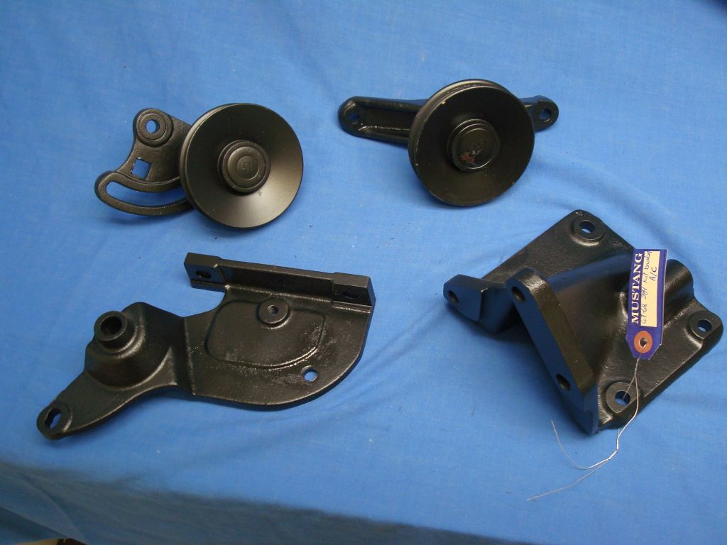

MustangTek shows this pulley and bracket for AC cars without smog. I have the idler pulley if you need it but unfortunately not the tensioner of its’ bracket. I had a smog AC car so I am familiar with the challenge. Any pics of your car?

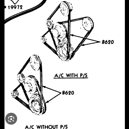

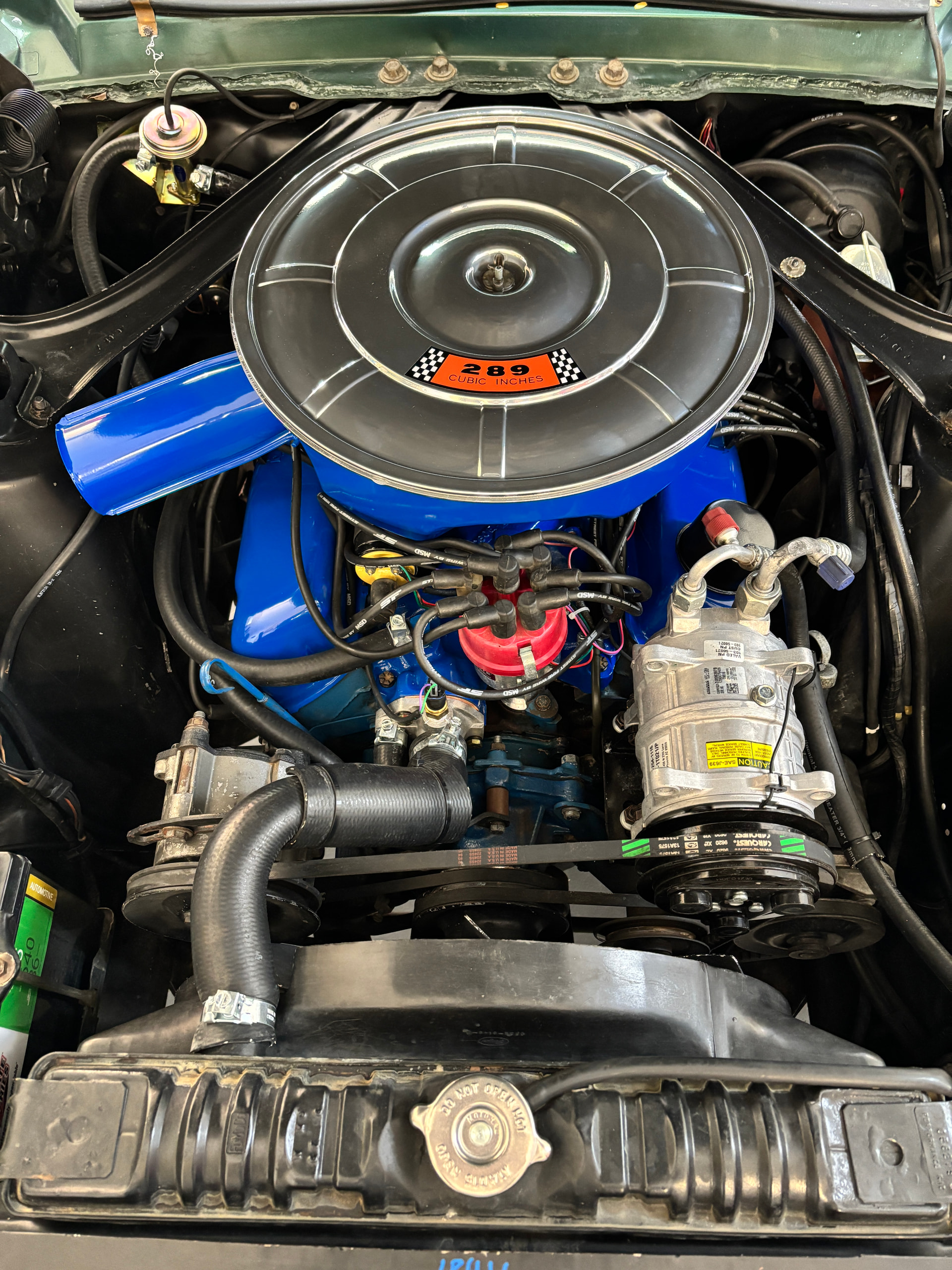

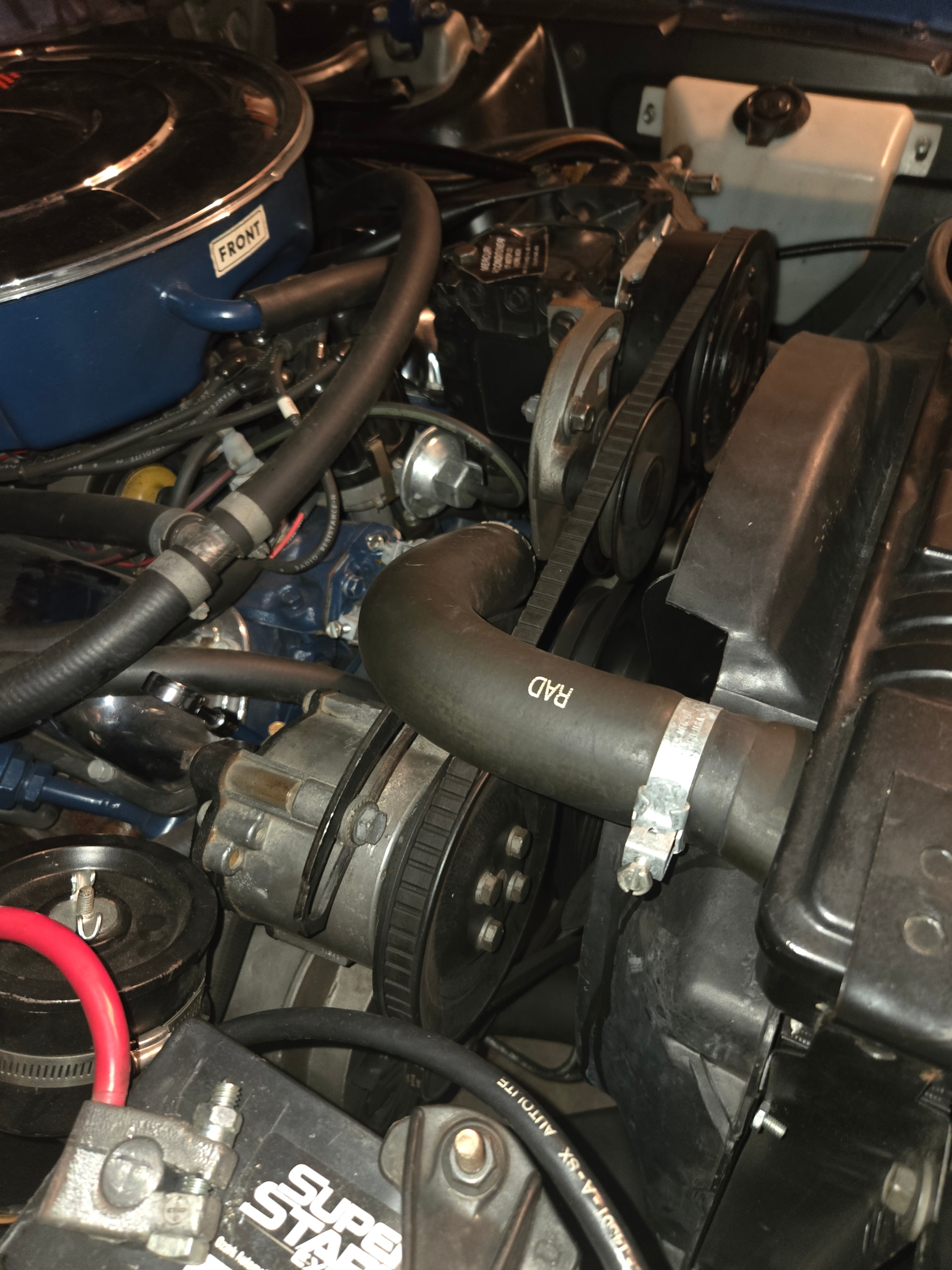

I always thought the PUMP was being used for belt tension, and that I’d have to replace it if I removed the pump. That’s what the 1967 engine manual shows for the thermactor; the belt runs from the A/C pump directly to the thermactor. But mine has an adjustable pulley mounted on the A/C bracket, which doesn’t appear at all in the engine manual (mine is a VERY late ‘67 build, though). And actually it’s currently providing only trivial tension at the moment since it’s all the way “down”.
Can I just leave the pump as-is, and run a shorter belt over the A/C, crank, and the two existing pulleys???
I don’t believe so because the belt won’t clear the water pump pulley. AC cars without smog had the tensioner on the opposite side of the water pump from where yours currently is.
