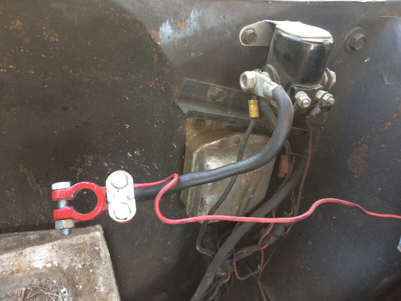

thunderchero,
I have not attached the charged battery yet, but attached is a picture of the positive clamp. There is a red wire that is also coming from it and I think it goes back straight into an aftermarket stereo. Should I just take off this wire in case the stereo is draining the battery?
