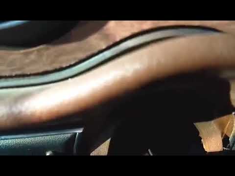

This might help. If not do a search for 71-73 Mustang as should be the same.
Cavallino
He is asking about the key cylinder. That one is for the switch. I haven’t found one for the lock cylinder yet.
