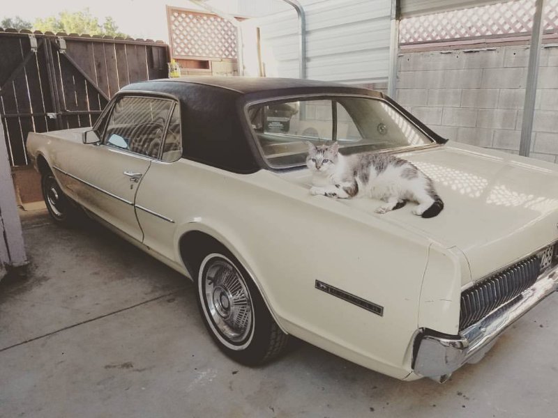

Car looks nice.

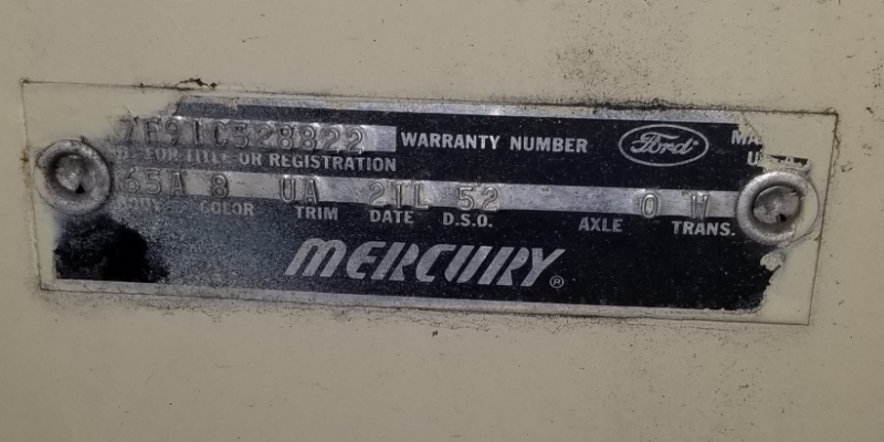

Maybe start with posting the VIN of the car and the door tag info, this way we have a better idea of the car’s details.
I like the “Cougar” Model you have on the Trunk! :wink:

VIN 7F91C528822

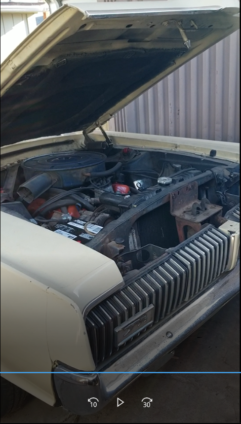

Your underhood is the same as mine.
Just posted pic earlier of my test section of engine bay refresh. After researching posts on that topic.

Nice looking Cougar! Judging from the greenery in the first photo and the California license plate I am going to guess Southern California. Very rare UA interior - don’t see many of those.

Great looking car! Sorry you had to inherit it ~ sorry for your loss. Hopefully you’ll be cruising reliably in it soon!
You can decode your VIN and door tag on the Cougar Club of America website. This will tell you what all the codes mean, which is VERY useful information to have when you go to buy parts or have work done.
As for “what version” engine and trans you have…
Your engine code is “C”, as denoted by the 5th digit of the VIN. C = 289 cubic inch V8 with a 2V carburetor (“2 barrel” carb).
Your transmission code is “W”, as shown on your door tag for “TRANS.” W = C4 Automatic transmission (C4 is the transmission model / type of automatic transmission).
