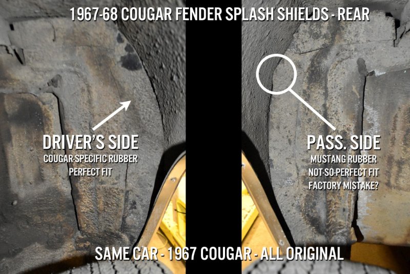

Yes, except those are the Mustang ones! They do not offer the Cougar rubbers. They are listed as Cougar but the rears are Mustang. Look at the photo
The rears are the same 67 and 68. The fronts are different due to needing to clear the “new for 68” side marker lights.
50% of all 1967 Cougars use the 67 Mustang rear splash shield rubber based on the dozens of 67’s on this property. I have contacted my supplier and they are going to make 100% of their 1967 kits to have the correct Cougar profile. If one is a stickler and theirs came with the Mustang profile in the rear they can request a set from our old stock. If you will be patient we will have correct sets in stock within 2 weeks (we hope).

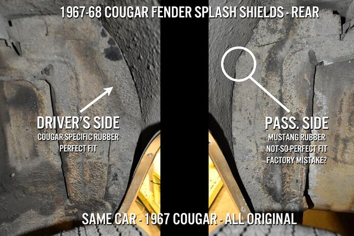

Here’s a couple pics of Don’s '67 GT we have in the shop currently. It’s never been apart. Strange to see that the LH side came with the proper Cougar rubber, and the RH side got a Mustang piece. You can tell by the bulge in the rubber (circled) where the Mustang fender has a raised contour, and the Cougar doesn’t.

Cougar fenders are differently shaped from Mustang fender, and the splash shields are (should be) different.
