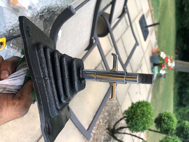

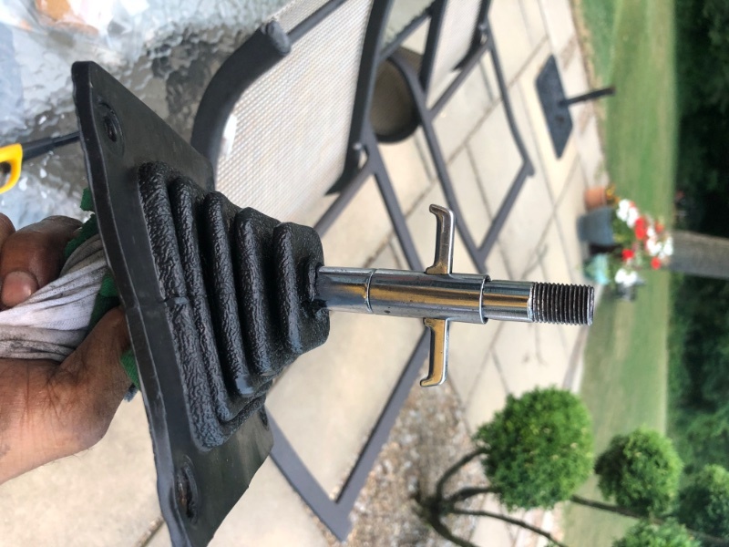

Install boot on 4 speed shifter
Is there a way to take apart a shifter 67 style to slide the boot on

So it looks like I am going to try the stretching technique
Installed boot and console
