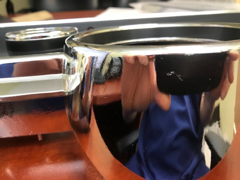

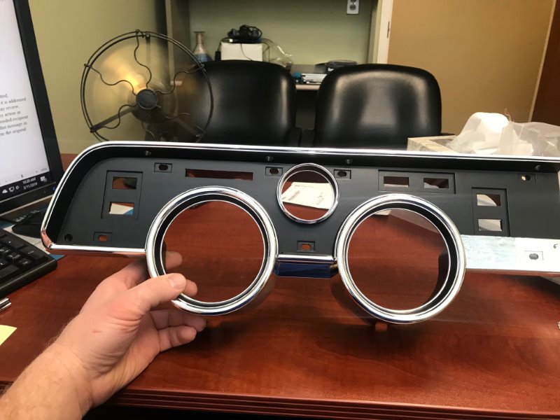

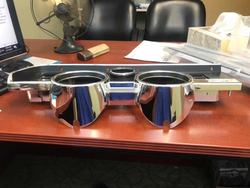

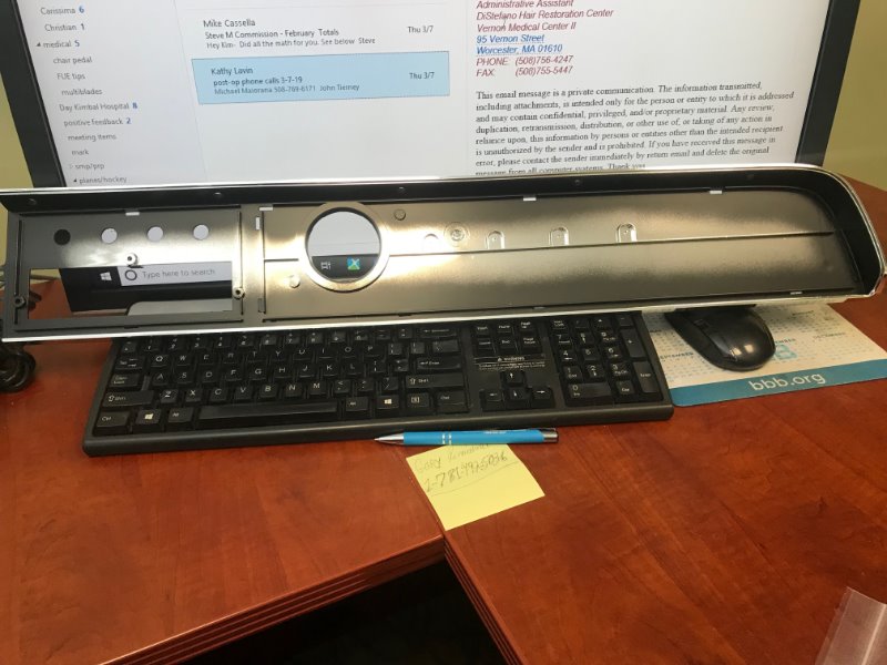

Well I got my bezels today. The repairs look great overall they are really nice. There is a couple of areas that concern me. Am I being too fussy? Please let me know what you guys think
More pics
On the bottom of the left pod there is an area missing chrome. The passenger side piece has a couple of chips they missed and chromed over

pics
Those didn’t turn out as good as mine did. Still they look pretty nice. Are you going to be able to see the defects easily after they are installed?
I don’t think you’re being too fussy at all. For the cost of having them done you should expect better.

As stated above at the $1,000 price I wouldn’t be happy. At $400 I wouldn’t be happy either, but would accept the defects at that price.

At the priced they charged it should be perfect in my mind. For $400 bucks I would probably live with it considering there are not many options out there.

The flaws would annoy me too, especially for the price. But now you have to decide whether to move forward and live with it, or potentially send them back to be redone, which could take months and be difficult for them to do, IF they would even do it. Once they have been restored like this, stripping all of that off to start over is difficult and may result in damage or destruction of the plastic. The other company I spoke to said they wouldn’t do pieces that had previously been restored, for these reasons. So, maybe your last option would be to ask for a partial refund. I think the pieces will look very nice once installed, but you could make the case that the quality didn’t meet your expectations.
What’s weird to me is that they look spray-chromed, based on the slight orange peel texture. I would have thought that vacuum plating would have a smoother finish. But maybe it’s just the clear coat they put over the chrome.

Your PS bezel is an XR7, you won’t be able to mount the dash face pad to it.
