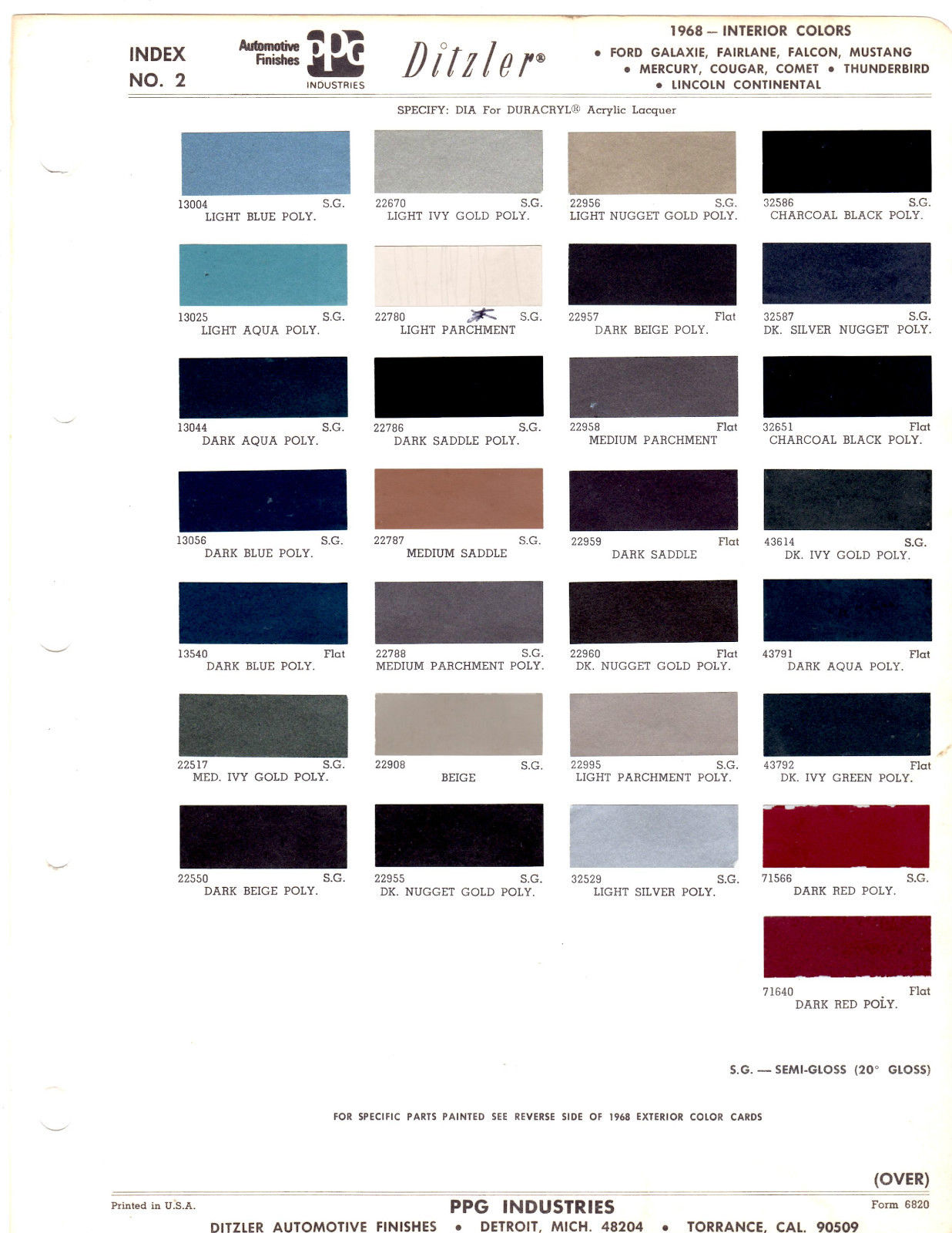

There are color charts out there for FoMoCo interior paints…http://www.ebay.com/itm/1968-FORD-MUSTANG-GALAXIE-MERCURY-COUGAR-LINCOLN-INTERIOR-PAINT-CHIPS-DITZLER-2-/371878216571?hash=item5695ab437b:g:HbgAAMXQdx5RFgbr&vxp=mtr.
That’s awesome, hadn’t seen that before. Image saved for posterity, here it is:
There are two versions listed for many of the colors - flat and semi-gloss. Wonder which are correct for Cougar?
Andrew:
The two color “finishes” were used on different parts – i.e., the flatter finish on parts that could reflect, such as the A pillars and package tray. The lower dash, steering coluimn, etc. would be painted with the poly finish, which has a very slight metallic content. (Check out an original dash and you’'ll note the difference – to me, it’s especially noticeable in black.)
Thanks for the info Dennis, I had no idea. Very interesting
