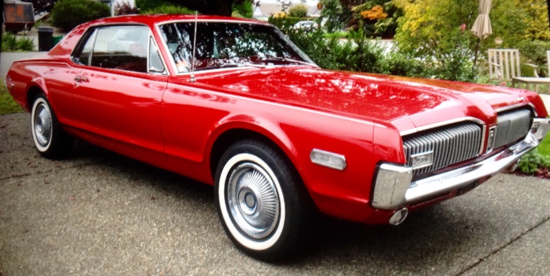

Hey everyone, refurbishing my 68. Sweet little gem. Exterior is “Cardinal Red” and red interior.

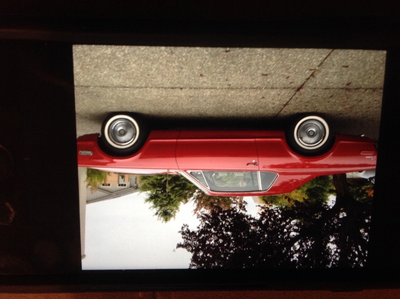

Are you in Australia?
No in Canada actually the second upside down photo was an attempt to correct the first one grrrrrrrrrrr
Reluctant now to show any more pics cause of this but on a positive note thank you for the clarification.
