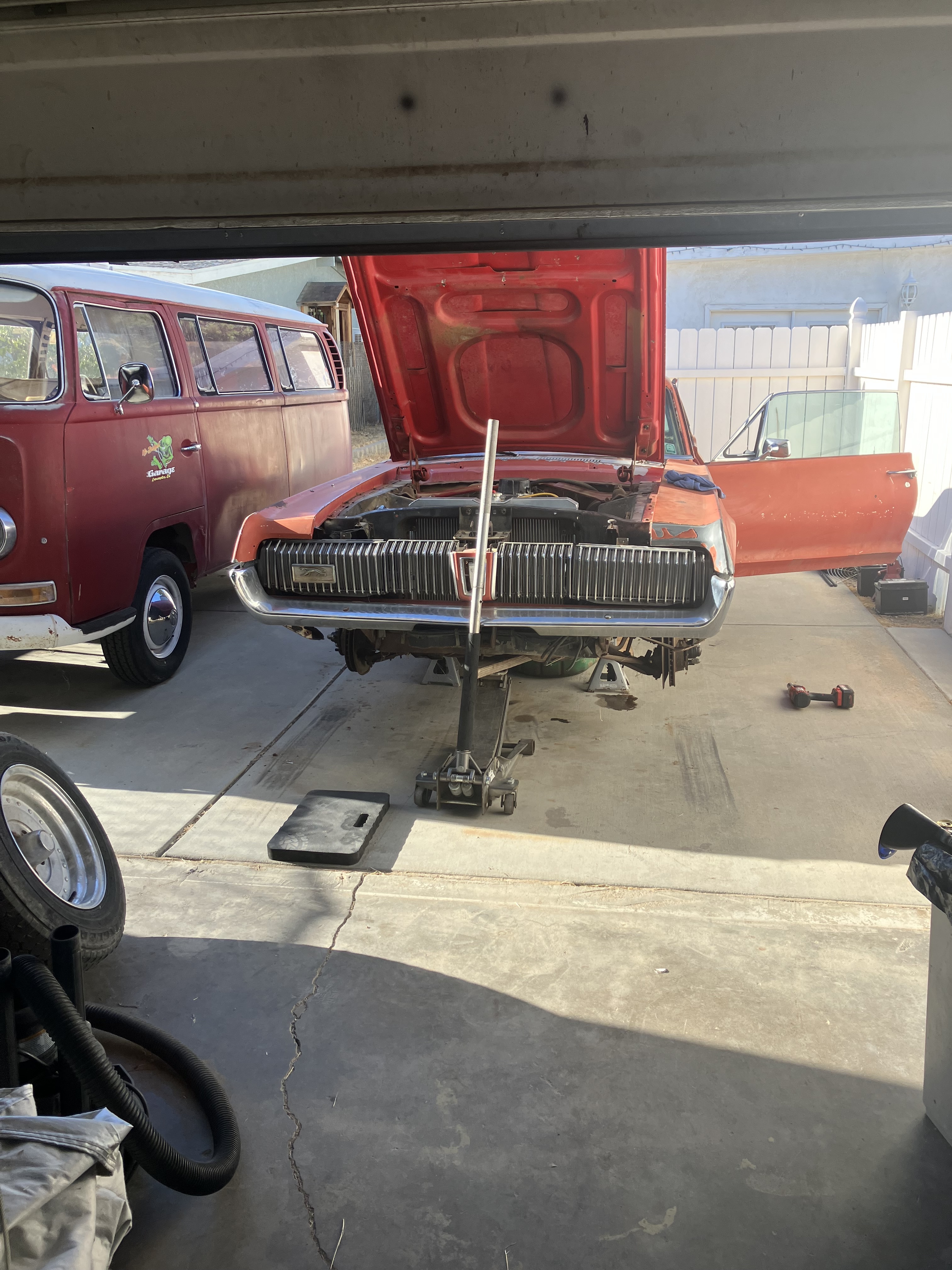

Time to check in. I haven’t done as much as I had hoped to the ol Cougar. Got some new spark plug wires installed and a new starter solenoid. The old starter was shorting out internally so a new one is ordered and should be here today.
The engine only turned about a 1/4 turn before stopping. Pulled all the plugs and started squirting WD40 into the holes. After a while of turning it back and forth I finally passed the ridge that developed in the cylinder walls.
Also installed a Holley 650 carb on the engine only to discover one of the holes for the stud is all boogered up. It looks like someone already had a heli coil installed but must have came out when they took off the carb before I purchased. I’ll stop and pick up an insert as soon as I can figure out the size needed.
I’ll keep chugging along as time permits.

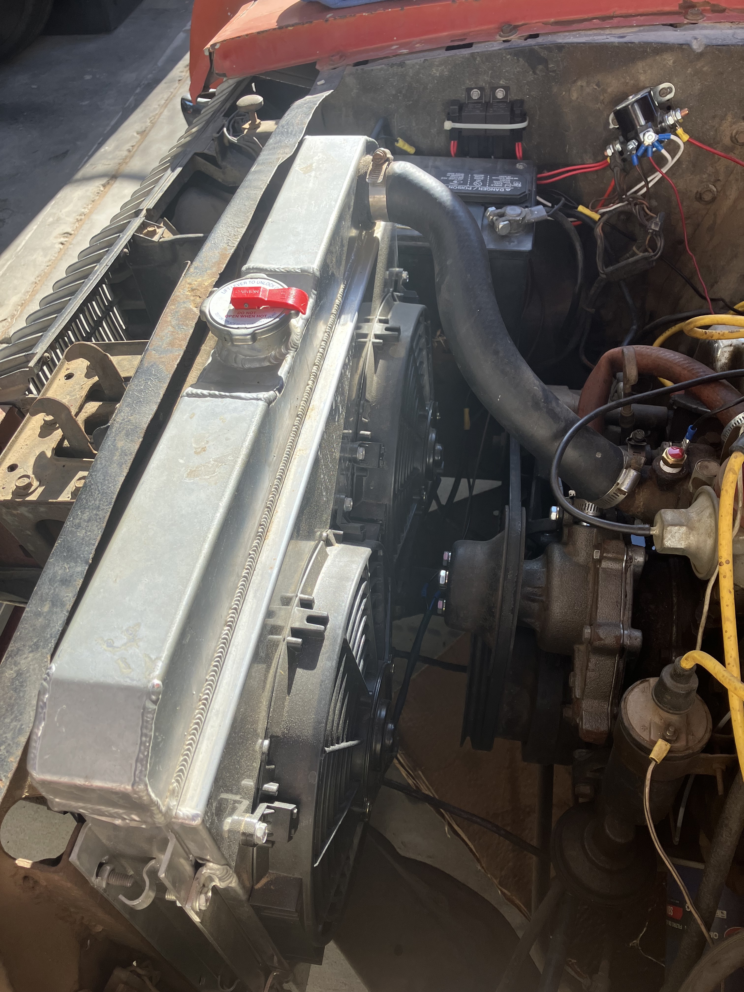

Still here and tinkering. Lotsa new stuff installed and still going. New radiator w/electric fans, water pump, hoses, carb. Seems to be running pretty good, temps are good, oil pressure good. Also managed to get the car to start with ignition key.
Currently dealing with transmission and shifter stuff.
Installing those shaft bushings and new neutral safety switch (currently bypassed) and new WIX filter and gasket (which seems to be lost in AmazonLand at the moment) and new kick down cable. New bushings for the shifter.
Also got a new front valance w/ hardware since mine is completely missing.
