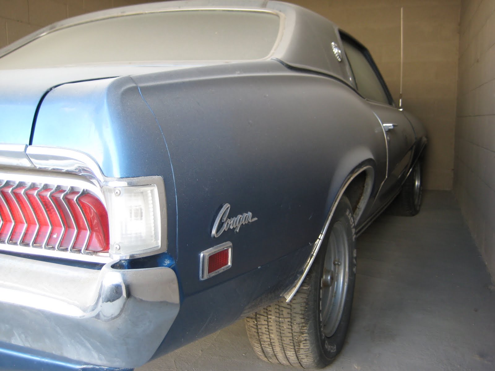

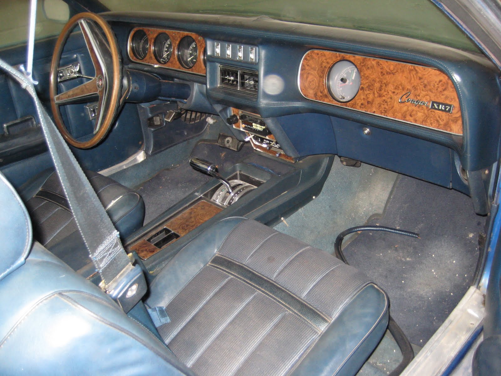

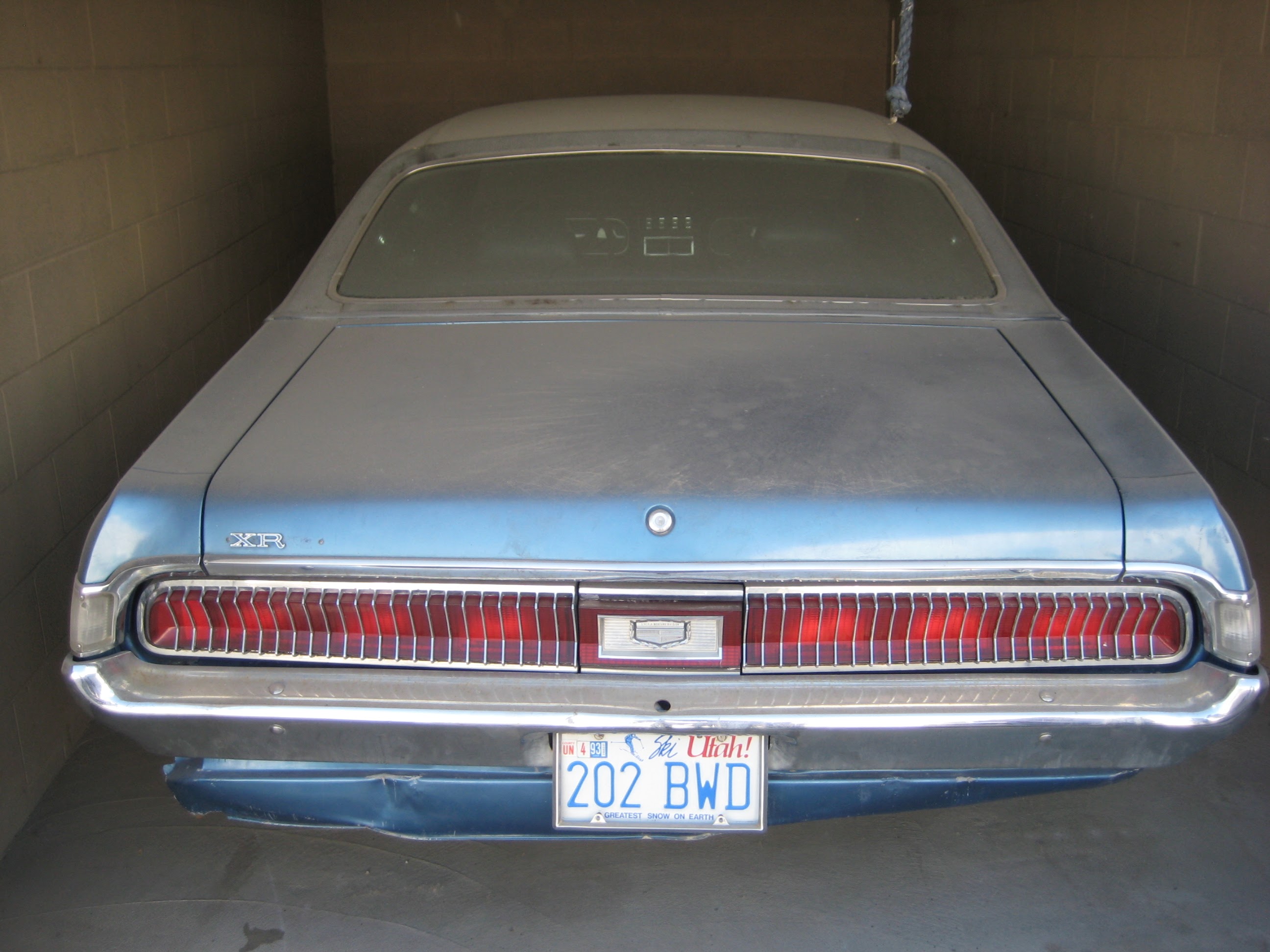

Here are a couple of photos I took from the storage unit when selling my original. Brings back memories.

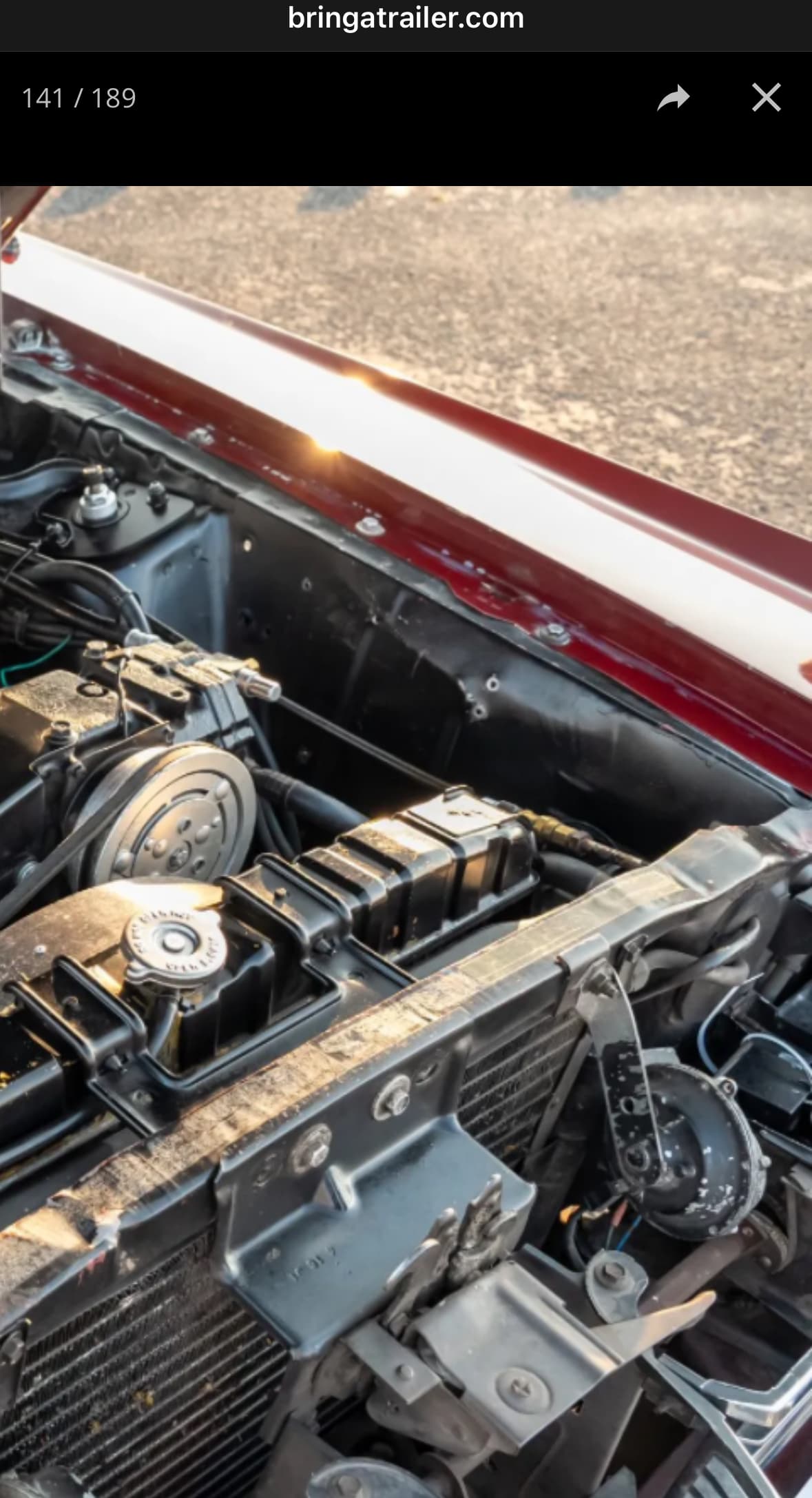

RUN from that car. If not for the bumper guards alone, which are wrong and just awful The car appears to have received an amateur restoration by shop that didn’t know Cougars well. It also appears to been in an accident based on how bent the fender apron is.
To learn more about what to look for when considering a Cougar purchase check out the videos on the WCCC website.
Thanks for pointing that out. I would have not caught the fender apron issue, and I’m not sure what to look for even now. Is the issue you are seeing the gaps between the fender and apron between the bolts or something else? If someone has a photo of a non-bent driver’s side fender apron I’d be interested.

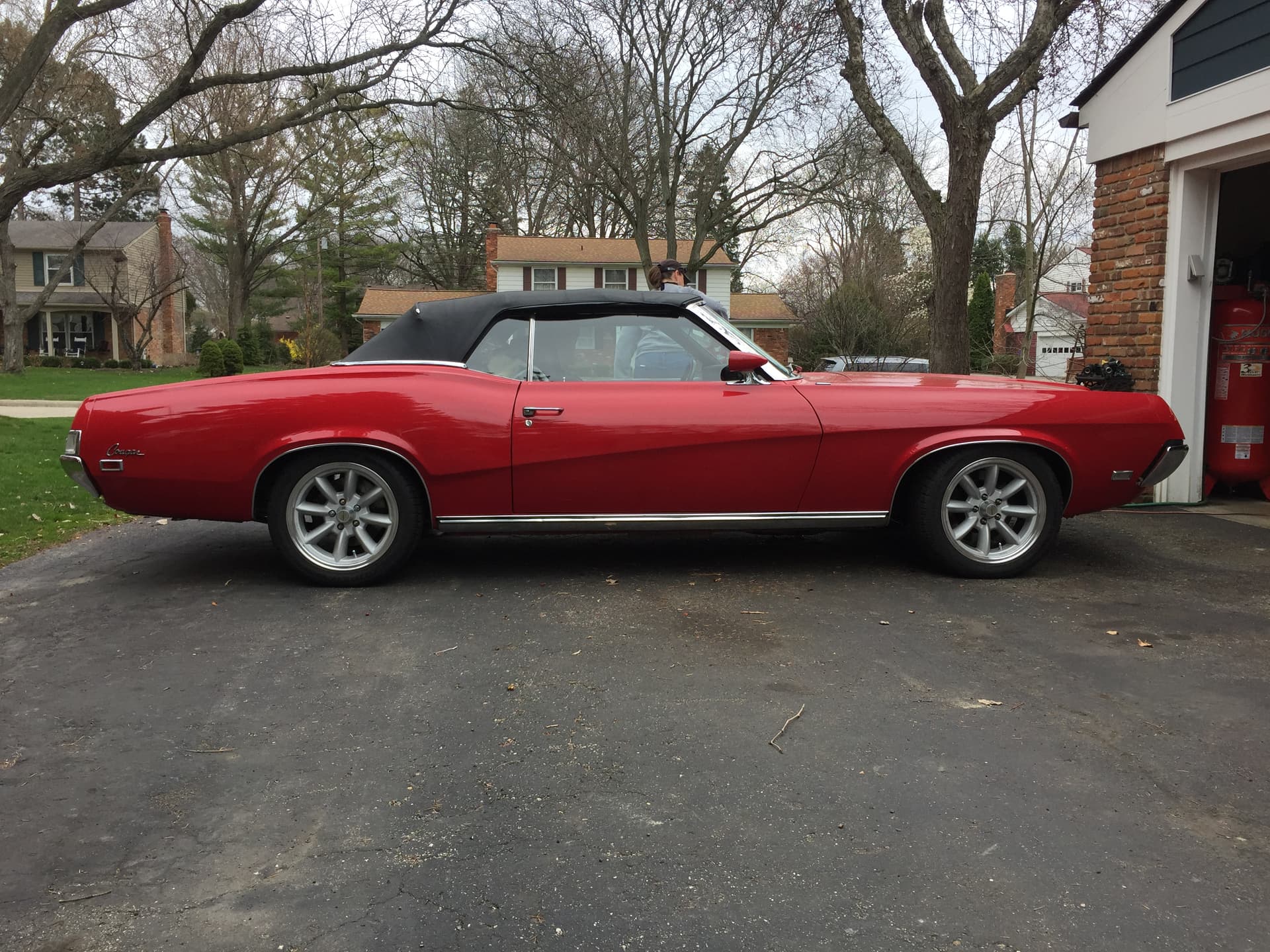

Welcome! My ‘69 convertible for reference. I’d suggest you watch Don’s videos to get you up to speed. I’d also suggest a deeper dive in to that car you posted to see what else may be going on with it. These cars are over 50 years old now and most have been through a number of owners and may have suffered from accidents or rust or ham fisted PO’s or techs doing who knows what to them long ago.
Nice car! I definitely prefer the black convertible over the white. Yours looks lowered a bit … regardless it looks great.
And you’re not wrong about those ham fisted PO’s because I’m probably one of them. :rofl:

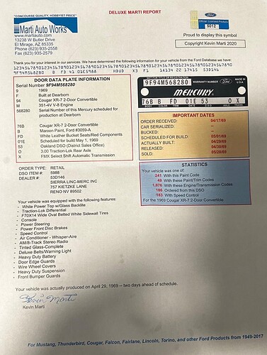

Are you saying a pre-purchase inspection AND a Marti report or is the Marti report a pre-purchase inspection? I believe they posted a photo of a Marti report. Is this what you mean? I saw before but I didn’t know its significance. I will look at it a bit more closely later.

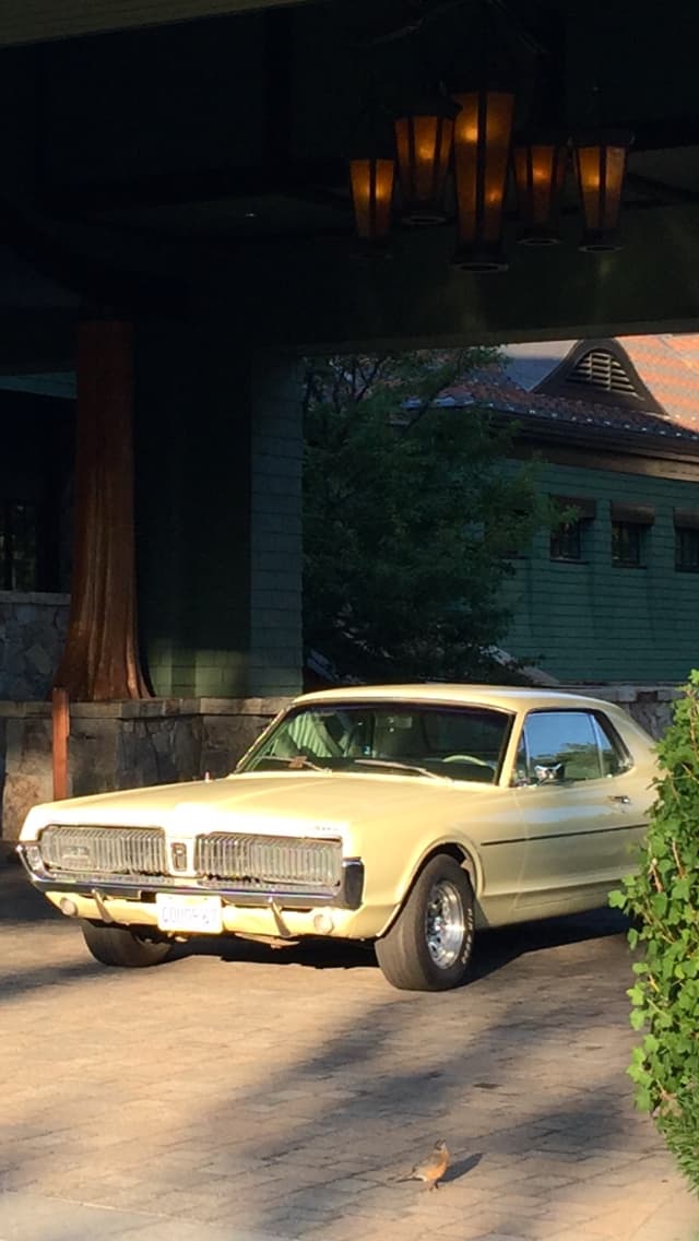

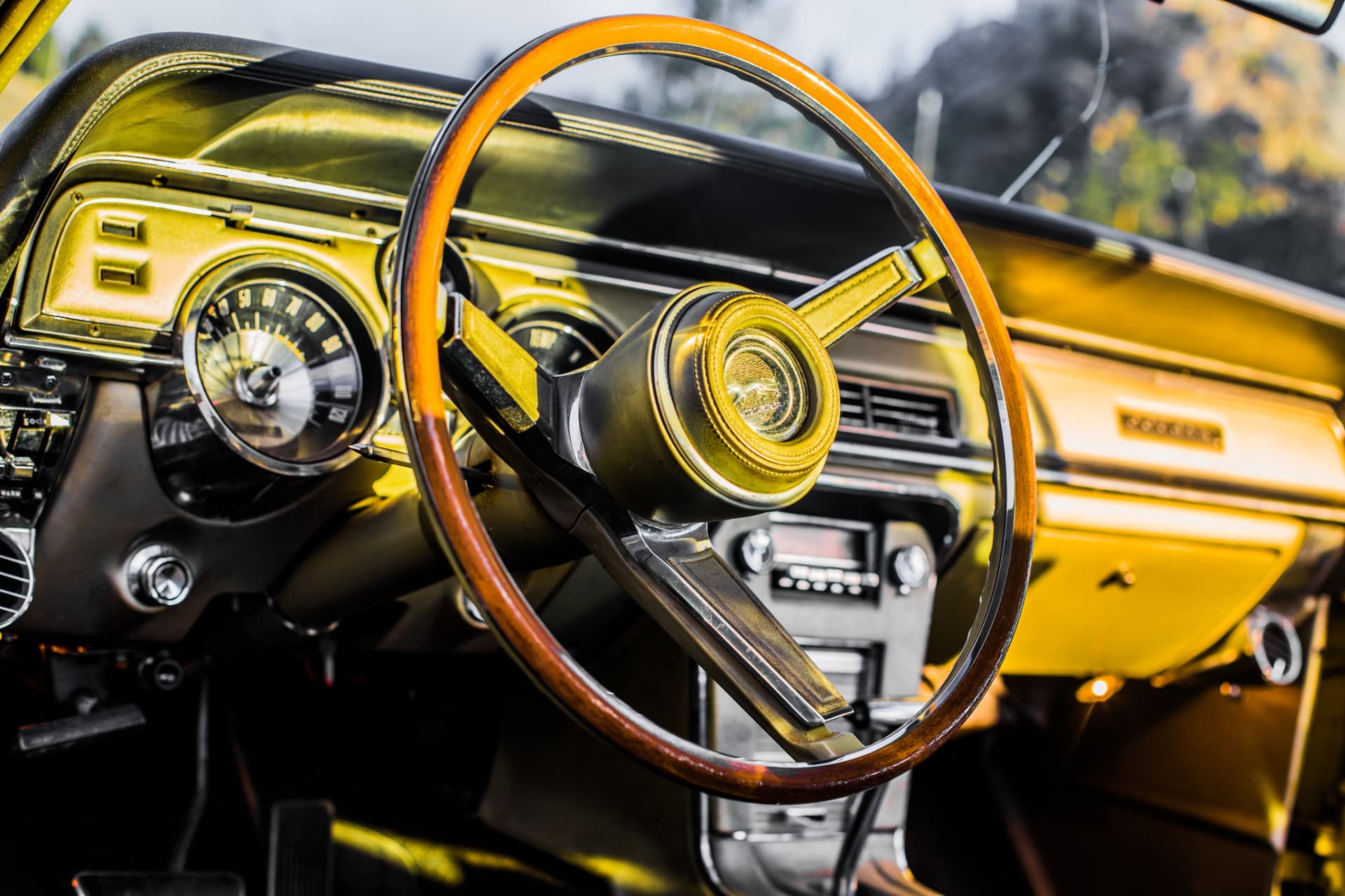

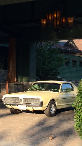

I’ve a 67 if you’re interested. You can research my posting pics.
Fires up and runs around town. Needs some work. Interior original
I believe he means the crease in the metal.
To me, that convertible needs a restoration. The current paint job is full of chips and has a big hole in the fender where a spotlight was mounted. The fitment on the hood and trim is terrible. The top needs replacing. Underside of the car looks pitiful (look at the front valence area and even a spray painted gas tank). Someone who didn’t know what they were doing ruined the boot trim by drilling holes instead of using the right boot. The fan shroud is pop riveted together, and don’t forget the poorly repaired accident damage at that fender apron. It’s bowed inward, possibly from being t-boned. Could have been from a major blowout, I’ve seen that as well.

@Electric_Wizard thanks for pointing out the crease.
@DroptopCougr thanks for the additional call-outs.

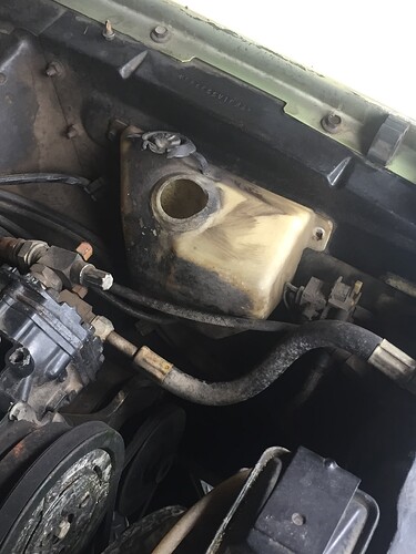

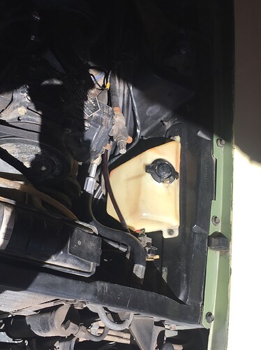

I was digging through photos of my old ‘69 and started comparing the engine bay and sent the attached photo to the seller asking if it had been in an accident and described other things I noticed from missing bolts, bent horn bracket, odd gaps and what looks to be a zip tie on the headlight and bent A/C condenser tube. It also looks like something was pulled out of the apron area. On some cars I’ve seen what looks like a washer fluid tank there, but my old one didn’t have anything there so I’m not sure what it might be. We’ll see what they say.
