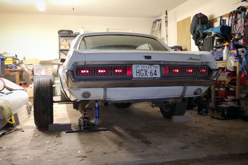

Well, I was taking a cruise from Houston to Corpus Christi Thursday evening for a movie shoot when a rear wheel bearing gave out, and my axle came sliding out of the rear end at 65 mph. Thankfully, it didn’t come all the way off, and I was able to safely get the car to the side of the road.

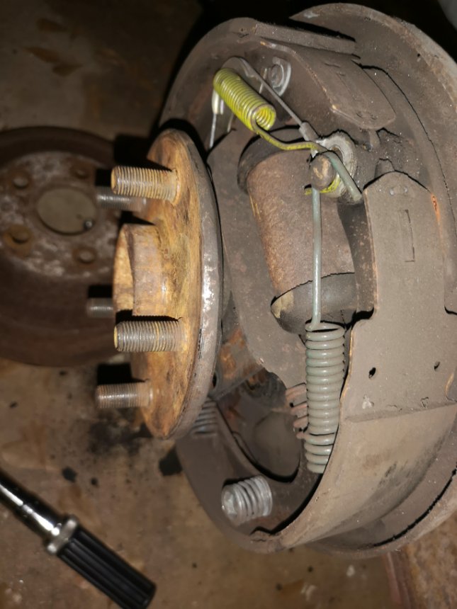

I’m in a situation where I need to replace the driver side axle, the wheel bearings and seals on both sides, pull open the housing to inspect and possibly replace the gears in the differential, and since there’s gear oil all over the driver side brake shoes, I might as well replace my shoes and wheel cylinders on both sides while I’m doing all of this work.

Couple cans of brake cleaner will likely cure the lube soaked brake shoes, change out the fluid and put it all back together. Like was said earlier, you can easily get in over your head switching to a 9" and needing all new stuff. Nothing will interchange with the 8" you already have.
