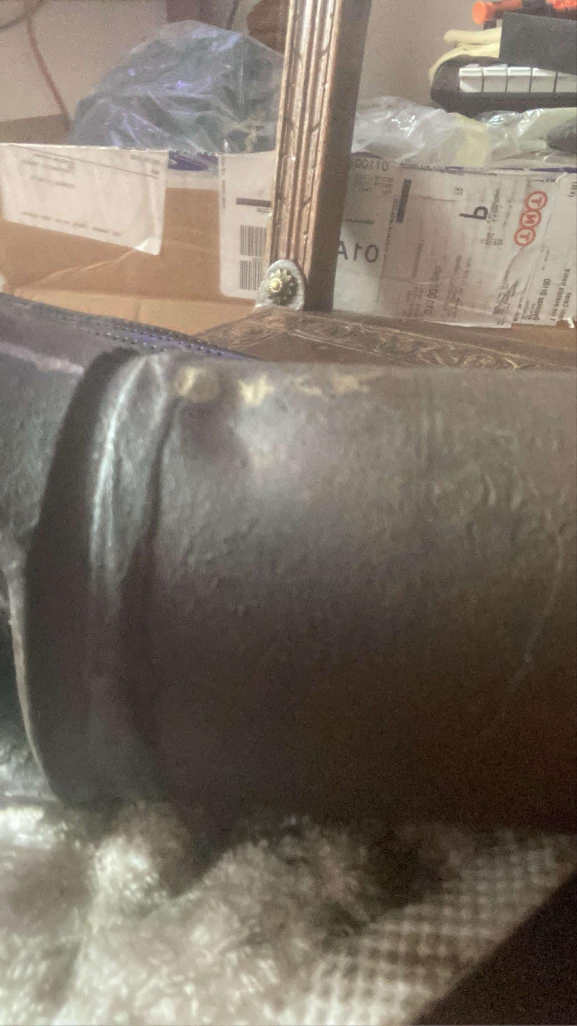

Is my driveshaft shot?
[1968 cougar GT ]
I replaced my U-joints and seals… during my test drive i got a strong vibration even at low speed, I’m not sure I’m the one that dented the driveshaft so maybe I didn’t set the preload right at the yoke…
But still, this driveshaft seems junk isn’t it ?
tail shaft bushing is bad most likely allowing movement of tail piece in tail of transmission
I think it’s junk. The good news is that a local driveshaft shop can generally build a new fully balanced unit for less than you’d expect.

try heavy duty truck shops
Like blue68cat said likely the tube has to be replaced the other parts are still usable.
you mean the ends and the U-joints?
Another option for not too bad $ is full new reproductions

Correct a drive shaft shop will only replace what needs to be replaced. In this case the tube.

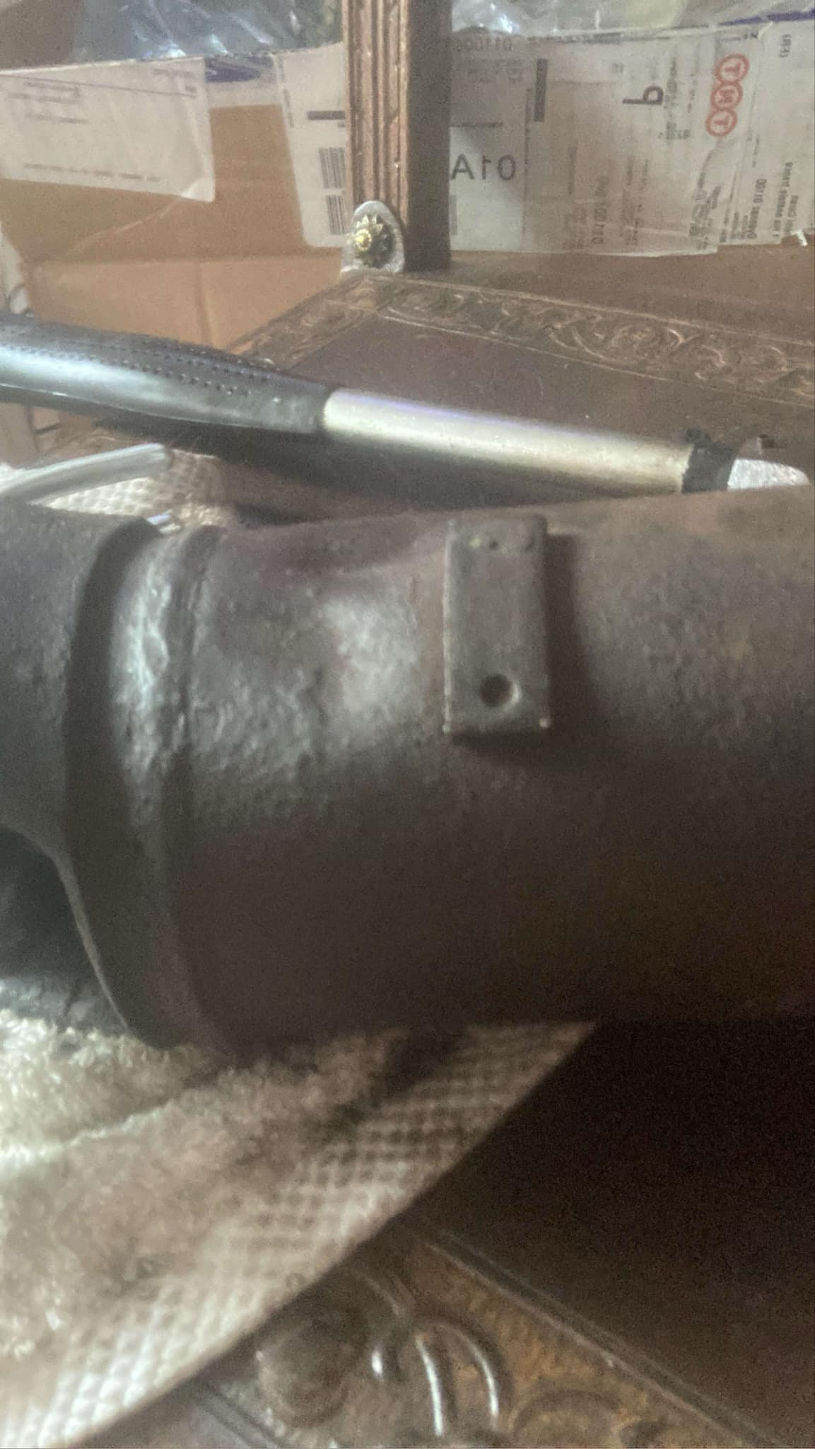

I just don’t think your “dent” is a issue.
If the weight next to it was gone, yes it needs a shop or replaced
