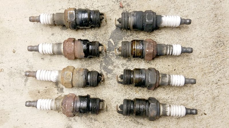

Anyone a guru at reading spark plugs? I swapped my plugs, wires, cap and rotor last night. Wasn’t really having any particular issues, but as they were all of unknown age and history, I figured it would be best just to update them. Aside from the dust bunnies on cylinder 1, can anyone see other issues? Not sure why cylinders 1, 3 and 4 has so much oil on them. Could that be from the valve cover leaking?
The oil on the plugs is from external source, they don’t look like even burn across all plugs, second from L/F looks to be closed up and would cause a miss on that cylinder, # 3 back L/F looks lean. All should look like #3 on r/h side.
