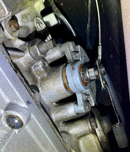

‘67 XR7 seems to have a slight leak from the kickdown linkage mechanism on the driver side of the C4 automatic transmission after a recent change of the filter and fluid. Ideas? Is there a bushing that needs to be replaced? Thanks

Thanks. I had checked the pan bolts and gasket. The leak seems to be coming from the bushing on the kickdown linkage. Where can I get info/buy shift shaft and kickdown linkage seals? I’ve searched to no avail as yet.
A transmission shop can get them. If you have a transmission shop nearby, they might have it in stock. I like to stock odds and ends type stuff. This isn’t the first time I’ve seen the question of where to get this stuff. I ought to put a kit together of shift and kickdown linkage seals.

Wow, thanks! Here’s a photo if that helps.
