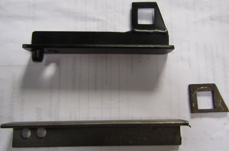

leon,
Edlebrock makes a kit (EDL-1483) that bolts to the linkage & has a post for the Ford kickdown tube. The only issue is it makes the throttle cable out of alignment. I use a piece of angle iron. Drill 2 holes ( use the gasket as a template), then weld a short post to go into the hole not used by the carb. Then cut the square hole tap off the old bracket & weld the the end.
