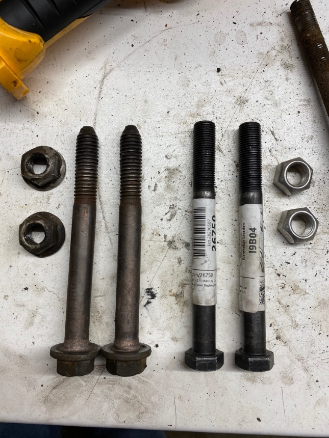

First question, which bolts/nuts should I use on the front eye of the leaf springs?
On the left are the bolts/nuts that I removed. The bolts measure 4 3/4", have coarse threads, are pointed, and both the bolts and nuts are flanged.
On the right are the repro bolts/nuts from WCCC. The bolts are 5", fine threads, flat ends, and unflanged.

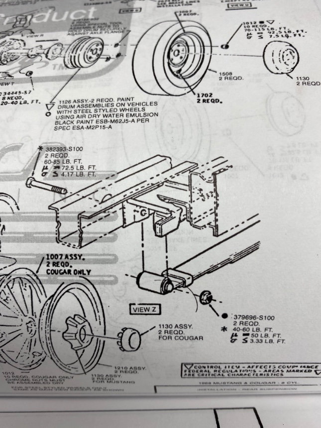

The AMK website seems to suggest the coarse thread/flanged bolts based on assembly manual part numbers but I know that things were changed.

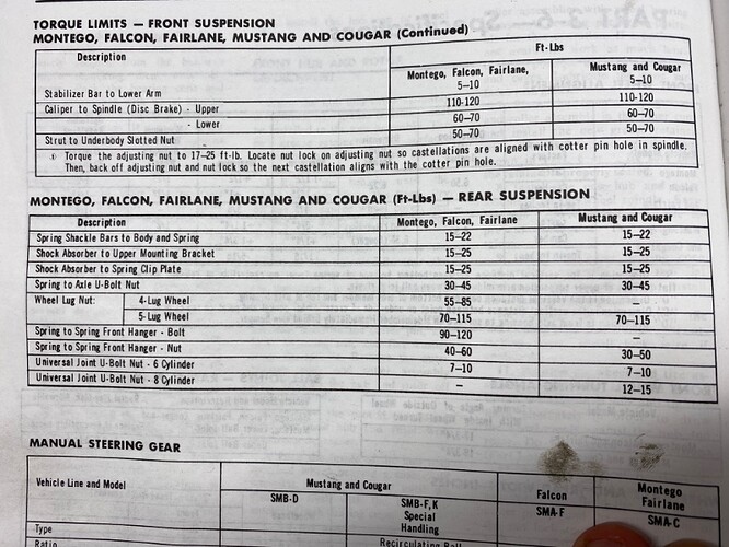

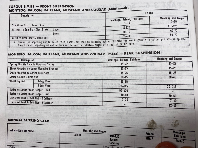

Second question, my assembly manual calls out one spec to torque the bolt head and a second spec for the nut. How does that work? Which is correct?
