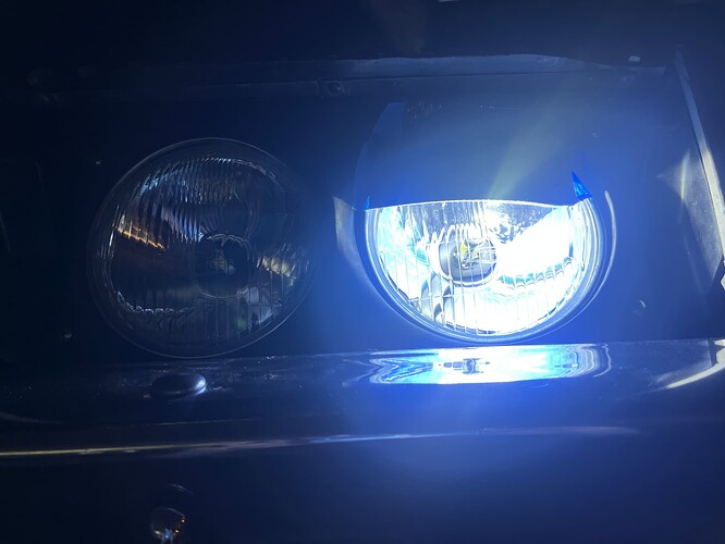

Here is before I removed the tabs:
I ended up taking everything apart so I could compare the LED to the halogens that came with the kit.
When I was putting things back together is when I decided cut those tabs off. Come to find out now, it’s a common modification to some models.

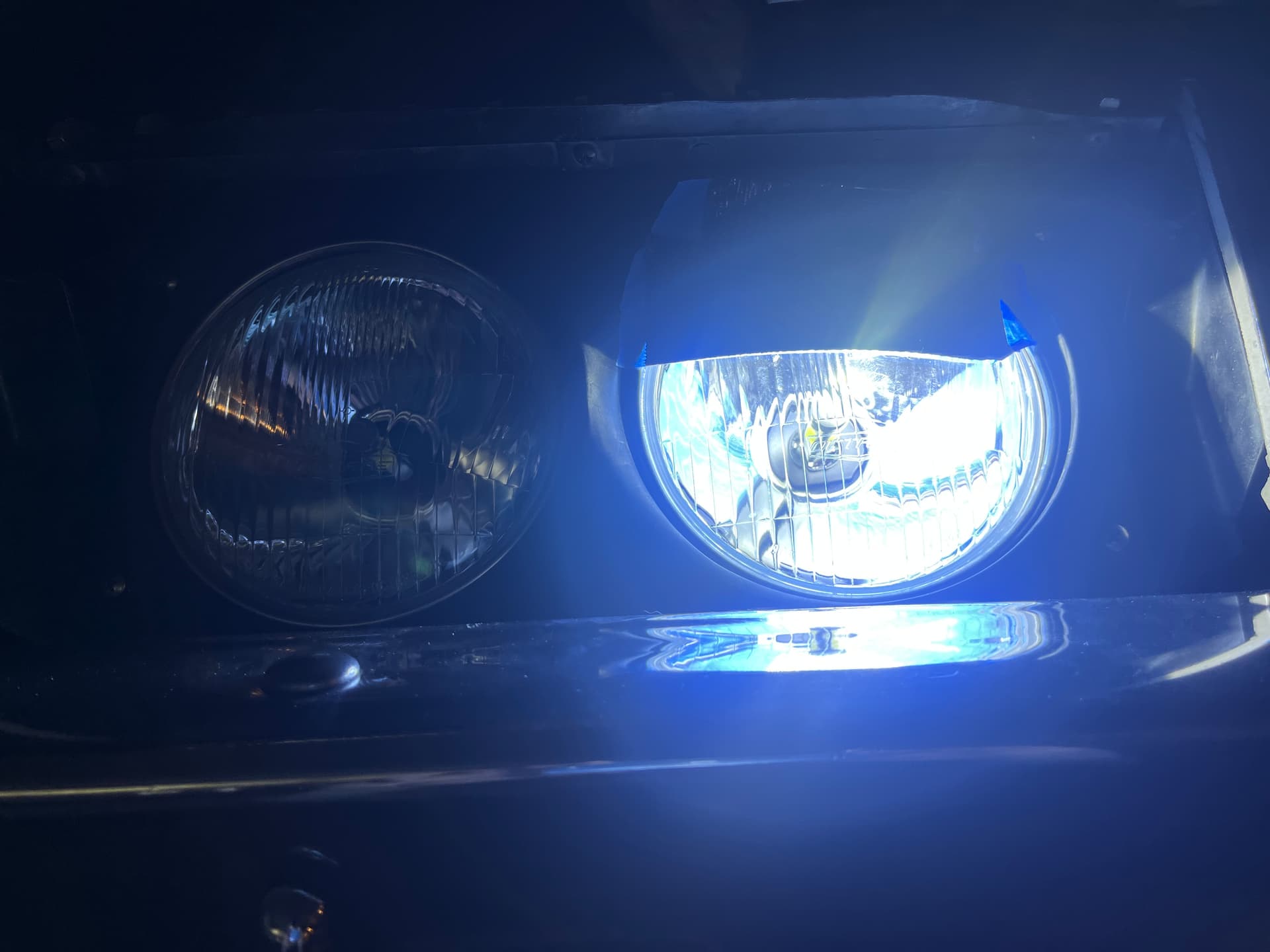

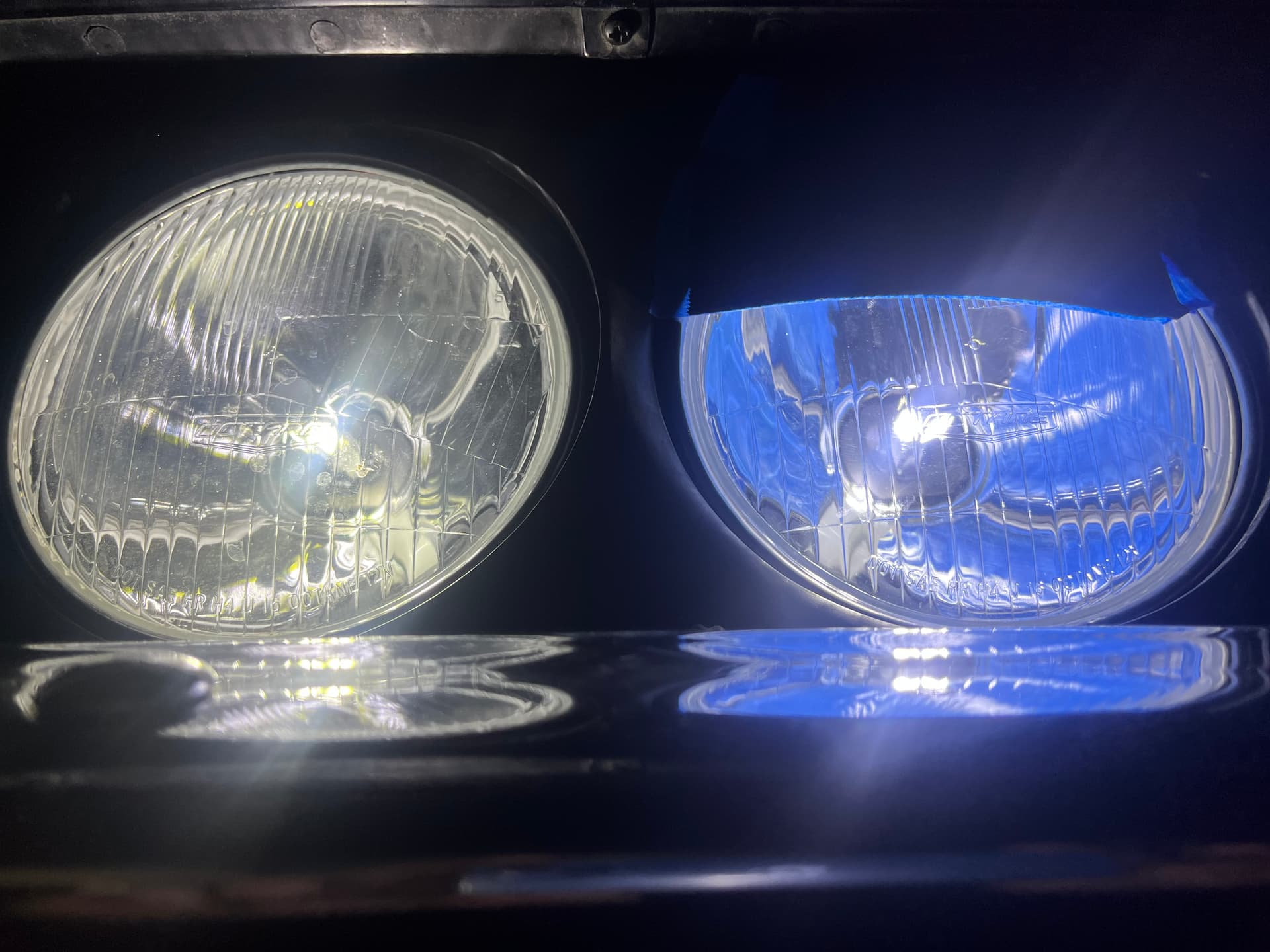

So that gave me an idea that seems like it’s going to work and may please on coming traffic.

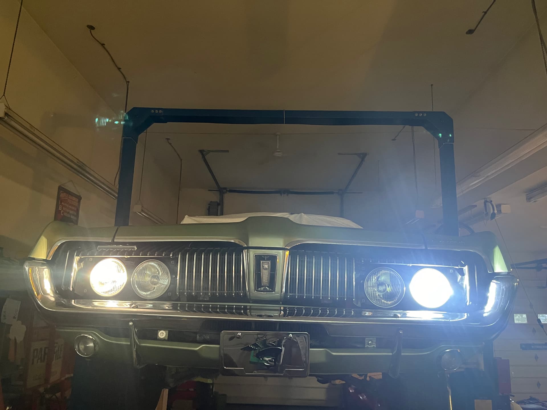

I had to get my welding glasses but you can see the low beam has 2 of the 4 LEDs illuminated and they are the 2 that face up. When hi beams are switched all 4 LEDs in each light illuminate.
Here is with and without the tape I’m using for a cutoff line:
