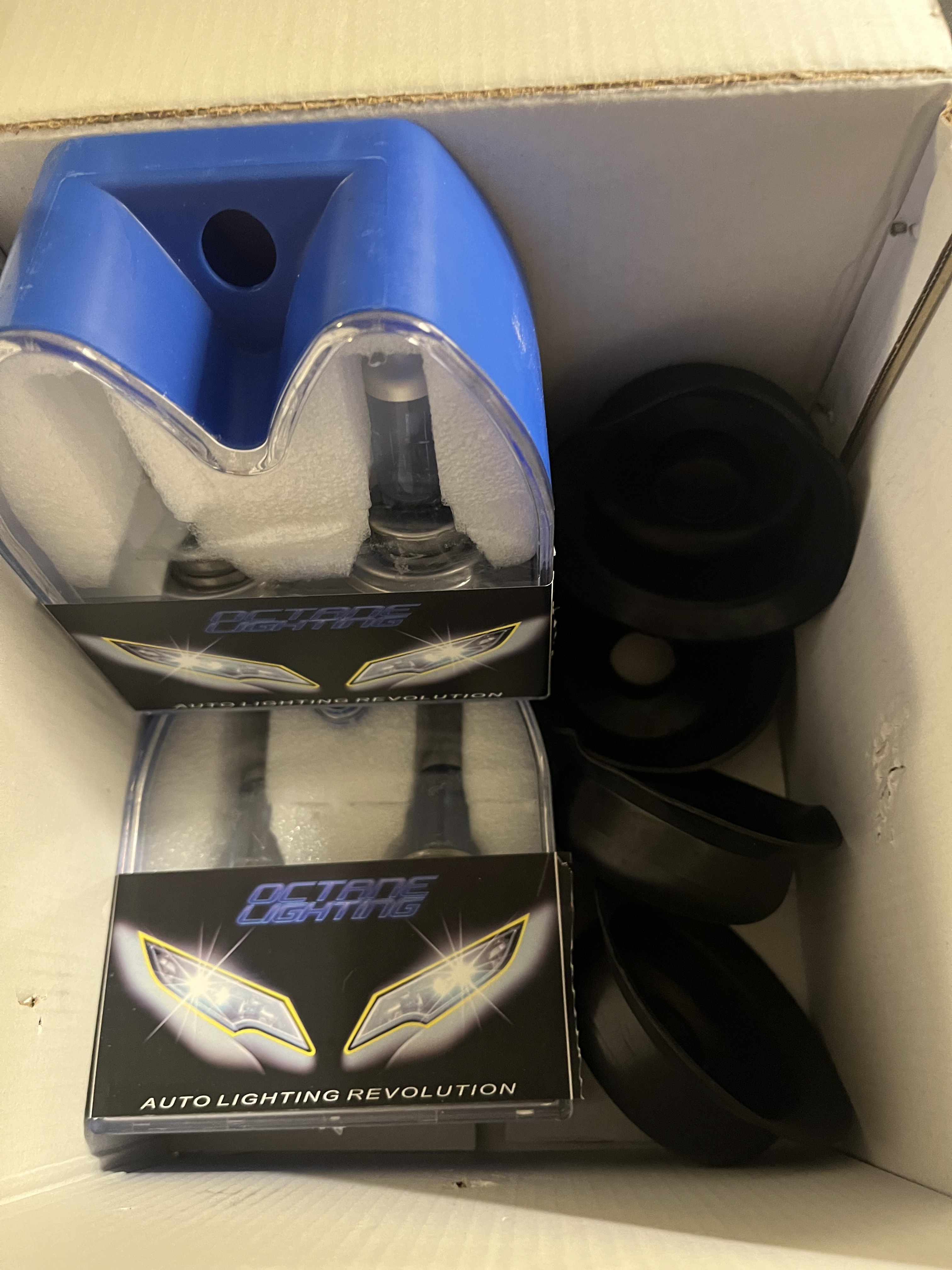

I’m not sure it was a mistake, but my led octane kit came with 4 bright white halogens, also. I was a bit confused at first because it’s not advertised in the listing.
Either way, I won’t be using them because I don’t have the halogen relay kit.
I priced the Dapper lighting, at 175.00 each! The Octane set of four, for two hundred seems a very fair price- but the review for the Holley product is a very strong recommendation. Still some more research to do but this has been a very helpful thread!
The Octane lights come with halogen bulbs installed, but also LED bulbs to be installed. It is very easy to change the bulbs to LED before putting in the new headlight assembly.

The Octane kit only includes the LED bulbs at least the four kits that I bought.

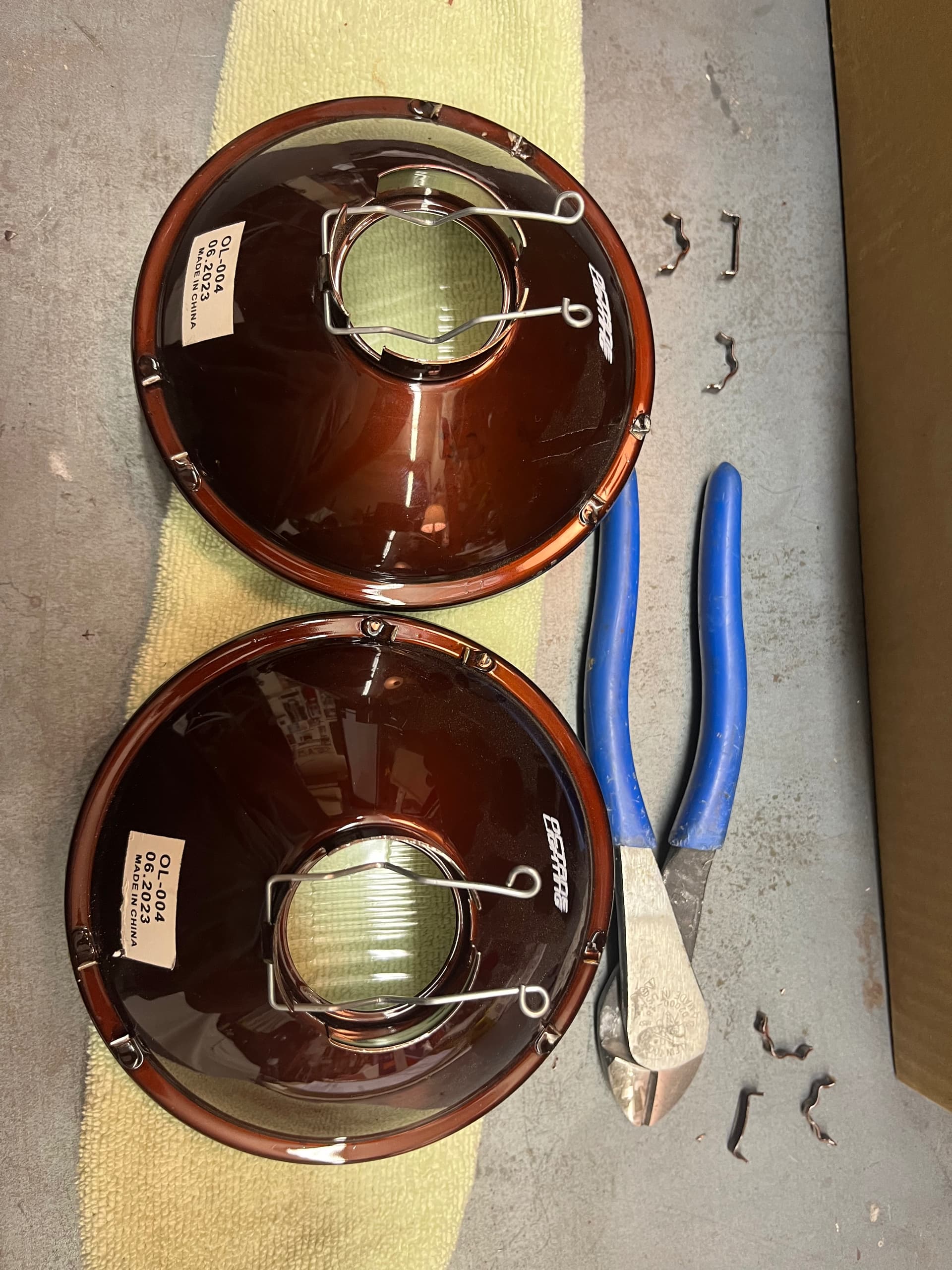

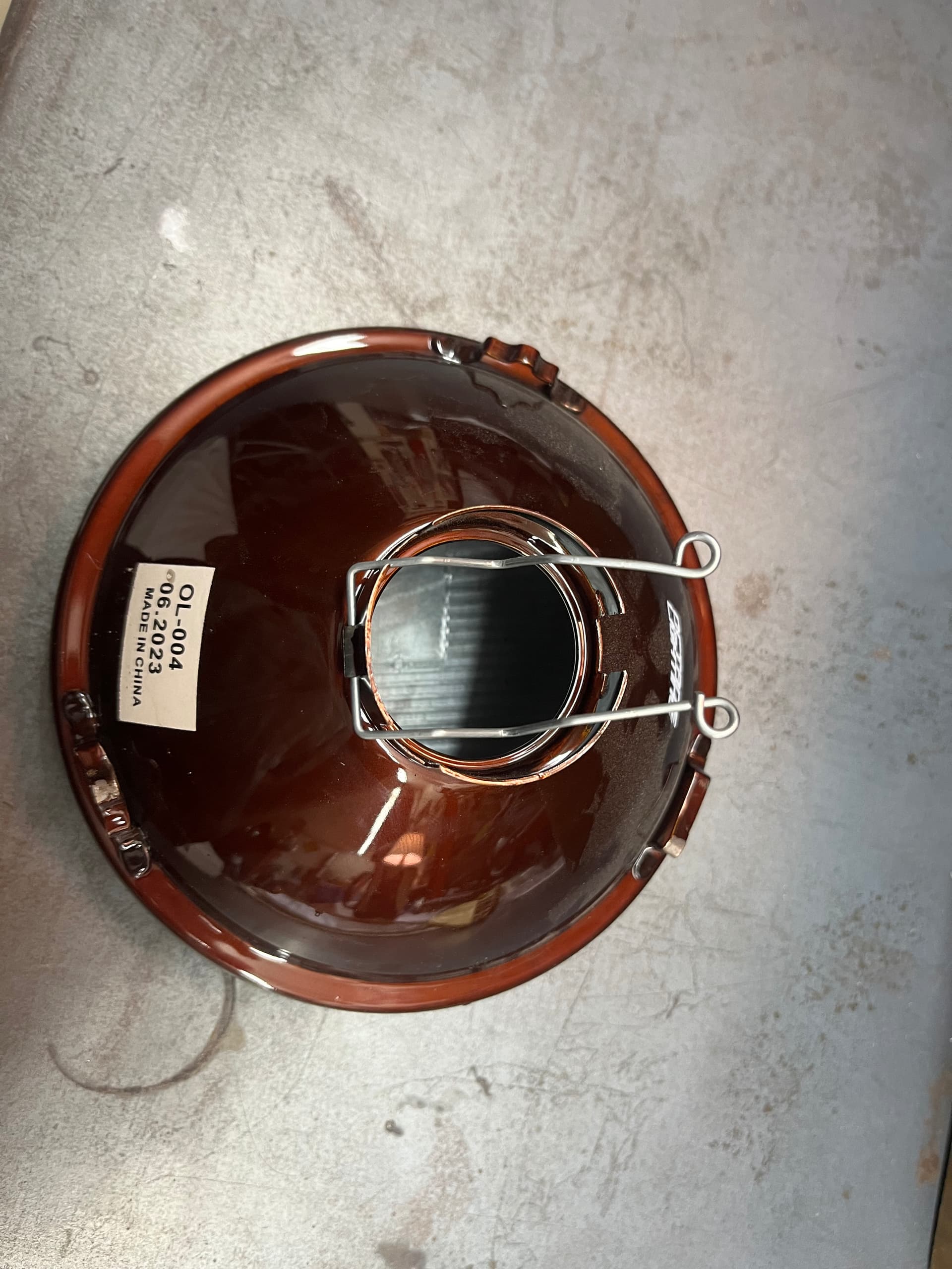

once these are removed, they fit much better
Thanks for showing this- I see the tabs you cut off there. Do they fit more flush? Do you need to dress the area with a file or similar after you cut them off?

They don’t fit more flush but those tabs would make contact with the bucket behind the light.
With it making contact it would not allow the light to secured in a level orientation. Meaning the word ‘octane’ in the center of the lens would not be level.
It was also more difficult to get that 2nd screw (in the retaining ring) lined up with its receiver hole.

Oops…I forgot to say, I didn’t file anything. I don’t believe that part makes contact, anymore.
In order to be more clear…
I would hook the spring to the retaining ring after the light is plugged in. Then placed the light in the ring. It appears the front glass portion of the light is tight up against the stainless steel retaining ring.
The light will not push back into the bucket with the ring secured in place so I’m not certain those sharp edges from the cut tabs are up against the bucket. But, I don’t believe they are. I believe it is the top outer edge of the light that is being ‘sandwiched’.
Which in second thought :squinting_face_with_tongue:… your statement of them fitting more flush, makes perfect sense now. Thanks

A person doesn’t have to modify them. It just makes them fit better.
