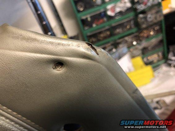

Also speaking of tearing there is one small tear/puncture in that section about the size of a pencil eraser. All the material is still there so I think it would be an easy fix? Is there a method that works well? Maybe glueing another scrap price behind it? Also have a couple other small tears on the edges but that won’t be seen with the door closed. I would still like to lessen their visibility and keep them from getting worse.

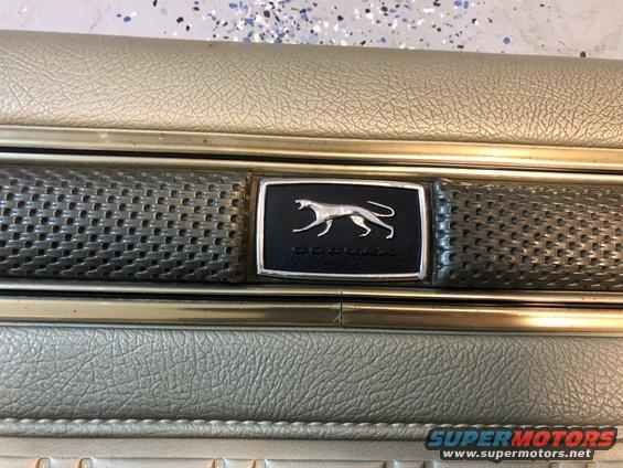

The other challenge I have is my panels are the decor version so I have the whole basket weave to deal with. The chrome is now discolored to a nasty yellow gold color so I think I have an idea on changing the color to a silver to match the rest of my dash but it will be time consuming. The good news is it’s not flaking anywhere just yellowed so if I can get paint to adhere I should be able to mask it and paint it.

On the front door panels, the backer boards don’t go up that high that you have to remove the vinyl from the top edge. There is a curved metal piece on the upper rolled portion to the window. As far as the small crack, a two part plastic epoxy actually worked good for me in repairs to my vinyl face pad. I tried using the vinyl repair glue, and it didn’t look as nice. You are going to have a little bit of a stiffer spot using the epoxy. You can try to “grain” it a bit with a scrap piece of vinyl, or those vinyl repair kits have texture patches in them.
As far as the frame around the weave, I used the smooth aluminum tape like they use on duct insulation. I cut in narrower than the two inches or whatever it is so I wasn’t dealing with too much stick area. I got as much of the old vac sealed chrome off as I could, wiped the surface down good with rubbing alcohol and worked the tape on those areas, making miter cuts in the corners where my pieces met. I worked it around the area good, using the back side of utility knife blade to get it in tight, then trimmed it all with a exacto. It looks great for a repair job. That aluminum tape is quite durable, and has a good enough shean to it to work IMO. You can then mask it with good painters tape, and do you dyeing.

Pretty much the same suggestion as David above, but for the plastic “chrome” on the door panels, also look at mylar tape, which is very shiny. Those borders are fairly simple so you should be able to apply the tape and trim the edges off.

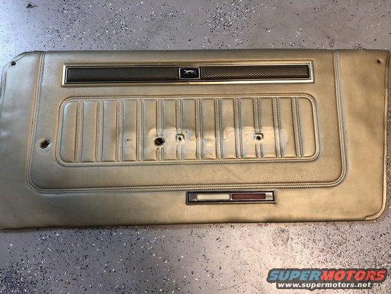

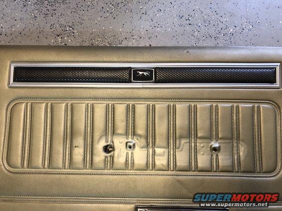

Here is a picture of the panels and the small tear I mentioned.

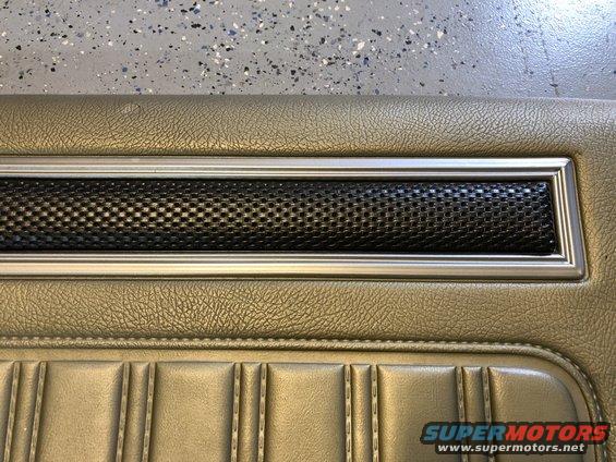

Here is my take on the color change. I decided against trying to duplicate the chrome since my cluster is painted as well. I used SEM paint and the basket weave is not black but more of a charcoal color.
The panel will eventually be black but waiting to color that until I get the backer boards to replace.
Nice black panels are hard to come by, but the colored ones even more so. Yours seem pretty easily repaired, it seems a shame to paint them.
I have kept eyes peeled for good black panels since I have had the car and I have yet to find an acceptable pair so I have held off on this part of the project until now. Finally decided Im probably going to need to paint them to get what I want. Thought about custom panels as well but those can get expensive to have made and not look like I did it myself. I do not believe my door panels would be worth all that much in their current condition to justify selling.
These panels are pretty discolored. I have scrubbed the crap out of them to get all the funk off and while clean they are still discolored. The photos may not show it but they are much darker then they should be I believe for the light ivy gold interior. Areas unexposed to the sunlight are much lighter then those exposed along with having lots of scuffing around lower sections from peoples feet.
