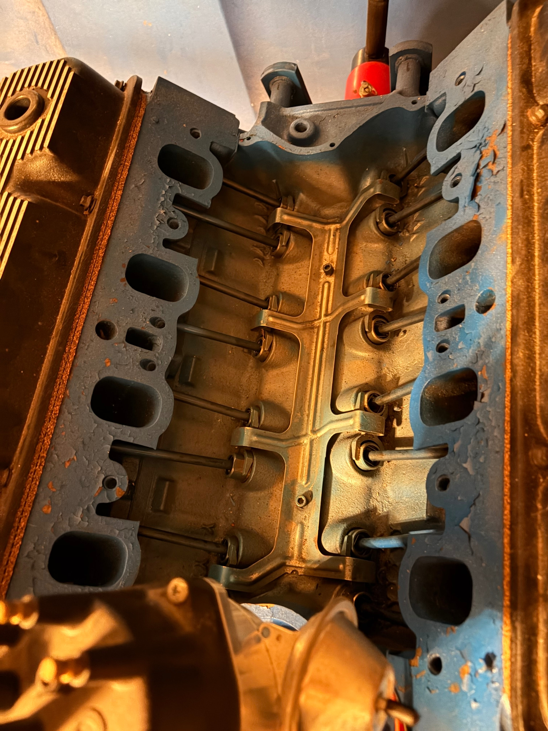

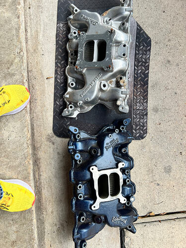

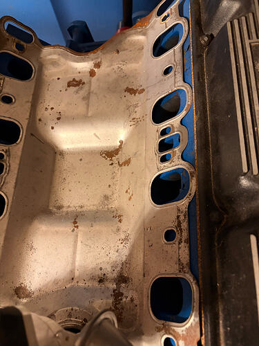

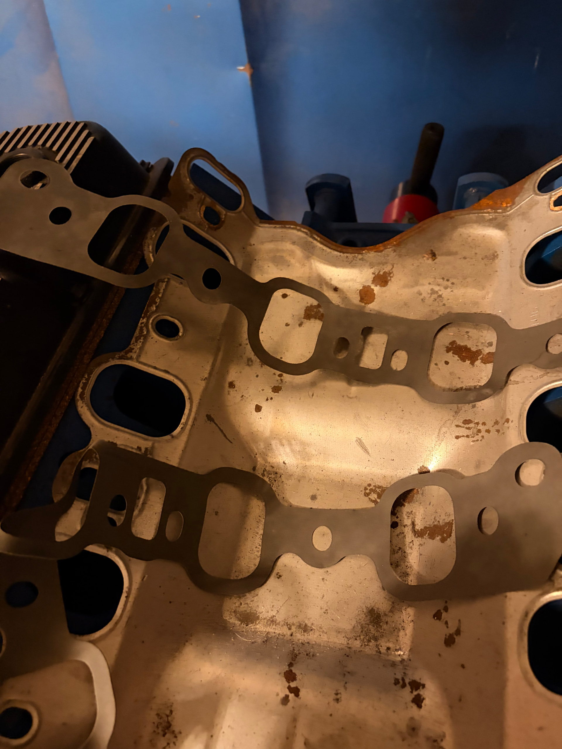

So if I am going to use a flat carburetor lift plate, I need to attach the intake manifold. I have not done this before and this is what I got. Any suggestions or tips? Any good video suggestions on how to properly install the intake manifold?
