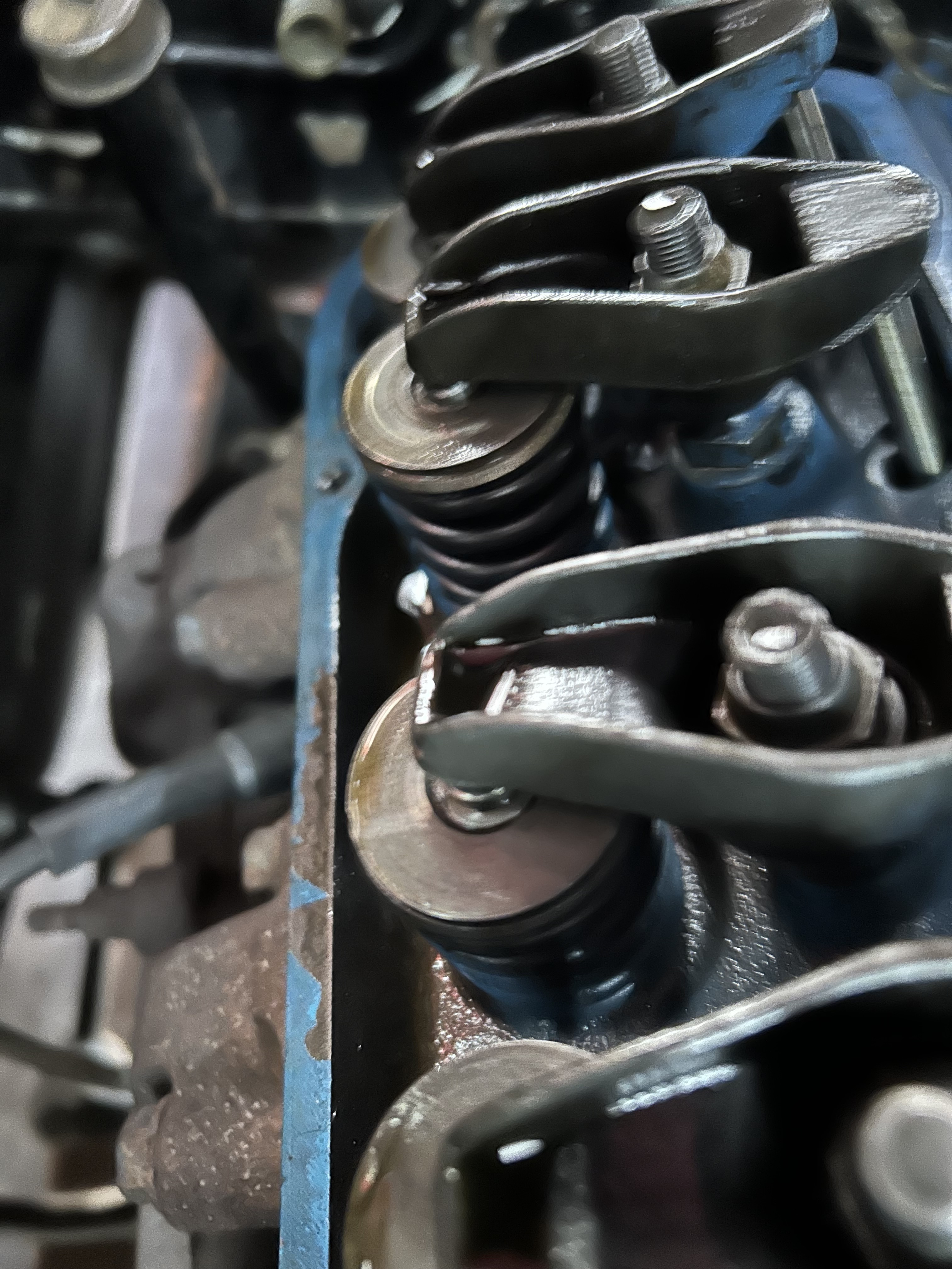

Now I find poor rocker arm alignment
The studs are screwed in so guide plates are probably in the future

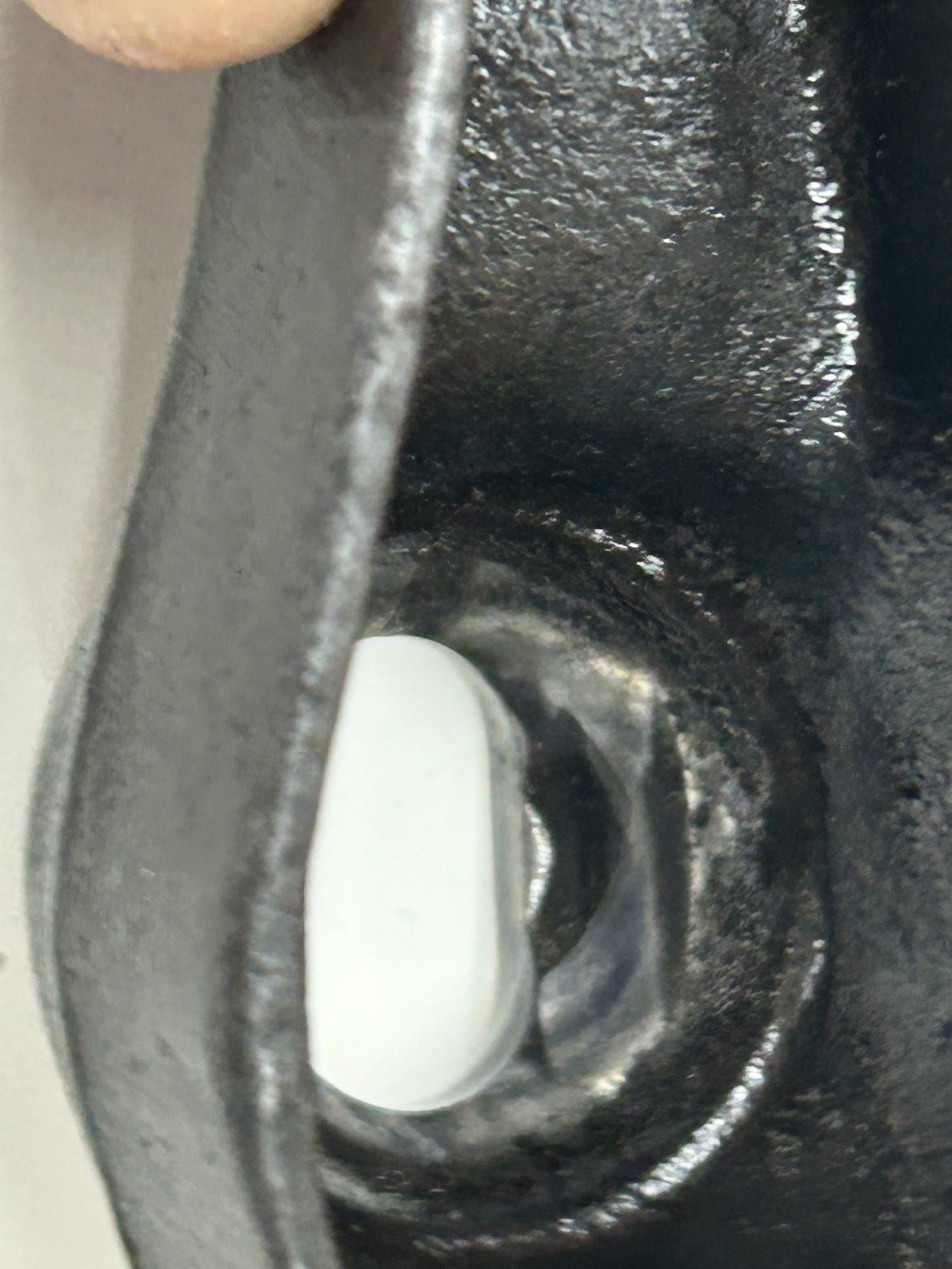

And then this:
Well this doesn’t look good
Funny wear pattern inside the rocker

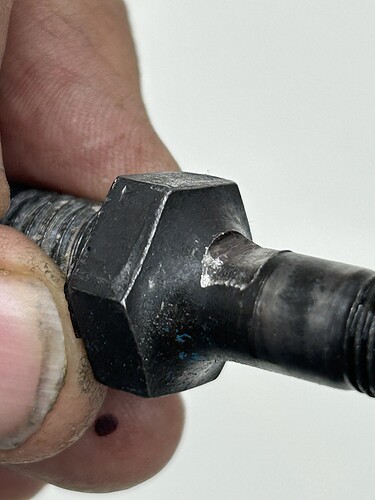

And then it gets worse. The fulcrum has worn a deep groove in the stud.

I pulled the rocker covers and found a bent and partially broken push rod. I pulled it and replaced it and reset the lash and fired it up. It started to develop a light tap and I shut it down. The replacement push rod was bent and the rocker arm was way out of alignment. Hmmm…
What I discovered next was that whomever installed the screw in Studs had most likely done it by hand. They were all crooked to one degree or another. This had caused some wear in the push rod alignment slots and it was allowing the rockers to rotate out of alignment with the valve stem. Crapola.

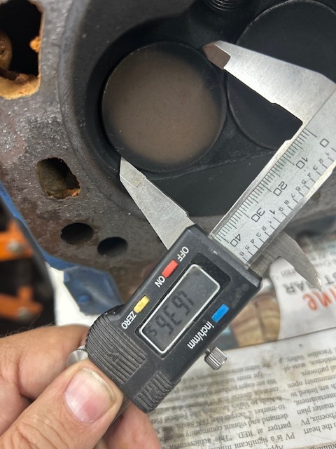

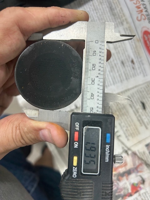

SO on the bench I started pulling the springs. I did not flip the head over right away but when I did I discovered something I did not expect: huge valves.
This is a 1.94 intake
And 1.64 exhaust

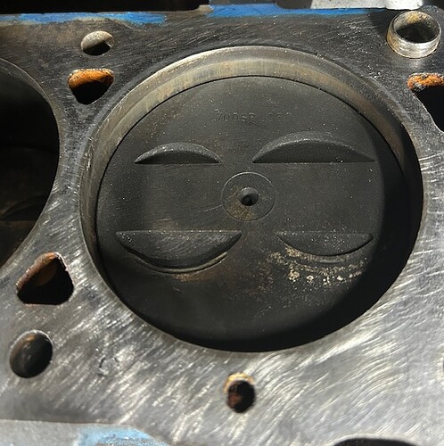

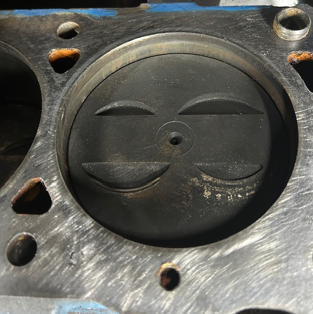

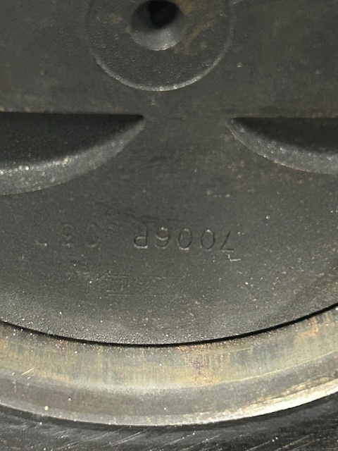

And the pistons were also not what I expected.
I think this is a Sealed Power 7006P .030 over.
289 engine 4.030 bore x 2.87 stroke
old#7006P30—new# L2218F30
Forged street piston 293CI @.030
compression 9.68w/54.5cc,9.24w/58.2cc,9.00w/60.4cc,8.73w/63cc,8.17w/69cc
compression dist.-1.602
clearance-.014 deck, .005 skirt
flat 4 relief
rings-E-251K 30 sealed power moly, R-9903 30 Speed Pro plasma moly std.fit
R-9343 35 Speed Pro plasma moly file fit
5/64,5/64,3/16
pressed or floating pin
I think they will be okay with the heads I have
They were only made in 1968 and have a 4-v stamped on them. Chamber size is 52-55 cc, intake valve-1.773-1.788, exhaust valve-1.442-1.457. Compression ratio in theses engines ran 10.5/1.
