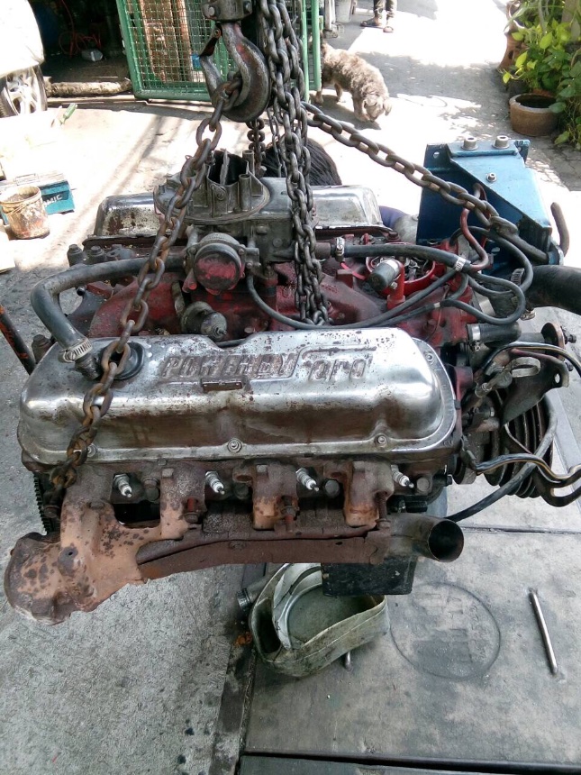

I am not sure that my engine is cleverland or windsor. Like this picture.
That looks to be a Windsor. The upper radiator hose comes out of the intake manifold not the engine block . A picture of the front, kinda of top view will help confirm.
Can i use same carb in windsor and cleverland?
Yes, you can use the same carb on either. And as Allen said, a top and front shot of the engine showing an unobstructed view of the upper radiator hose will help us a great deal in helping you identify your engine. But from all appearances, it does look to be a Windsor.
Upper radiator hose, valve covers and exhaust manifold heat shield confirm it is not a Cleveland.
