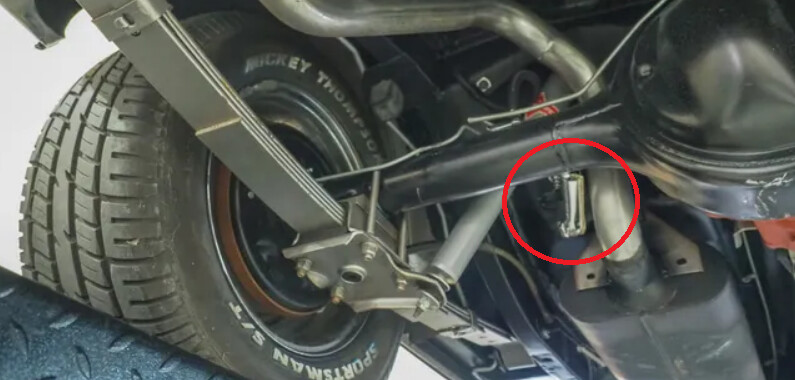

Ouch:
Is there something ‘here’ that I’m not familiar with ?
What is this ?
A pair of vise grips?
someone did a lot of “detailing” on the rear end housing, but it looks like they scratched it up using a floor jack.
Need I say more?
Not even the correct power window switch bezels
Pretty poor restoration in my view.
