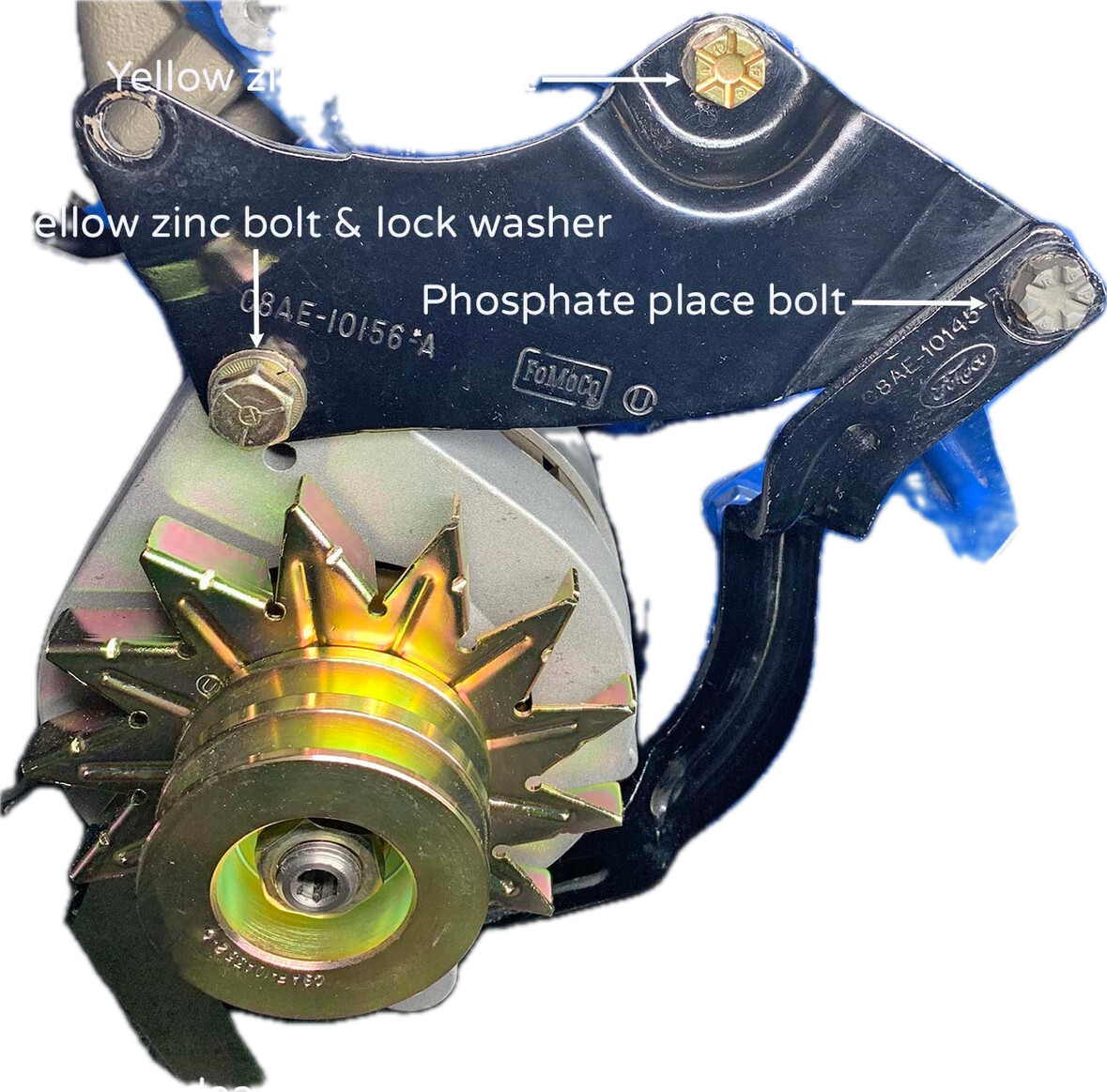

The stock mounting for a 68 S code alternator is low, below the smog pump. That is how I have mine mounted but it is a stock alternator on stock brackets. Here is a photo from deadnutson
I don’t know about the fit of that kit or aftermarket alternators but there are stock brackets for the low mount position. They are generally pretty spendy.
All the 1968 Cougars that I have owned are low mount alternators. That’s where every 427 and 428 is.
