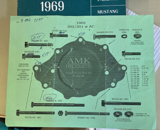

What is the recommended torque for the three long bolts at the bottom of the water pump indicated with numbers 1, 2, 8, 9 on attached image? I found 12 - 18 ft lbs is recommended in general. Is that the same with the long bolts? This is on a 1969 351 Windsor with AC and PS. Just adding pully brackets for AC and want to make sure I have this correct.
The torque is based on the thread size, not the length unless there is a special callout in the service manual.

Yes. The bottom bolts are long winded and hard to get the threads to start. And they are very skinny bolts that would suck to break. Service manual and Osborne Manual do not get very specific.

All the bolts torque the same. The AMK guide is a huge help, but I’d recommend the 69-70 assembly manuals and a copy of the 69 engine assembly manual.
