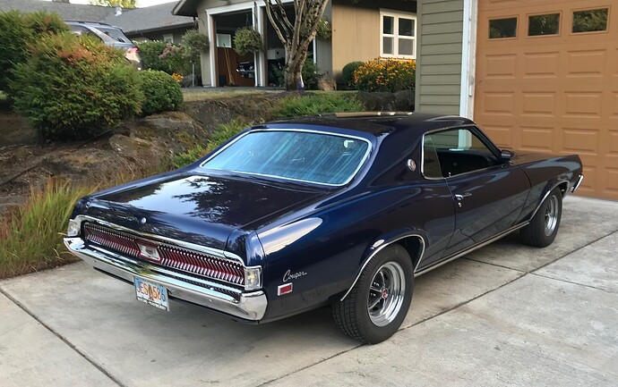

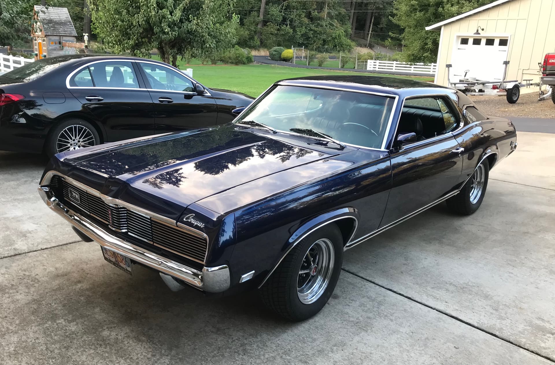

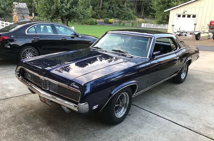

Hello all,
Looking to put Magnum 500 rims & BF Goodrich tires on my 69 Eliminator.
Who makes a quality Magnum 500 wheel now a days? Was told by a reputable Cougar parts supplier that they are all “Junk” anymore. I was thinking about Wheel Vintiques brand but still not sure.
Specialty Wheels used to be here in Portland, OR and they were nice rims, they moved to California several years ago and I’ve been told they are no good.
I want to go with 15 x 7 rims, 235/60R15 tires on the front and 255/60R15 on the rear. Would this be a good combo? The car has been lowered about an inch all around.

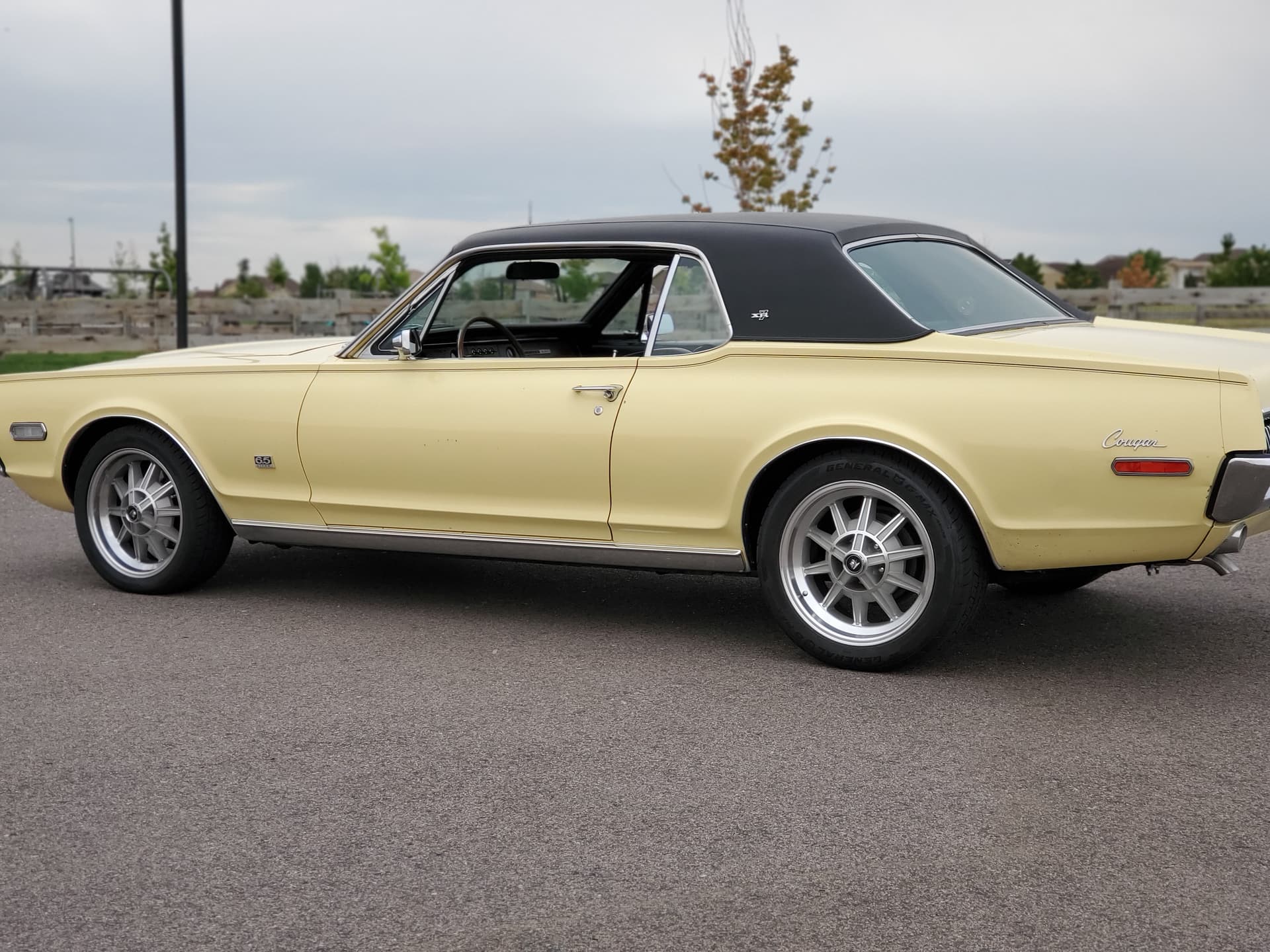

I’ve had good luck with the alloy version sold by Holley under the Legendary Wheel brand. Plenty of 15 x 7 options. Check what offset you need/want. On the front of my ‘68 I used 15” x 7’‘ with 4.25” backspace.

That’s a beautiful car! Thanks for the response.

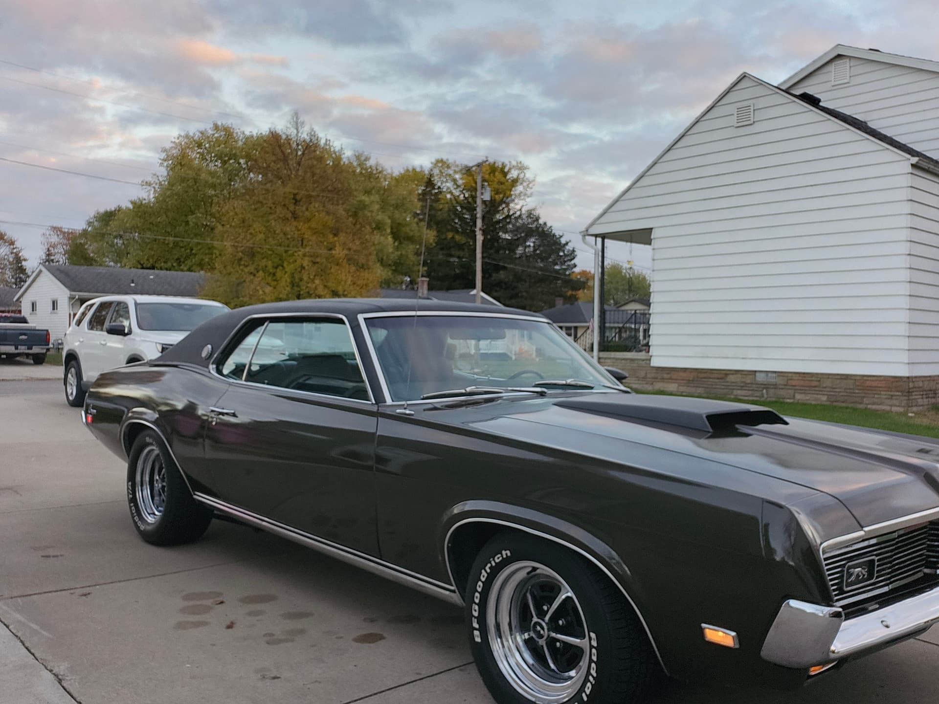

I am running 15 X 7 Magnums that came with the car on 235/60 Cooper Cobras. Not sure of the manufacturer of the magnums. I am not getting any rubbing on the front fender so far even with the additional height of new tires.
It is actually blue.
