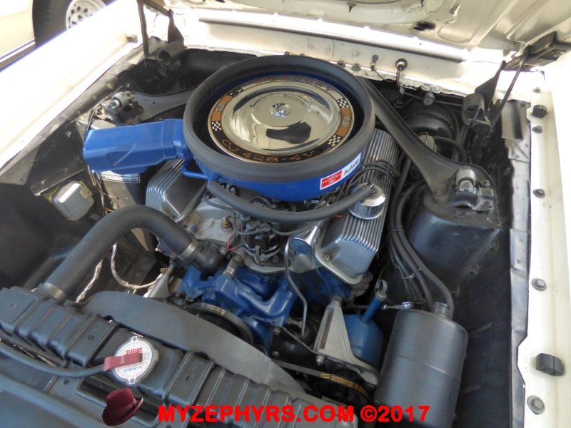

Yes it’s been done by Bob on Isabel. Here is the link and a picture. You stated 351 but did not say Cleveland or Windsor. Bob has a Cleveland built to 408 ci.

I missed the w in your post designating Windsor. I’m sure the same type of set up will work regardless of the engine type.
A hole in your hood, some garage door seal, and a lid that leaves the element exposed will work if you don’t care how it looks & are OK with always drawing in outside air.
If you want it to function as the factory RA did (only drawing in outside air under full throttle), you’ll need the RA air cleaner lid & vacuum-actuated flapper doohickey.
