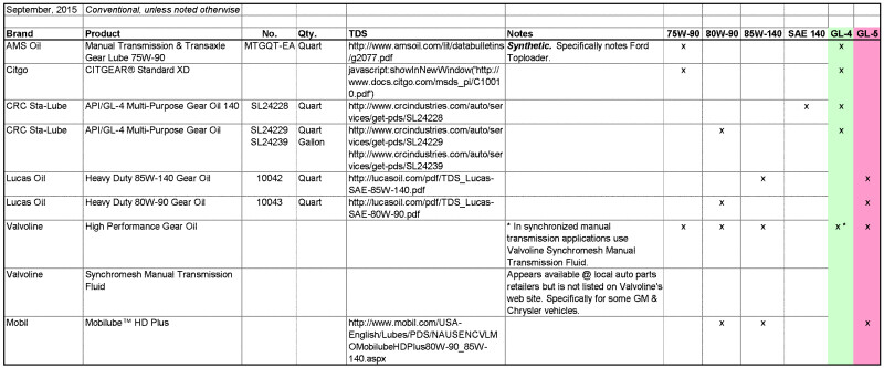

Thanks, Mike, I’d forgotten about the GL-4 / GL-5 thing. As it turns out, this is more difficult than I expected. I researched a lot more brands than shown below, but it seems to come down to GL-4 is only available in the lower range or high single viscosities:
All of the 85W-140s are either GL-5 or synthetic or both. I’m seriously tempted by the AMS Oil product, but want to use a conventional formulation. Citgo doesn’t seem to be easily available in my area so I’m going to try the CRC Sta-Lube API/GL-4 Multi-purpose Gear Oil in 80W-90 weight, which my local NAPA has in stock.
