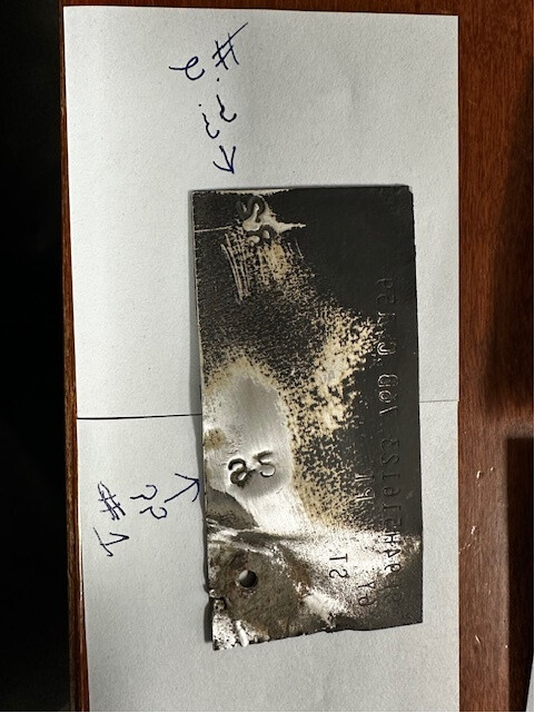

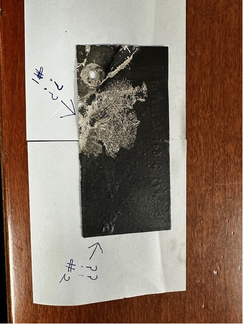

Post the information on the buck tag. Some.of those options will appear on that
buck tag info is below
vin number 76B C 159
6Y PT
ST
then it looks to have 72 or 92 in two random locations
6Y is the interior color. PT = Power Top - it is a convertible. ST = Stereo Tape player - the car originally had an AM radio with Stereo Tape player - an 8 track.
…and no PW, PB, or AC means it didn’t get built with power windows, power brakes, or air conditioning.
Any idea what the 159 mean?

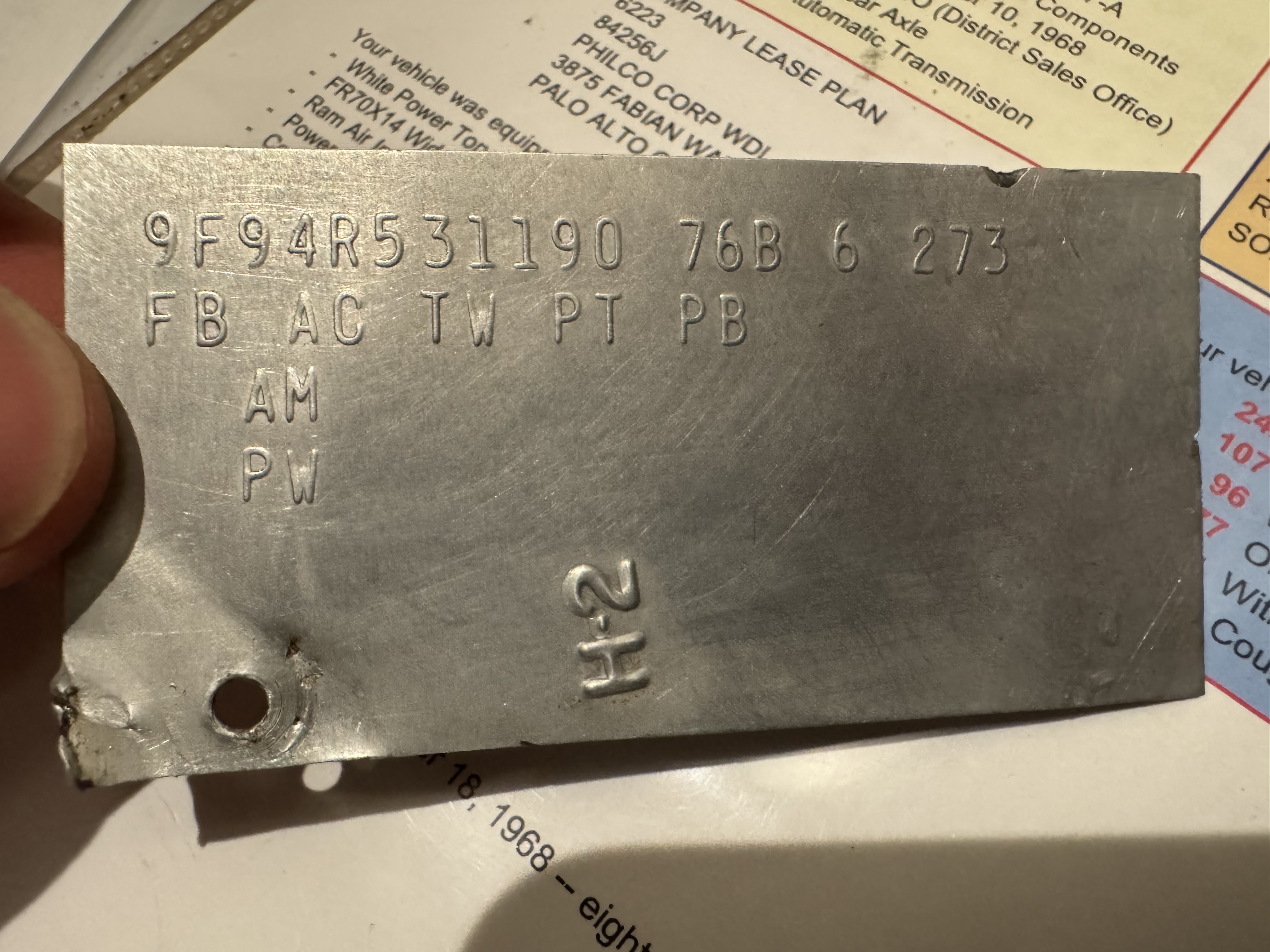

Here’s my buck tag for reference with AC, TW, and PB listed.

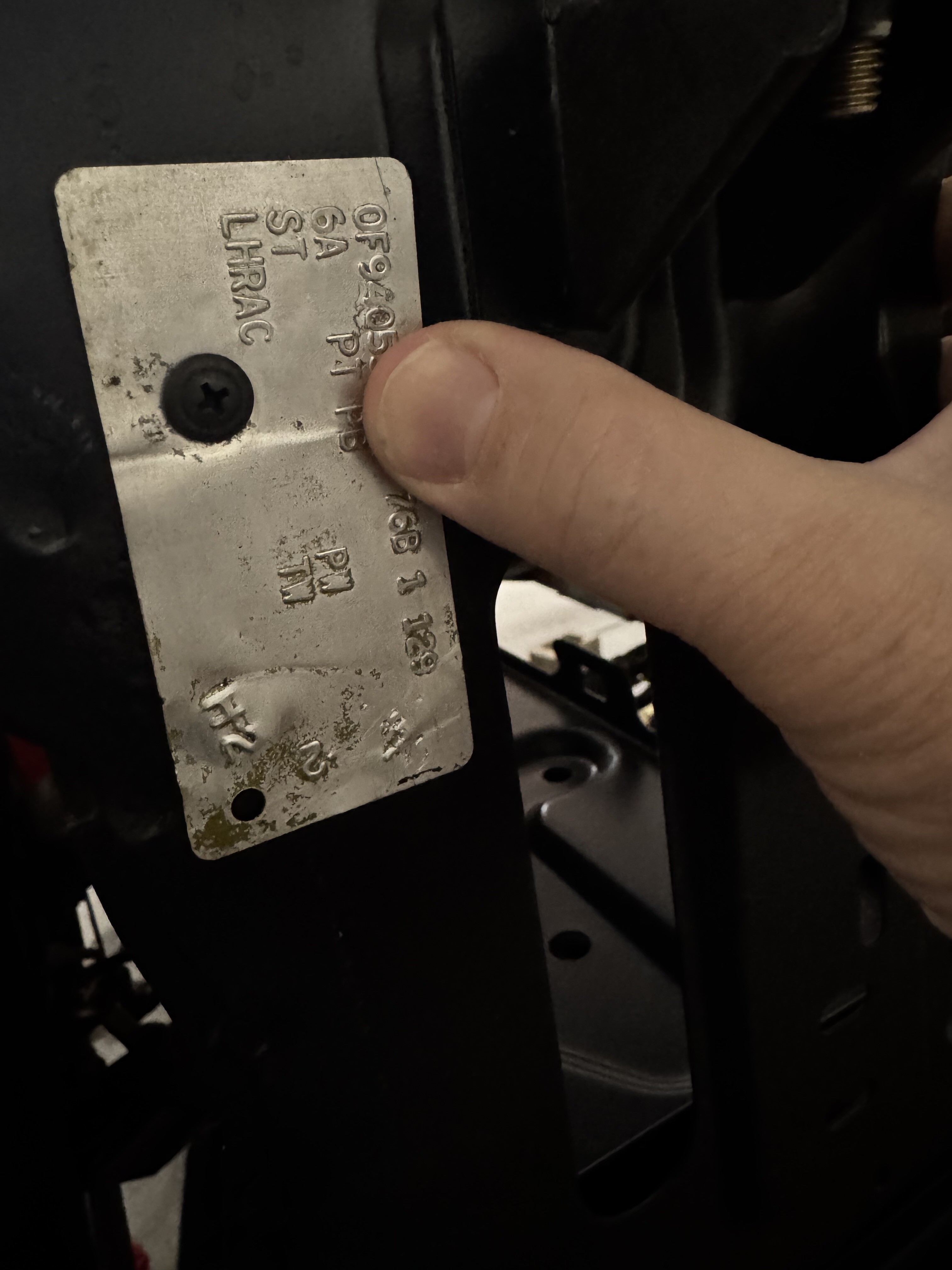

Probably the rotation number. The rotation number on this is tag is129

H2 is a common stamp. It was done after the Buck Tag was imprinted. I think that it is an inspection stamp of some sort. It is always wonky on the tag.
Looking closer at #2 look like it could be R2 from the back of the tag. Not sure if R2 could be an option. On #1 I can’t make out heads or tails.
Any ideas on how to get the paint off without causing more damage to the tag?
