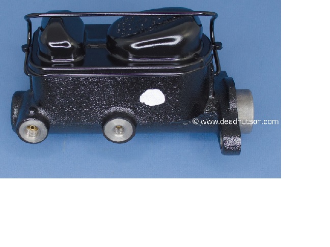

If your Cougar is 1967 - 1971 then the master cylinder should be ( provided it was for the disc-drum brake system original to the car, or swapped into the car from another Cougar or Mustang ) C8ZZ-2140-A. If it was a 1967 ( up to 2/6/67 ) then it could be a C7ZZ-F. In any case it should look like:
Image from Dead Nuts On website : 1969-72 Mustang & Shelby Master Cylinder with Cap | Dead Nuts On
PDiB Master Cylinder
If the master cylinder is original ( Bendix ) to the car, then it would have their 2227161 number cast into the bottom of the reservoir.

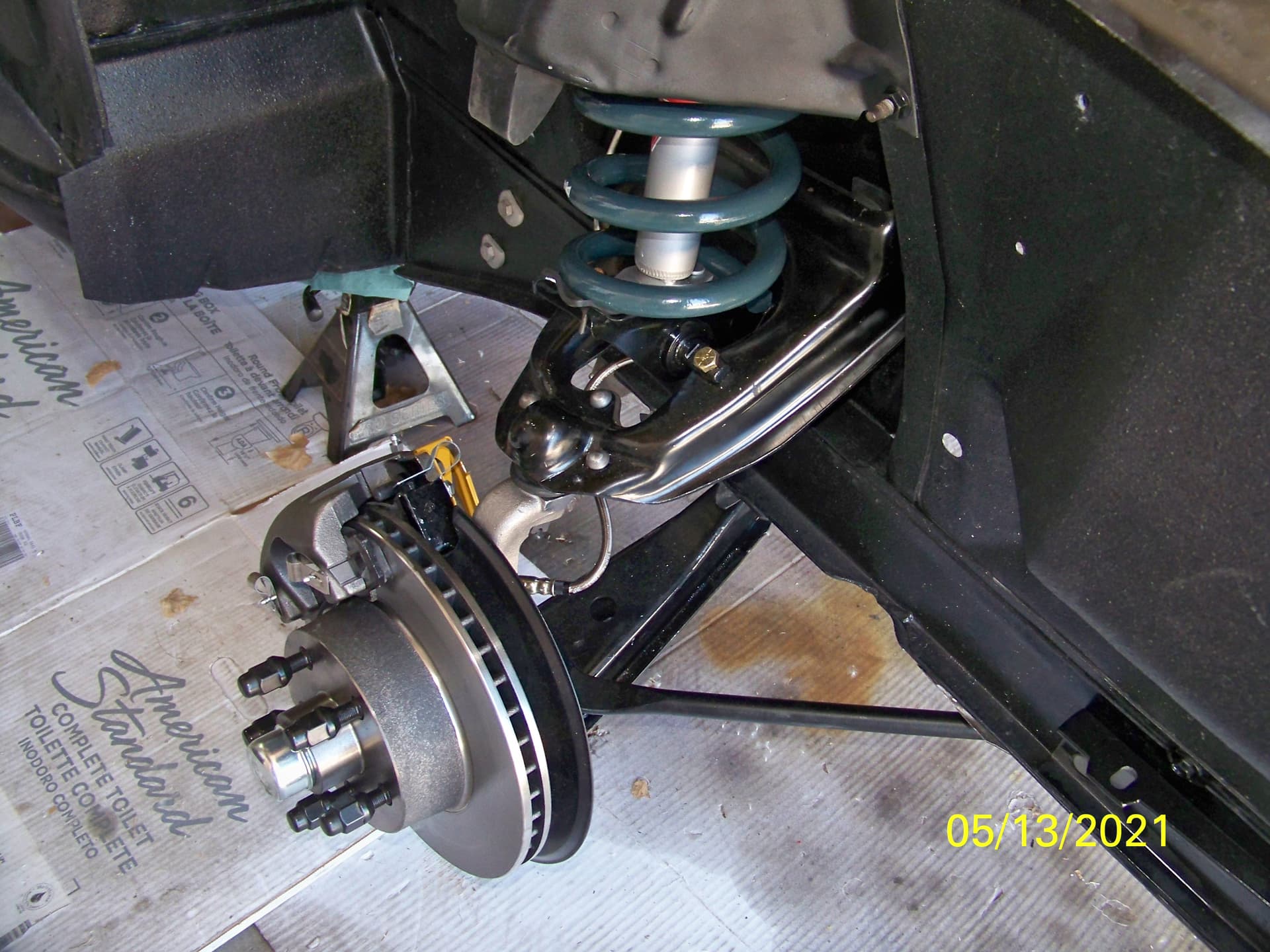

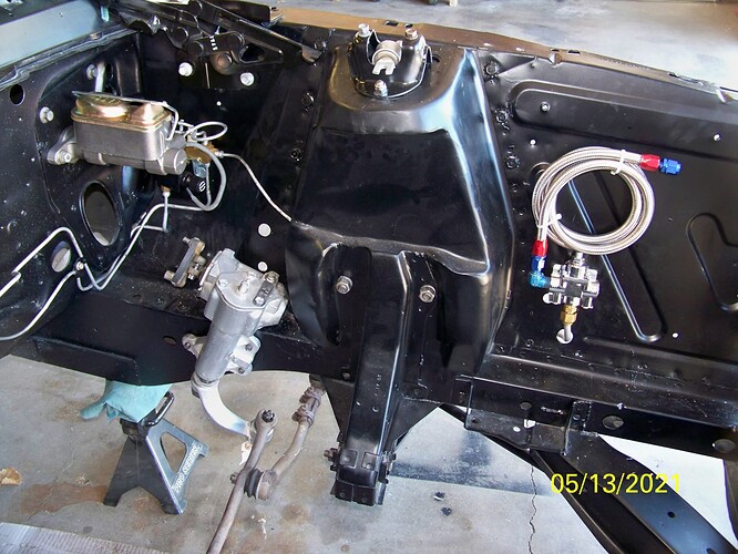

So to clarify. The Cat is a 69 XR-7 convertible. It came with factory front disc /drum rear. Someone put a disc brake rear conversion and never finished it.
I an in search of a cast iron master cyl (not alum aftermarket) that will bolt upto the factory booster.

Keeping everything factory except the conversion to the rear axle, IE disc for all 4 wheels, thus the need for the correct master cyl for the 4 wheel disc setup/conversion now on the Cat.
Im not going back to factory, as they have most everything done cept master cyl which is the wrong one for 4 wheel disc…

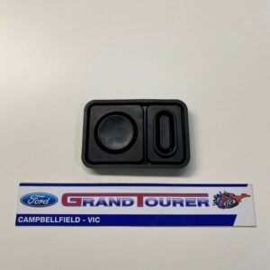

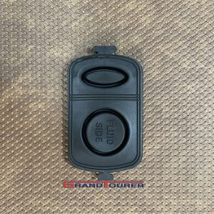

Australian Falcons from 1970’s, with four wheel disc brakes, had a master cylinder with different sized reservoirs. 1" bore size.
Disc drum seal
4 wheel disc seal
Basically the same size. 4 wheel disc switched to plastic fluid reservoir
