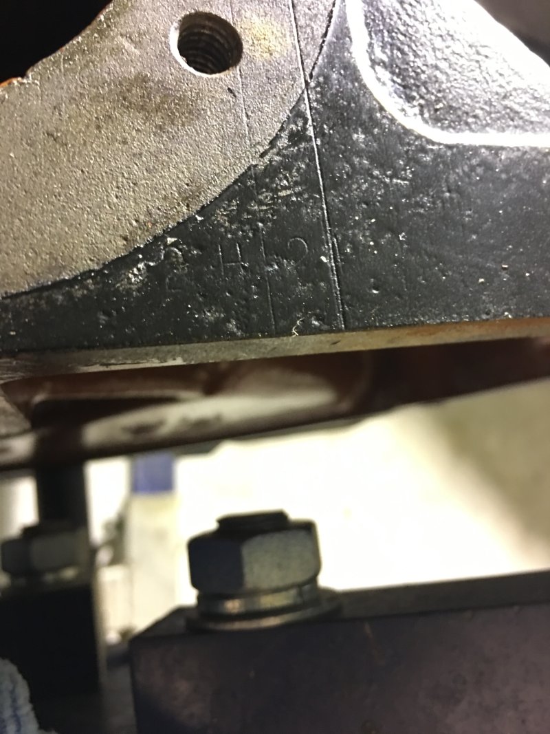

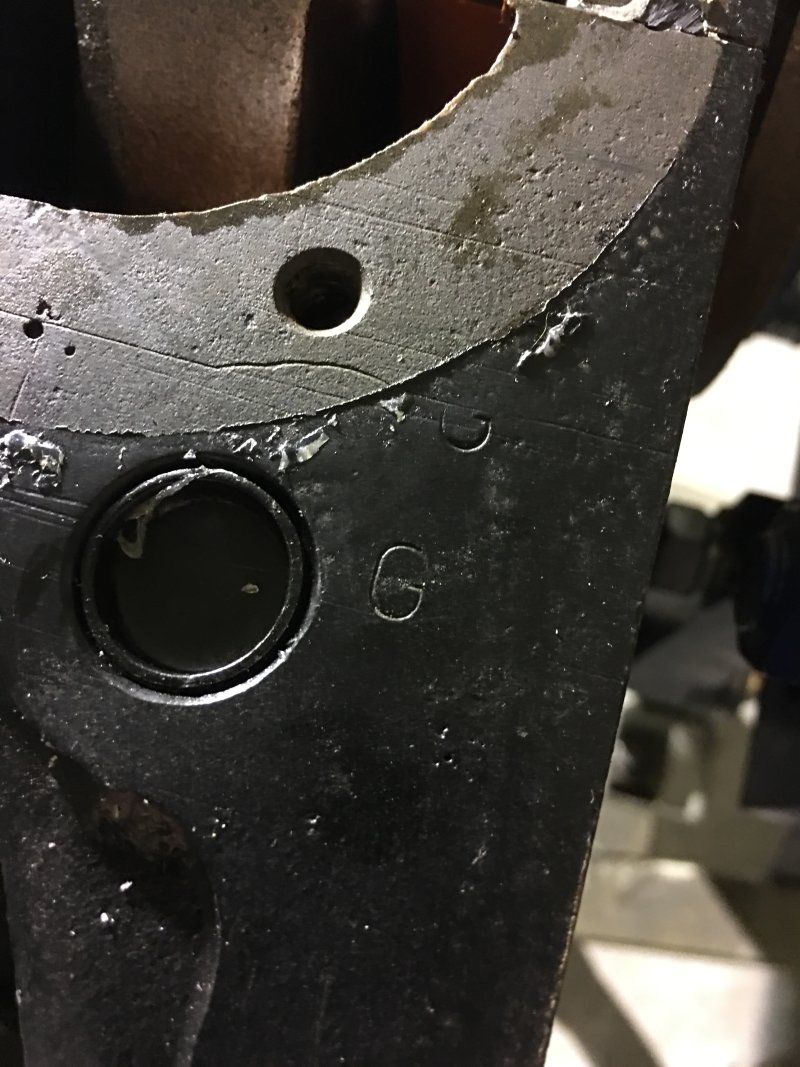

Wonder what the two “G’s” mean. Just kinda stamped with no thought of angles or other numbers?

These are from a 406 cast in July 62 with a August assembly date. I have seen the Gs on another GTE Block also, it was the boodieman car where ever it ended up. I’ve only seen them on high performance blocks so far.
The “G” was most likely stamped twice because the first attempt was poorly striked.
Chris is correct, my GT-E W-code block has letters stamped on it. I know there is a “D” stamped on the top of the block. I’ll have to look at my block later to verify, but there were several stampings on the block mostly at gasket interfaces.

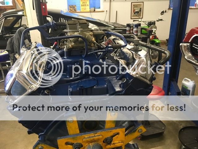

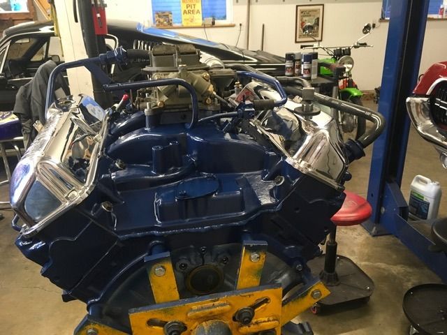

Motor back together. Mocking up the front of the motor and specifically the smog pump. I was provided a smog pump by the guy who bought the burned up GTE originally. I feel the smog pump is not correct. Where can I find a reman correct smog pump for sale or a core to buy and rebuild? I see a couple on Ebay. Can someone provide a picture of the smog pump mounted. I have the correct alternator bracket for the smog pump above the alternator. Does it have a tensioner bracket? Also would love a shot of the tensioner bracket for the alternator.

No tensioner bracket. The upper bracket is unique as the adjuster slot is twisted to horizontal and curves over the top of the pump. I would make the smog system non functional. Remove the vanes from the pump and plug the ends of the tubes in the heads and vacuum hose. It looks functional but won’t rob power and the tubes won’t burn at the heads.
The adjuster brace is same as CJ, Rob, as is the whole system except for the pump pulley. I think it’s a little larger, and hard to find.

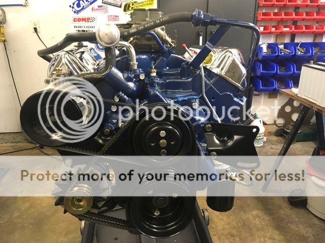

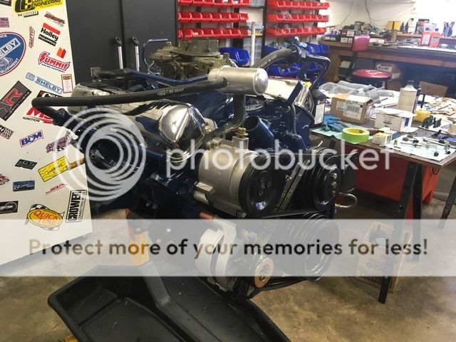

Mock up of the front of the motor and the smog system is complete. Correct white fan smog pump and huge thanks the West Coast Classic Cougars for most of all the parts. Still need a smog pump tensioner bracket if you have one! Plan to land the motor on Tuesday!

Looks pretty good. A couple things could be better:
I wonder about the booster line. Most of the stuff on this engine were original to the engine. All of the PCV fittings were present and intact.
Oil pressure gauge is my liquid filled “start up” gauge. It will be removed after start up.
Rob
That’s the one that was used on Fairlane / Comet in 68 - 69 and Mustang / Cougar in 69 / 70.
Forgot to add, the alternator fan should be zinc dichromate, not black.
