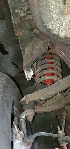

This is a very nice looking Cougar but looking at the front end in images 7842 and compared to image 7841, the side shown in 7842 has considerable amount of rust compared to 7841. The coil spring shows significant rust as well as the coil spring cover. At this price, I wouldn’t expect this but its not my money.

Drivers side spring, spring cover and upper control arm. Not rusty, but a little dirty
D.S.
P.S.
D.S. lower control are, it is a replacement and has surface rust on it. Note P.S. lower control are is the same. Personally I see this as a minor item. If I has done the replacement I most likely would have detailed it and clear coated the natural areas.
D.S. Strut area has ATF on it. So I think the P.S. pump has a leak.
D.S. Spring cover detail.

P.S. Spring cover, spring and upper control are. Note the Red hue is due to a Poppy Red 65 Mustang parked next to this car. Again the lower arm has surface rust.
