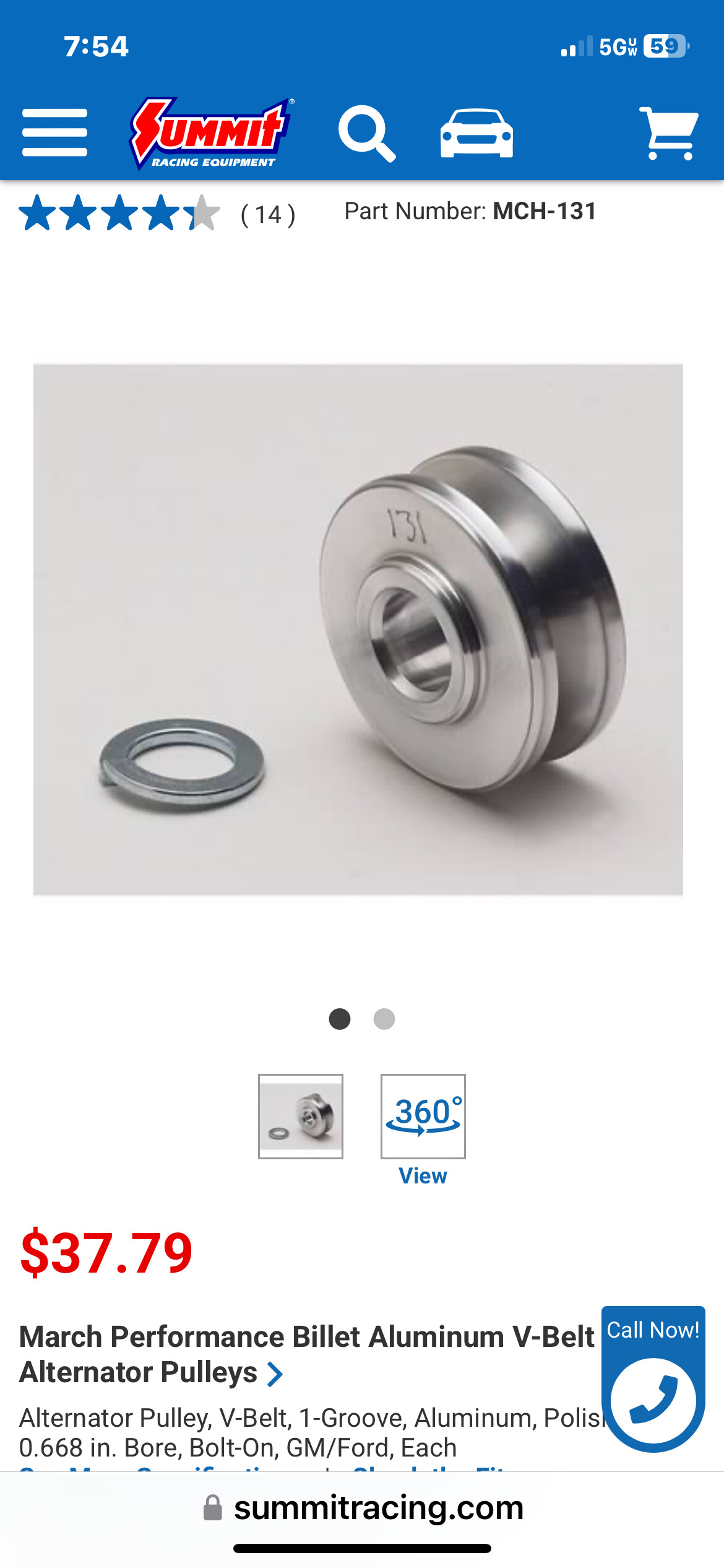

Here’s an option I found that helped my power master because I had an underdrive crank. The 3:1 ratio is dead on
