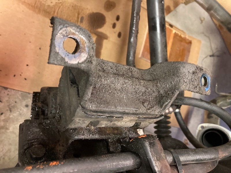

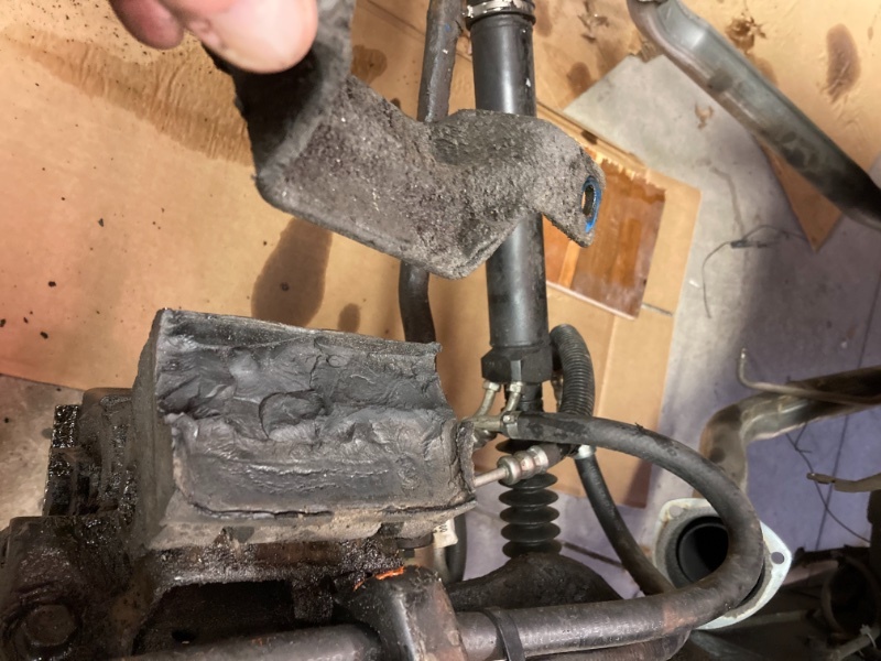

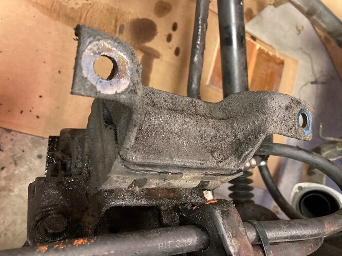

I have a broken motor mount and looking to buy new set. I read on WCCC that for ‘67 you either have to get new frame stands or modify aftermarket motor mounts.
Question is
How difficult it is modification?
Will mustang mounts work?
Any info appreciated.

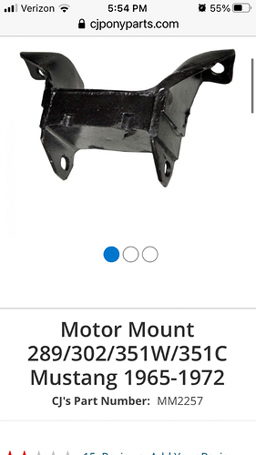

Sure Mustang mounts are exactly the same for '67 small block. You can’t buy any and no one makes any.
Funny many venders say they do but they apparently don’t work from what I read.
Why knowing sell parts that won’t fit years specified.
Annoying
CJ Pony Parts is the worst of the worst. To use those isolators you will need a set of '68 frame stands.
It doesn’t mater where you get “New” isolators you will need the 68 and newer frame stands. If your lucky you may find the earlier isolators used or NOS.

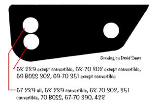

Another option is to weld up and redrill the 1967 motor mount plates to match the 1968 motor mount plates.
Four holes, 1/2" down from the originals are required.
