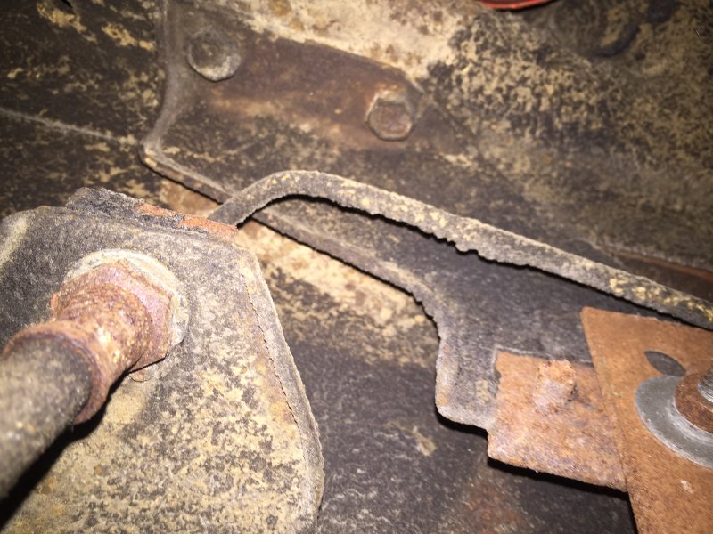

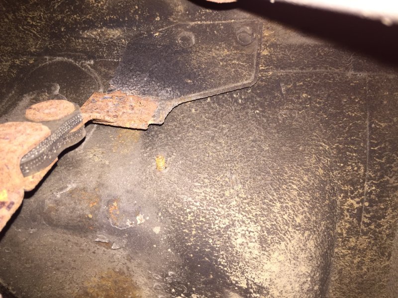

Thank you for all the responses. I’m not doing a concours or show car, but I am trying to use original Ford everywhere I can and get everything back to how it should be. My car is a “late build” 1968 dual exhaust, which is after 11/1/67 according to the WCCC website. So here are the upper brackets that are on the car now:
drivers side
passenger side

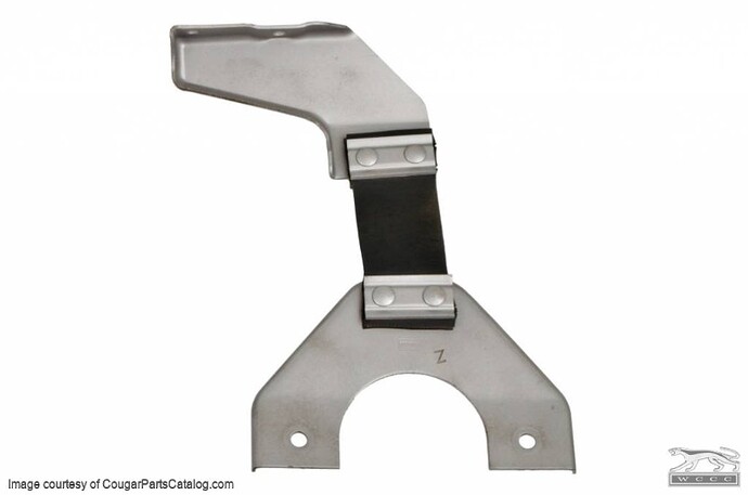

These are the correct late build upper exhaust hanger brackets from what I can tell comparing the pictures of complete dual exhaust brackets on WCCC:
drivers side
passenger side

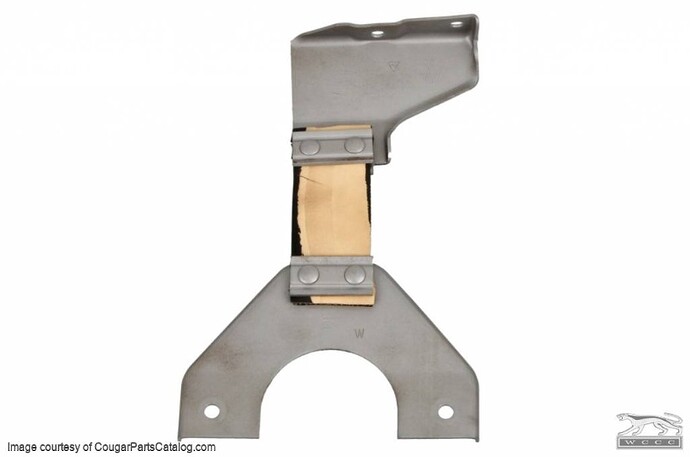

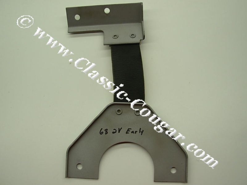

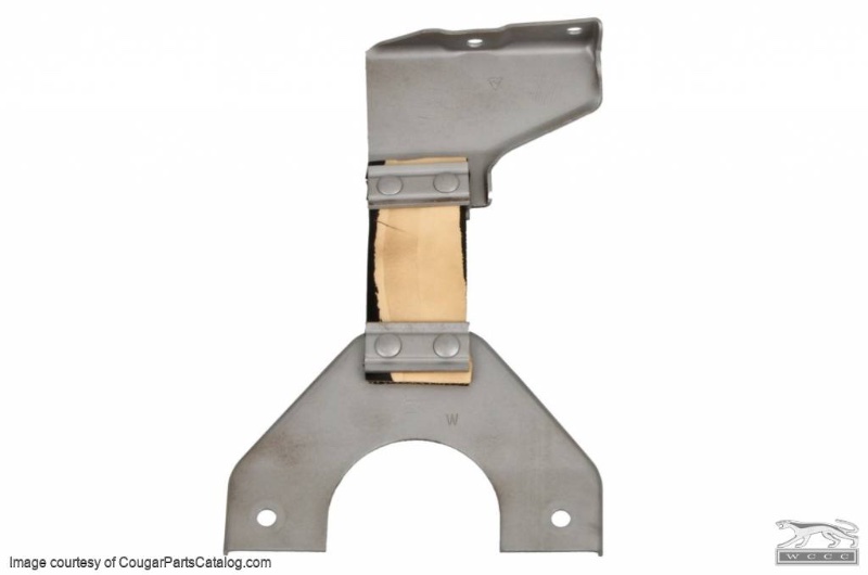

What I’m asking is this: Can I use the rubber and lower bracket from this, a single exhaust hanger, to make a complete set of original and correct dual exhaust hangers? Seems like all I would need is a couple of rivets on each side to attach the rubber and lower bracket to the upper bracket. Thanks again.
I don’t see any reason why you can’t do that. I would give it a try.
