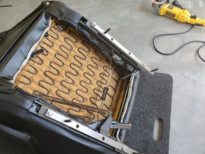

  3. Installed the CJ Pony Parts seat extension to give me more leg room as I’m 6’3". Install was fairly easy and did provide a bit more room.
