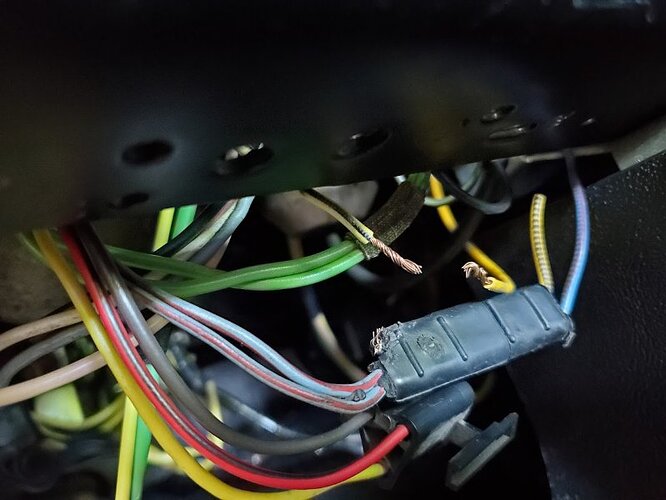

  • Installed a small power distro unit from eBay (12VoltConnection)…nice compact unit (3 switched power, 1 constant power, 3 relays). Used it to power the tach, ammeter, choke, supply 12 volts to the new Pertronix coil, and a spare circuit in case I upgrade the radio. GEP Universal Pre-wired Waterproof Mini Fuse Relay Panel Box Holder 80 AMP 12V | eBay
  • Fixed a couple of previous owner wiring hacks…looks like it was limited to the radio as he probably had an aftermarket in it at one time

It was a pain getting the gauge cluster back into the dash…not a lot of room to get your hands in there to reconnect the wiring harness. I may have to pull it back apart slight to check on the left turn signal light…I verified all lights worked before bolting it in, but may have knocked it out of the hole when reinstalling.
