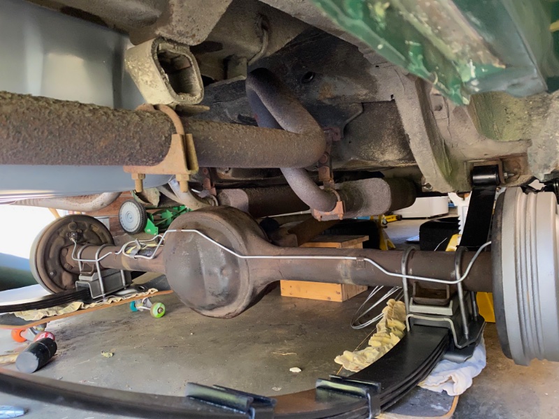

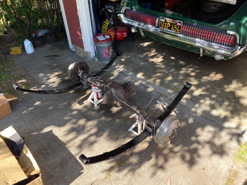

After cleaning a lot of crud and dirt off the axle and differential, I assembled the new leaf springs onto the axle. The leaf springs were installed with Mustang hardware previously, so every piece of the mounting hardware was missing. I pieced it all together over the last few months.
I rolled the whole assembly under the car (neglected kids skateboards are the perfect height) and loosely attached the front eye bolts.

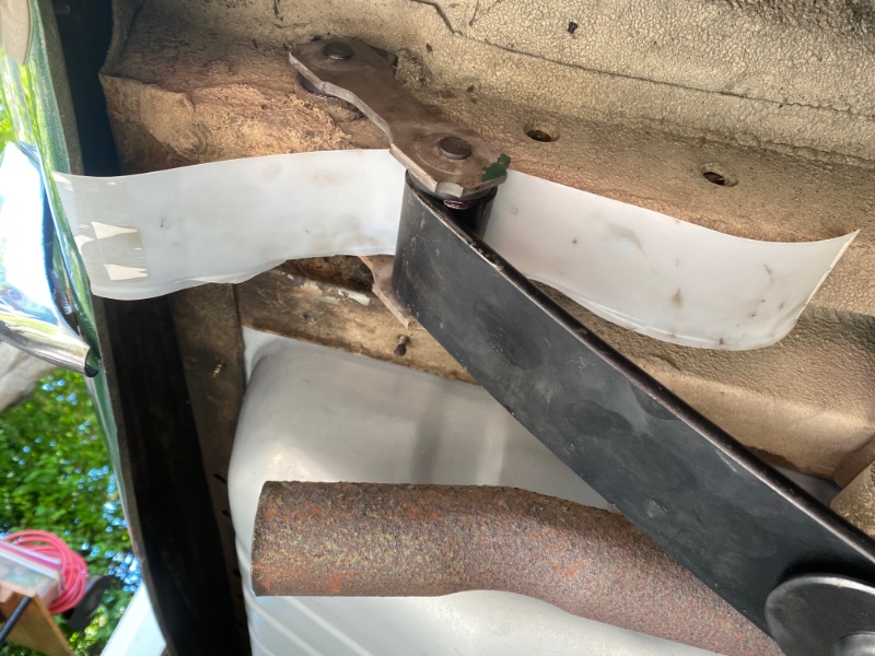

Next I used my floor jack to raise the whole assembly until the rear eyes were almost in contact with the frame. Then I slipped a strip of plastic milk jug between the spring and the frame.
As I raised the floor jack, the spring compressed and slid backwards along the frame until I was able to attach the shackles.
