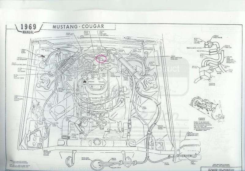

I’ve attached a couple of images, one of the actual part ( with the blue stripe vacuum hose attached ) and another image from the Jim Osborne assembly line ( reproduced ) pages showing its location - up near the firewall, and in the line coming from the manifold and leading into the actual speed control regulator itself.

This ‘mystery’ part is indeed called out in the 1965 to 1972 Master Parts Catalog.
I have attached a copy of the page for you that shows the part number of C9ZZ-9D860-A
and the description of, Hose and Muffler Assembly for a 1969 Cougar w/speed control.
If you had contacted Don and the guys at West Coast, they probably would have gave you the same information.
In fact, it is listed in their catalog for about $60
I suspect its use was to control noise and the flow rate coming from the regulator to the servo.

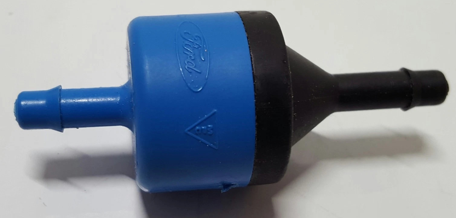

If I was not able to obtain a New or used one, I was contemplating substituting one of these ( a Ford distributor check valve - of course removing or puncturing the intenal one-way rubber membrane ):

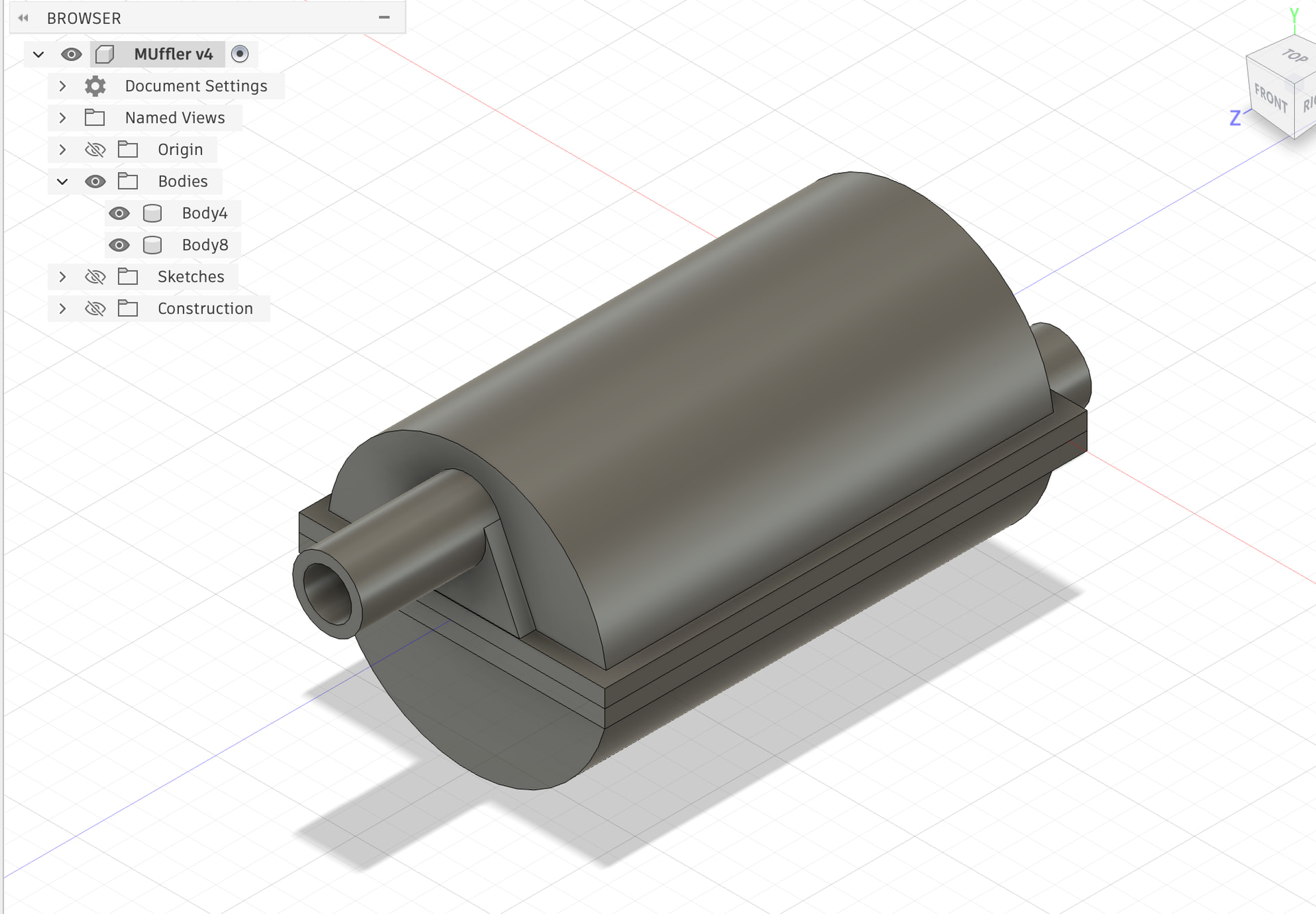

I’ve been continuing my research into this elusive hose and muffler assembly (C9ZZ-9D860-A), and I’ve actually started working on a 3D CAD model of it using the photographs and limited measurements I’ve been able to obtain.
I didn’t realize you were also still searching for one! My goal is to eventually reproduce the part, hopefully as a functional replacement, since originals seem nearly impossible to find.
Unfortunately, I haven’t been able to determine exactly what the internal construction looks like. I’ve been trying to track down additional photographs, measurements, or even an original that I could 3D scan.
I think your explanation of its purpose as an acoustic muffler makes sense, especially given its connection to the speed-control system. I’m hoping to eventually figure out how Ford designed the internals so the reproduction functions like the original rather than just looking the part.
I’ll attach a picture of my preliminary CAD model. If I make any significant progress, I’ll be sure to share it here.
Hopefully, we can get a few more of these systems complete and operational!

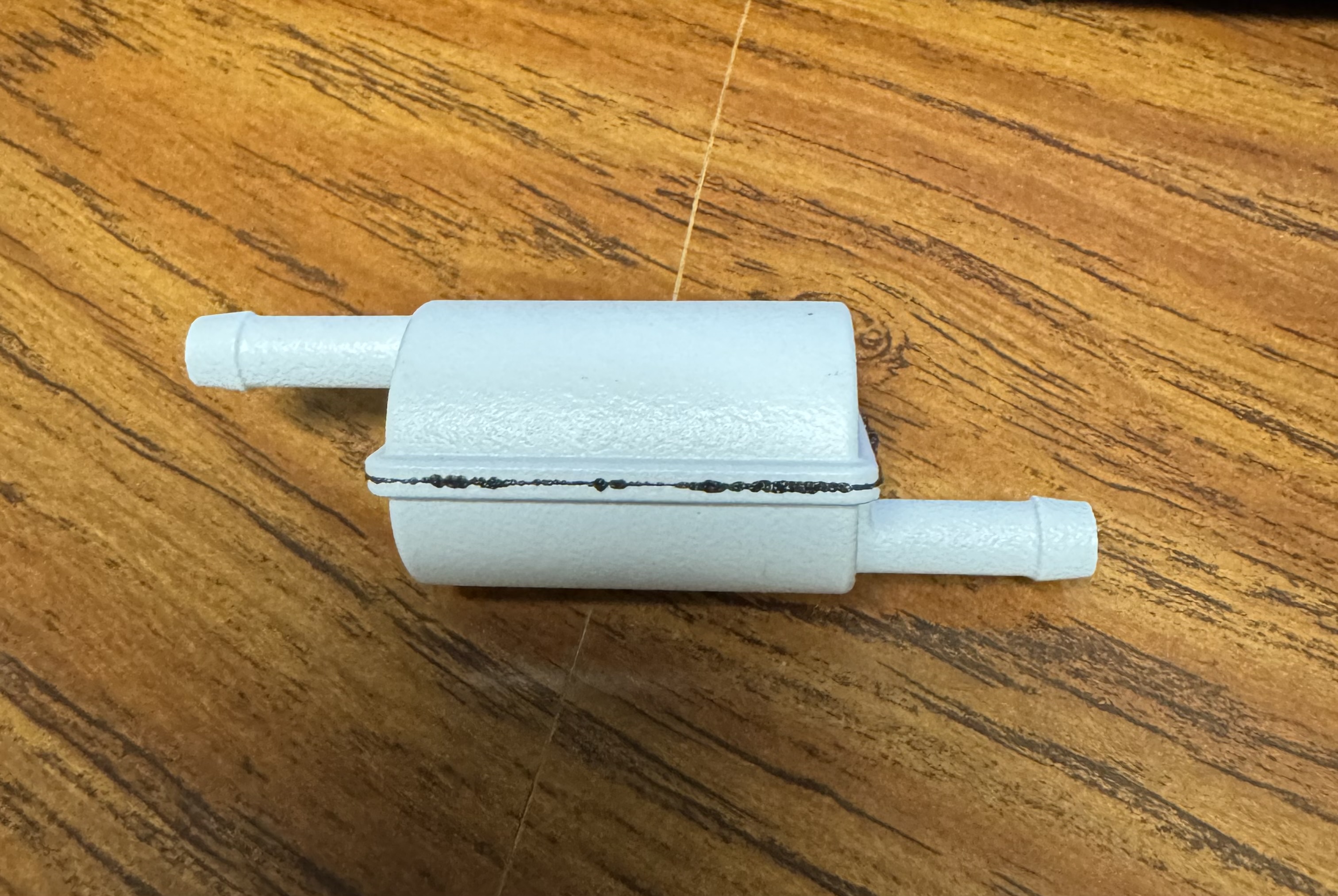

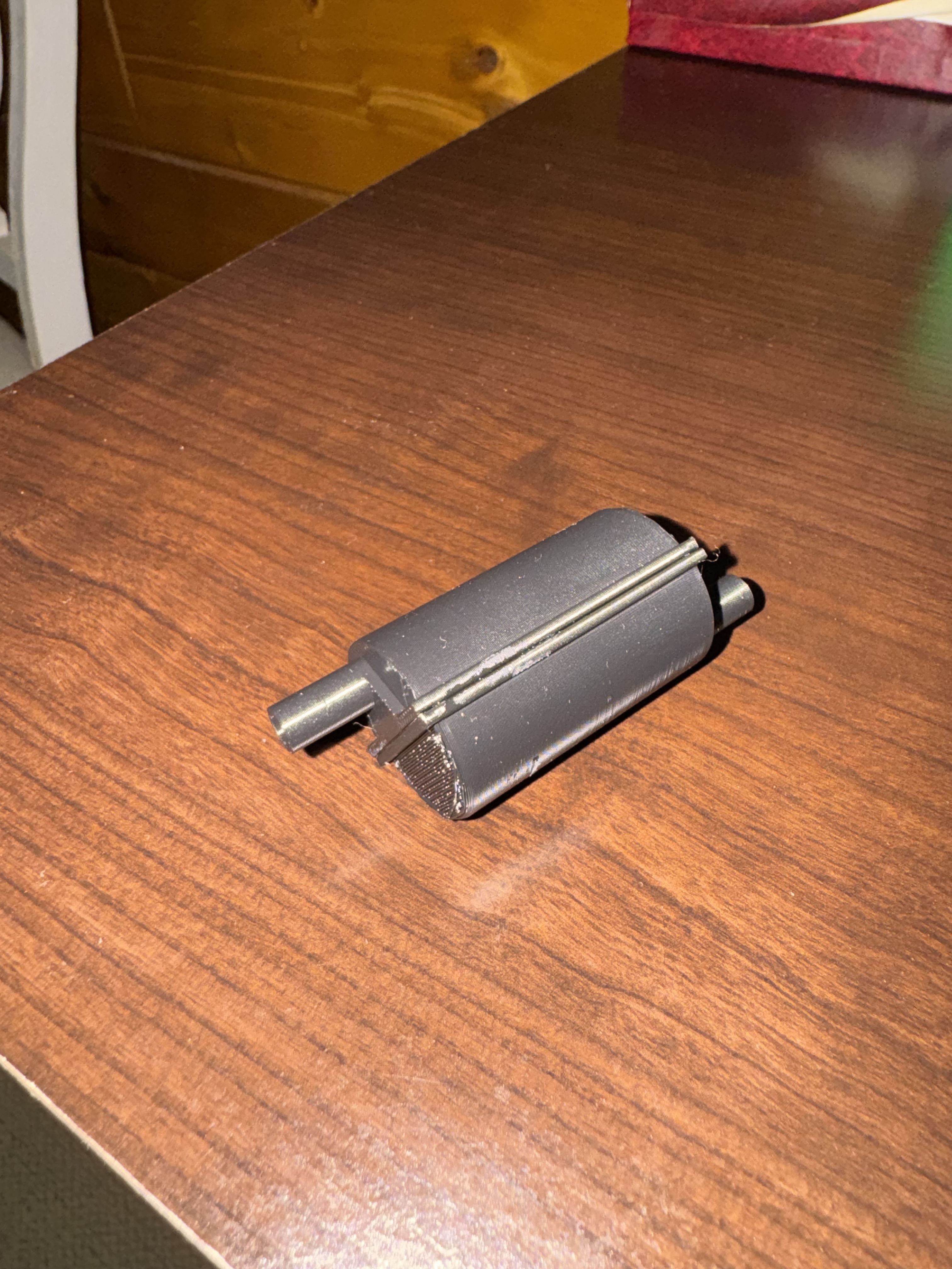

Here is the 3d printed version 1
Here is the final product I will let you know if it holds up.
Super cool!!!
