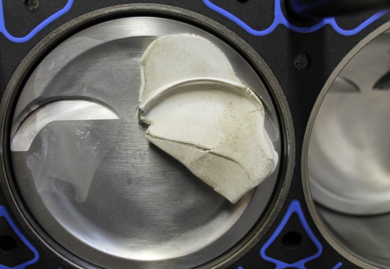

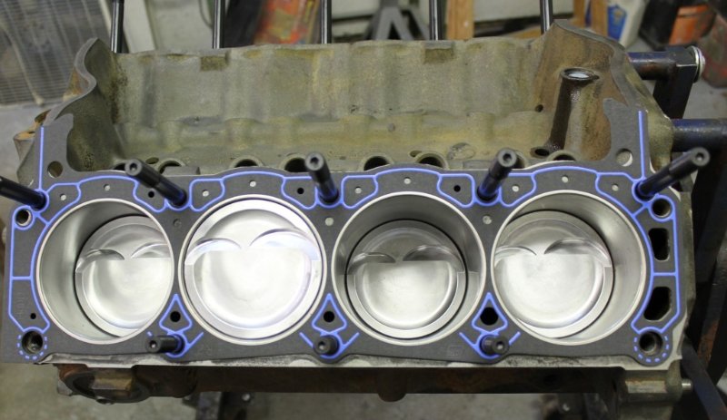

I have dished top with AFR 205 heads with 58cc chamber running 10.5 compression. Cam lift is .688’ exh & .715 Int
How much clearance do you have now? I am running flat tops but my lift is only around 500 on both.
I ended up with .124” I think the minimum you want is .080” to .100” I had enough material to work with on top of the piston to get to that number without any concerns. I cc the piston before & after and then adjusted it with the head gasket thickness.
