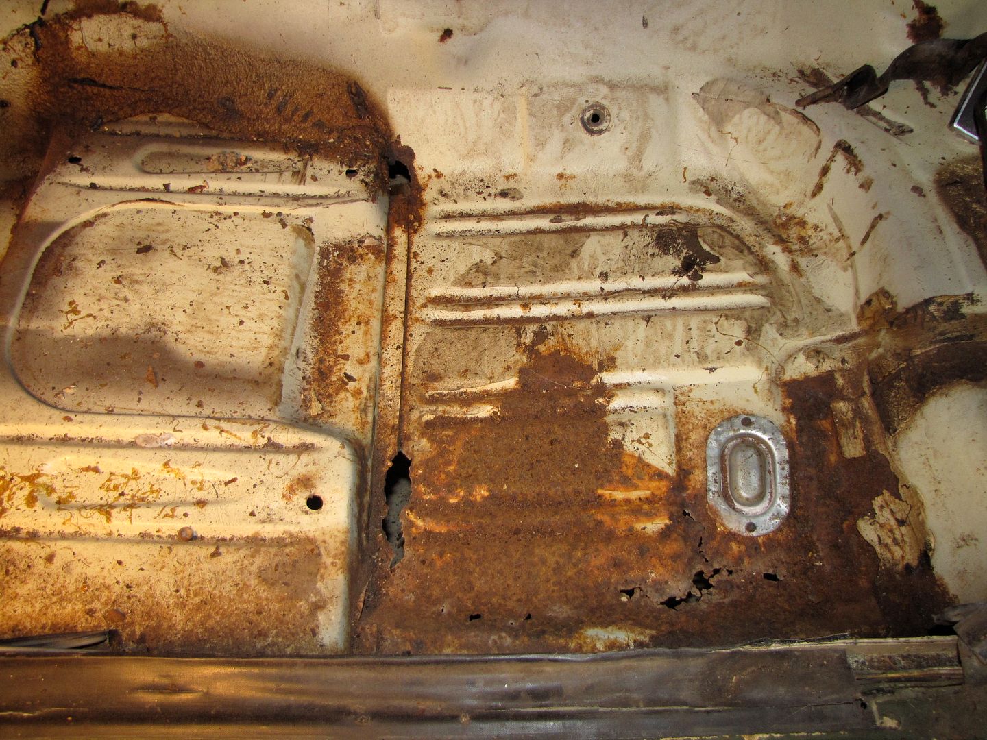

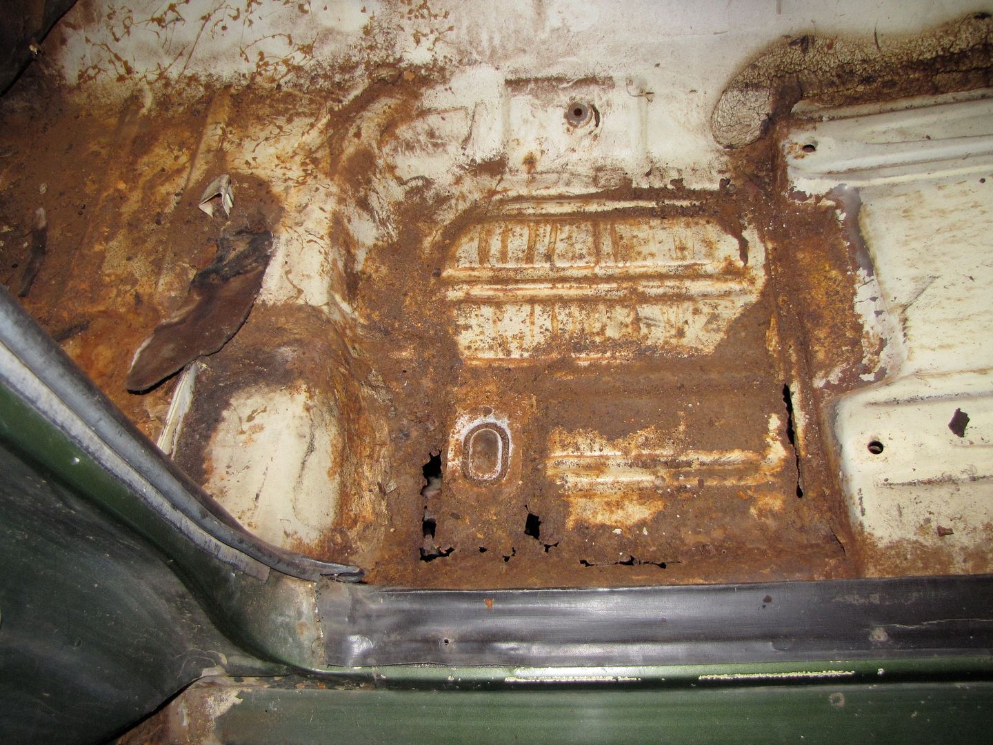

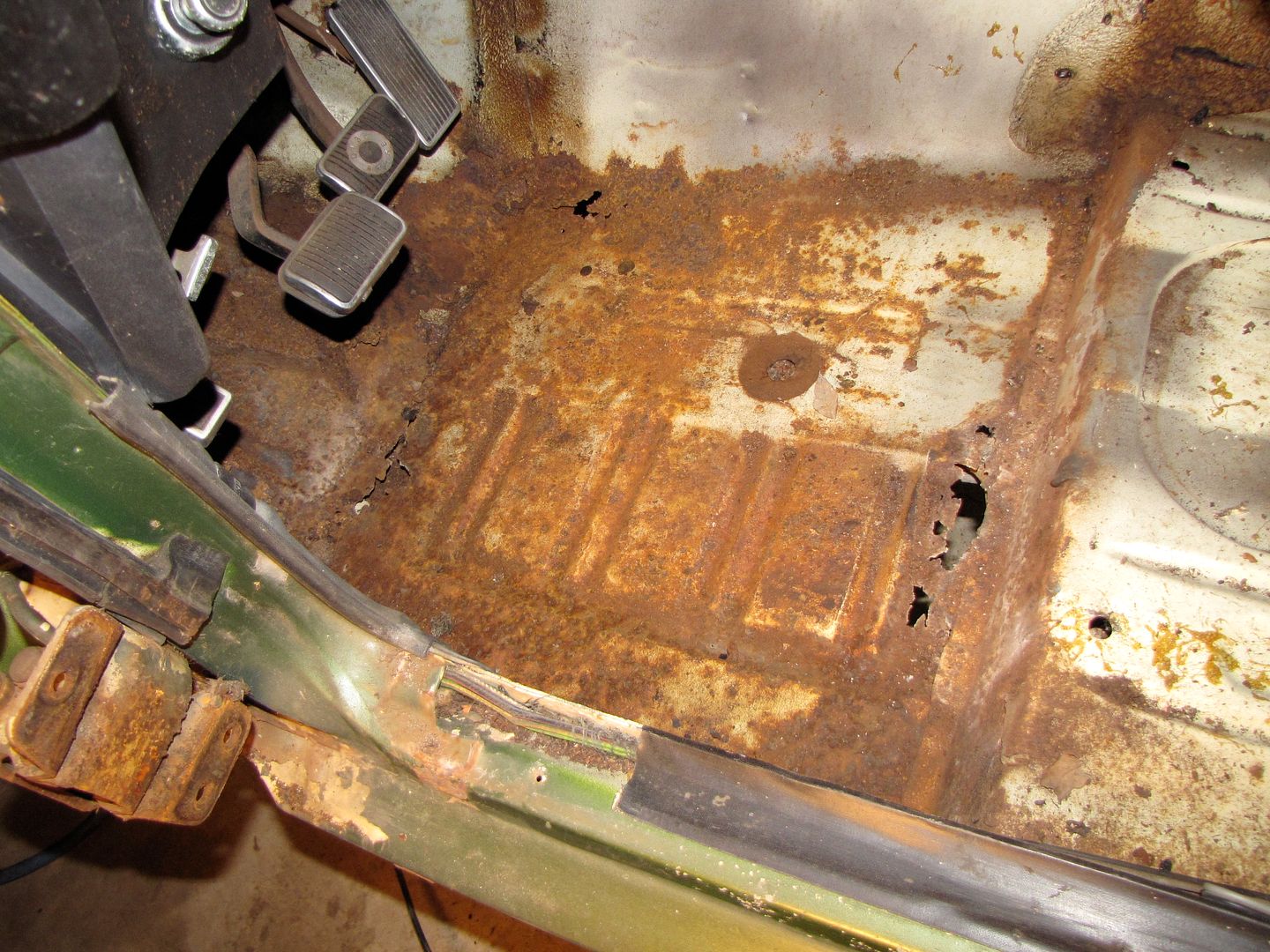

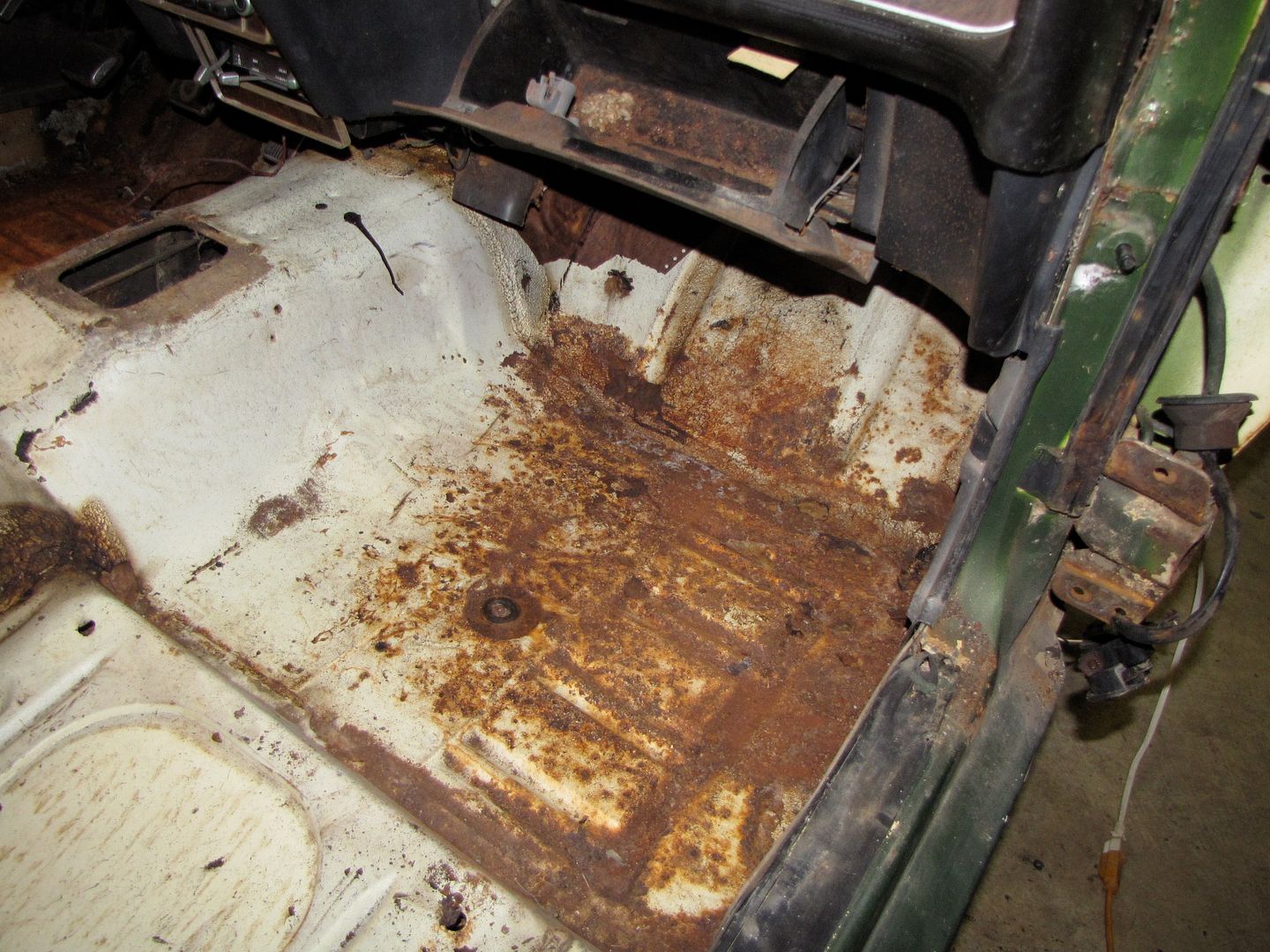

I’m looking at full floor pans from transition panel to firewall panel. There is nothing correct for the 69. So I can:
  1. Find a car with a good floor and swap them. (hard to find one for a decent price, I do need other removeable sheet metal parts too so this is a viable option)
  2. Use the 67/68 full pan and modify it. (besides the hole in the front floorboard is there any other differences with this panel; like the length)
  3. Patch it. (don’t care to go this route, too much work and I want to build this car right)
I have some rot below the seatbelt holes at the rear seats and plan to patch that. And my drivers toe board is toast.
Can anyone help guide me in the right direction? Having some trouble making this decision, if they made a correct 69/70 pan thats what I would do.
Thanks,
Chris
Here’s a few pics of those floors, notice the build sheet on the front passenger toeboard too, fyi.
The method I always went by, was to keep as much original sheetmetal as possible. From the looks of the pictures, you have a couple areas that are too large to patch and if you did the metal looks to be rusted to a point where it’s getting flimsy. I heard where the Cougar pans are longer, somewhere, than the Mustang but I haven’t yet got into that on my Cougar yet. Could you look at the Mustang pan and possibly put the parts in you need and just the area where they’re needed? The stampings look pretty close to what you have. Sorry, but at this point my expertice is more in the 65-66-67 Mustang range.
I’m pretty sure the difference in length is in the trunk pan area. I also think the 67/68 full paneI differences are the ribbing at the rear seat area and the large plug holes in the front floor area. I’ve decided to remove the bad areas to see exactly what the patches would look like and in the mean time keep looking for another good parts car. The one I have had B quarters that I have already removed but the floors were no good. I also like to keep as much original metal as possible as you stated. My hood, trunk and doors were toast on this car so that’s pretty much out the window now. But the body is in pretty good shape though considering all.

So I went ahead and took the floors out yesterday. I did not find any major surprises under the floor. Everything looks pretty good. Torque boxes are another story. Rears are good, will have to replace the front passenger side and at least replace the top angled piece of the driver side.
My experience on this job was to replace generously. Everything towards the firewall on your car is trashed, and you might not find good metal that you can weld to.
Also check your cowl, heater core, and the side air vents for the source of all of the water that most likely caused the rust. The problems on my 'vert were the front cowl under the fender that was rusted out and leaking down into the vent, and most likely a leaky roof.
The upper and lower cowl panels are good along with wind shield channel. Side panels are good, have one little bad area that is easy to see and get to. I cut out the areas of the toe boards this morning. All my structural flanges are in really good shape too.
